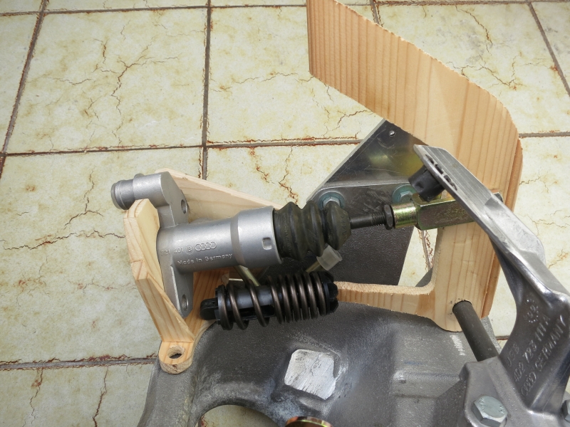

Mini update. I have almost finalised a design for the master cylinder mounting bracket. This is a simple wooden mock up just to make sure the cad drawings fit in reality. The design is to be bolted and welded, I wanted the extra security of bolts in the unlikely chance the weld cracks during operation.
Once I'm happy all this works I will post up a pdf of the cad design so anyone can machine it if they want to.
Any criticism/advice/suggestions welcome.
Goran,
You'll be a legend! RHD Manual 8s. Bring it on.

  #97
Old 11th April 2013, 10:32 PM
Thanks Mike!
I hope it works.
It deserves to Goran with all the research and hard work you have put into it so far!

here's that picture I took of your test fit at A8 Parts
  #100
Old 4th May 2013, 09:06 PM
Thanks Neil. I wish I took some pictures with the mock-up fitted.

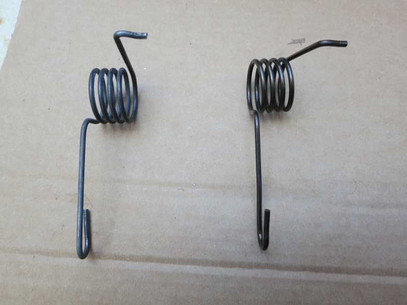

The custom brake pedal springs arrived, and they are almost completely wrong.
I dont know why those numpties couldnt understand "mirror image"?
I even taped the original spring to a piece of card and wrote on it "MIRROR" to represent the mirror plane.
Anyway they think they did their job and are unwilling to do it again correctly, and I'm unwilling to pay them again.
old spring on the left, new spring on the right.
