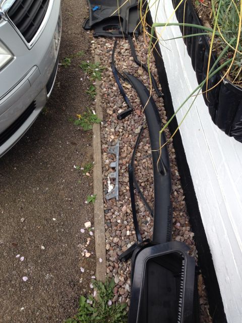

Swapped the linkage over today, it was more complicated than it appeared. Summary of needed steps.
1. Remove wiper arms
2. Remove covers in engine bay
3. Remove pollen filter cover and filter
3. Remove 2 bolts holding the lower screen trim in place and remove the trim.
4. Remove 4 bolts from the strut brace at the centre of the screen.
5. Remove 4 Allen bolts holding the bracket to the body.
6. Remove all remaining strut brace Allen bolts.
7. Remove 3 bolts securing the linkage
8. Remove strut brace bracket by gently working it out.
9. Remove the linkage being careful not to damage the screen, it's difficult and you may have to move the mechanism to the other end of travel.
10. Disconnect wiring
11. Reverse process to refit but there is no need to plugin the wiring till the end.
Took about 3 hours, will add a few pictures later.

A few pictures from the change process.
