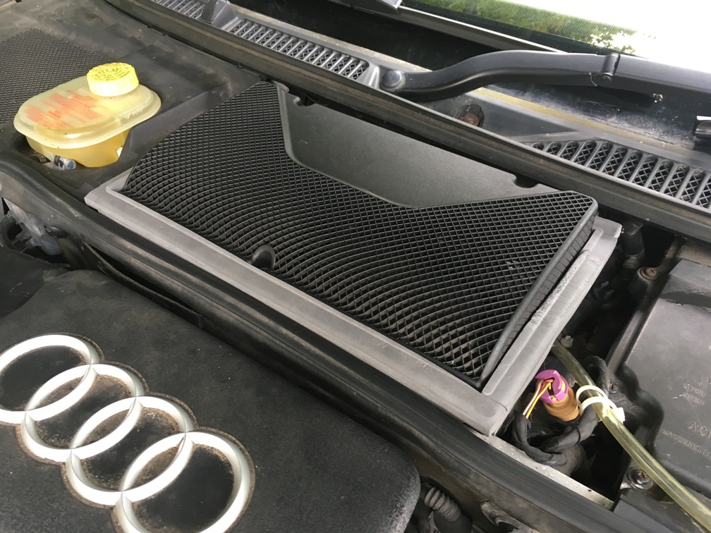

New seal with extra layers!
(The transparent pipe is my pre-installed tube for draining the scuttle )
The sharp-eyed among you may notice that the trim around the wipers is misaligned; I only noticed this recently after having that car for 4 years!
A job for another day, it needs to come off and be refitted properly; I understand there's a tongue that should go into a slot but probably hasn't raising the whole thing be a few mm in the centre.
That also allows more/larger crud from the windscreen to flow down into the scuttle area, adding to the blocked drains issue.

Now I've also fixed the scuttle panel seal to the windscreen I think these two items together have been a major contributor to my blocked drain woes.
The way I see it now is:
1. Debris washed down windscreen, bypasses trim with smallish mesh at base as it's very badly fitted. Large (and small) bits end up in scuttle eventually blocking those drains.
2. Degraded foam seal around HVAC intake allows air (and debris) to be drawn in directly from the scuttle area, bypassing the normal route through the pollen filter. Result is lighter/smaller bits, such as those damned birch seeds, gets into the HVAC system eventually blocking the aircon drains.
The new seal I've put around the HVAC intake, as the photo shows, is quite deep now at the front edge and a good tight fit. As is the trim at the base of the windscreen. Combining all that with regular use of car/windscreen covers and I'm optimistic of fewer "sloshing" incidents in future.
A good test is how many seeds come blasting out of the vents in the car in future.
