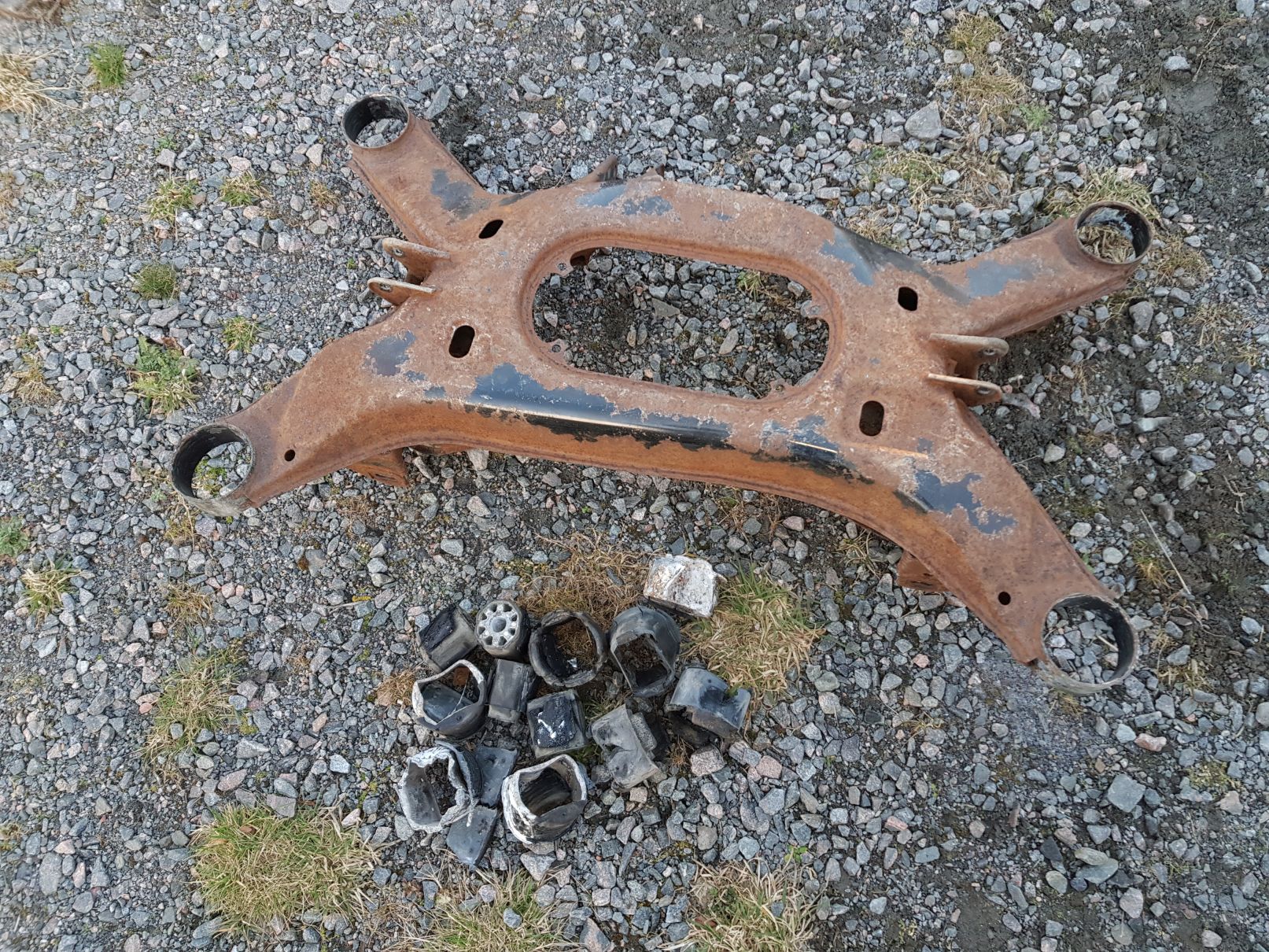

Didn’t get much time on the car this weekend, but did get the subframe bushes out, and the new poly bush ones have already arrived – quick delivery (from Poland I thick), as I only ordered them last Wednesday!

Now that the subframe bushes are out, I have the option of powder coating. Is this generally considered better than just paining? I have a quote for £150 cash for blasting and powder coating, and might get them to do a few other wee bits too if I go-ahead with it.

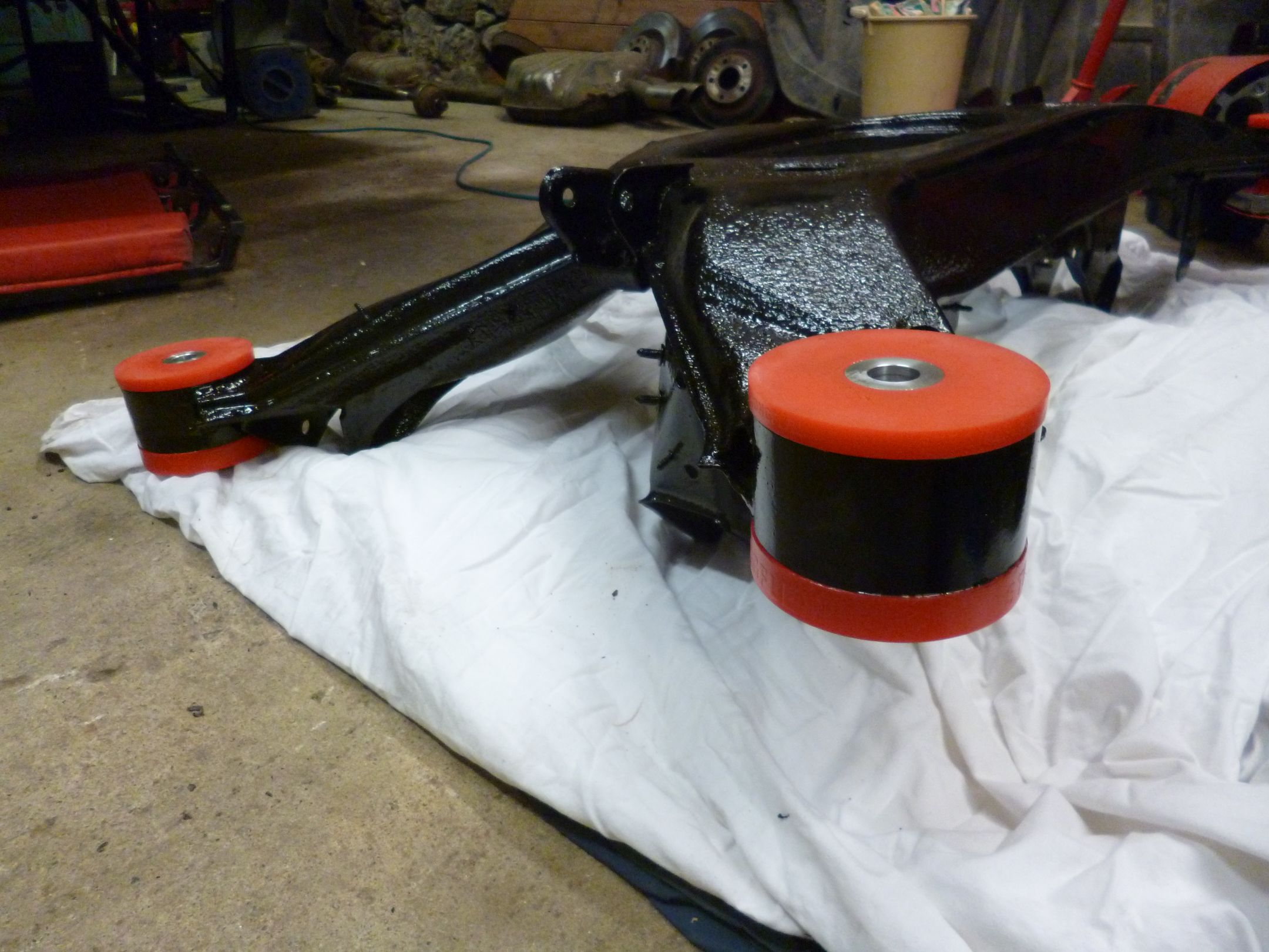

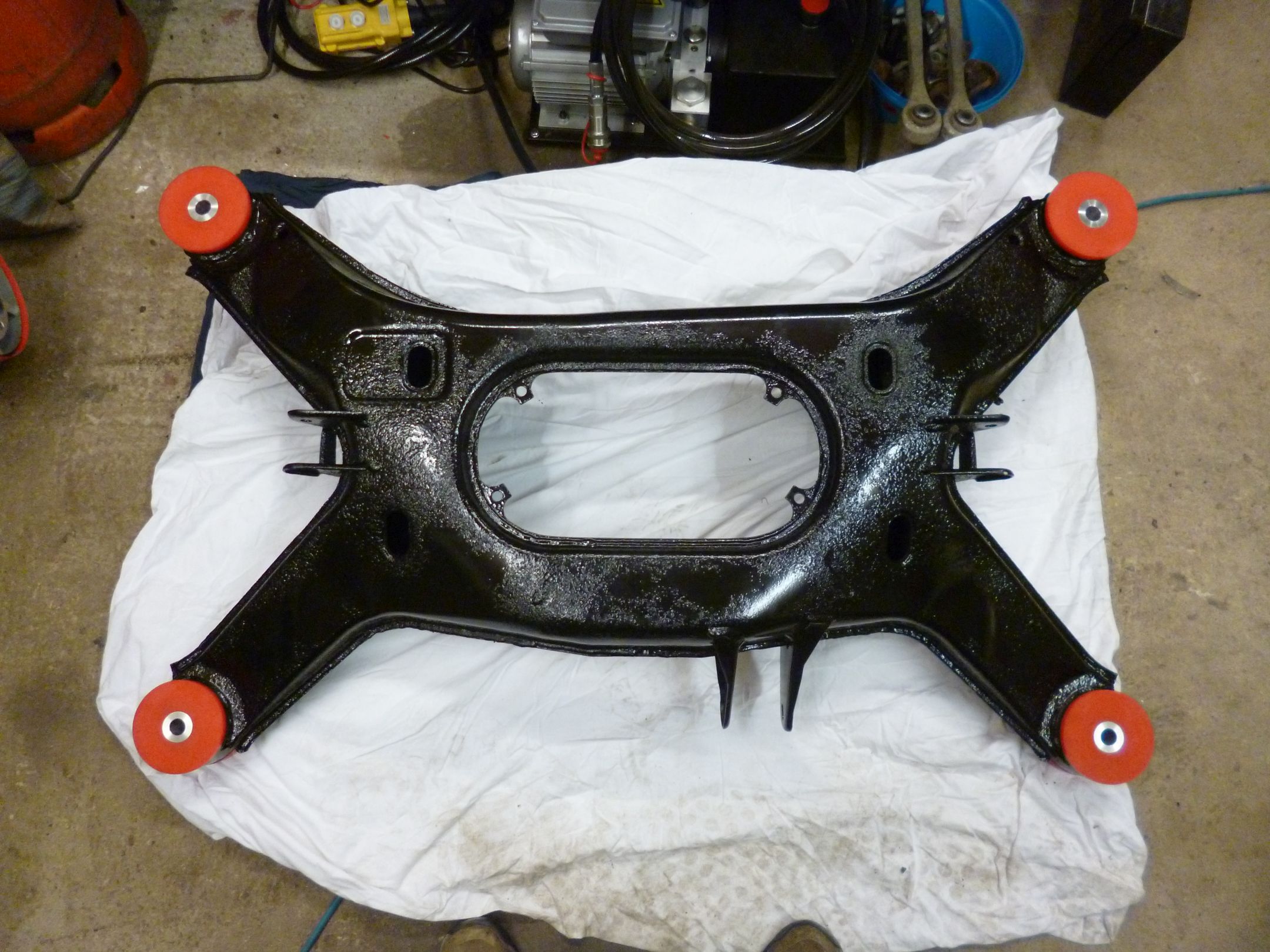

Things are moving slowly but surely. I have got the subframe back and it is looking great – it has a really good finish. I have popped the poly subframe bushes in and they fit very well 😊
Click image for larger version

I also replaced all the bushes in the arms and hub carrier over the weekend. They all went in perfectly except one of the upper control arm bushes, which collapsed ☹. A different bush went in the hole no bother, so not sure what went wrong. I have ordered another and fortunately they are not too expensive…
Reassembly beckons, but while I wait for some final bits and dwell on what to do with the shocks (I am leaning towards getting the Bilstein B6 with the standard springs) I am going to take of the front subframe and get it blasted and painted too…
