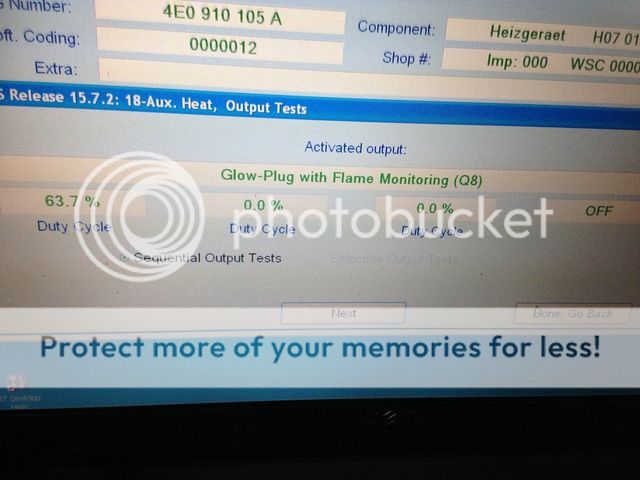

Hello Lee , sure said this before some where search for ' definitive guide to fitting auxillary heater ' its on this site , it goes on about how to code the aux heater so you have the mmi timers and manual start functions .
Had a look on mine the other day in aux heater activations , glow plug run is there , well is on mine anyhow , feed pump run , combustion fan run its all there

OK. So ran all the tests on this module. There were about 5 or 6 tests.. they all seemed to go through OK. The dosing pump test made the clicking noise. I then cleared the fault code and it remained clear (hooray). I started the car (AC and heated seats on, coolant < 70 and ambient outside temp about 2 degrees) and it seemed to fire up OK. Smoke from under the front of the drivers wheel. No more fault code either. The fault seems to have cleared itself. Must have been due to an extended period of inactivity I think.
