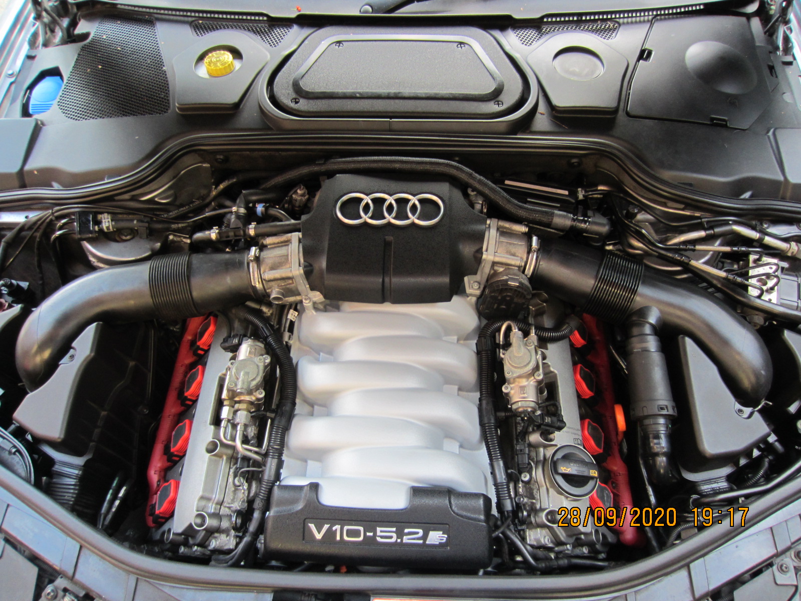

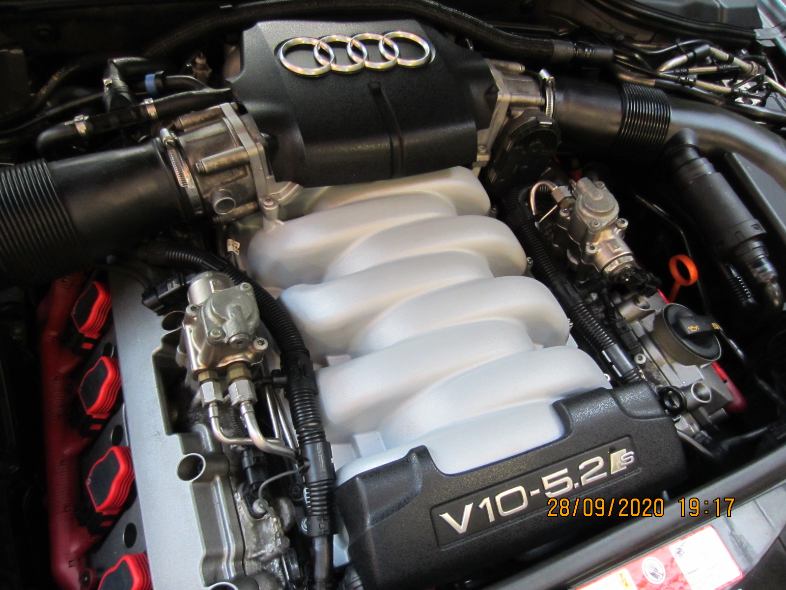

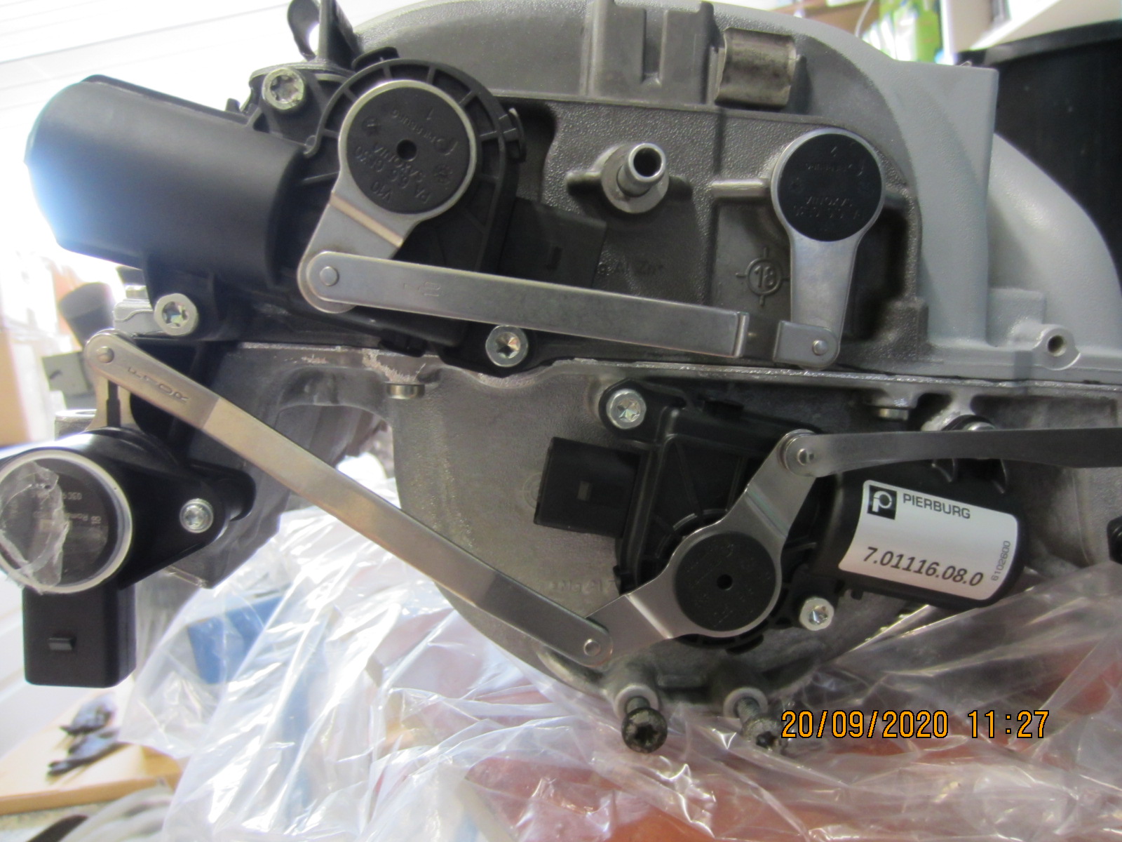

An old post I am resurrecting here. But a common issue on the S8 nonetheless. Collapsed swirls flaps that is. Rather than take the flaps out of the intake and risk losing some drivability (or having to remap to compensate for taking them out), I went for what I saw as a quicker and easier solution that I can do myself. That being take out the old and put new in its place.

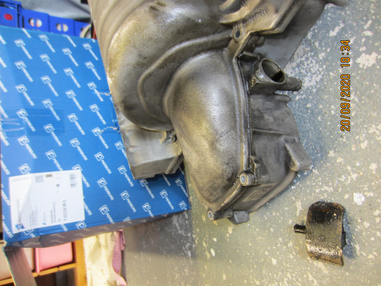

Symptoms being a rough idle, a mis fire code on cylinder one and eventually engine management light on. All this within 48hrs before I took it off the road. It did also then finally register a code with the swirl flaps which confirmed what the problem was. I did not fancy driving it anywhere like this. So with some guidance from here and elsewhere I took the job on myself. I did find a piece of swirl flap in cylinder one! Hence the mis fire. And bits of plastic flaps loose in the intake. I think back, I was getting an irregular intake noise under part throttle load about 2 weeks prior.

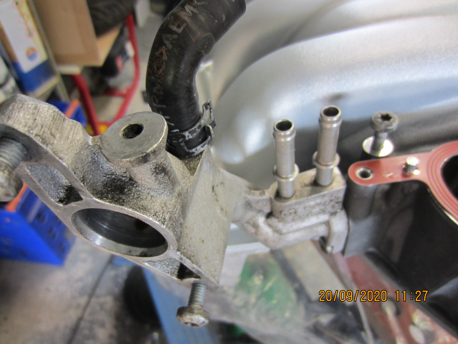

I suspect Pierburg make this part of VAG. Since the original had exactly the same Pierburg part number on it (7.01116.08.0). I sourced the new intake from Germany on eBay for £1180 delivered. The new part comes with a new throttle body gasket but you have to swap out the alloy piece on the top that takes the two water coolant pipes. So remember to do that before disposing of the old part.

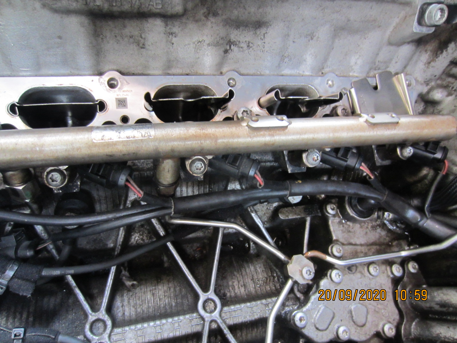

Whilst in there. It made sense to do a manual carbon clean. Albeit walnut blasted less than 25k miles ago. I did sheer a bolt by overtightening the throttle body but it came out easily and I got a replacement from our sponsors easily. Not an easy, quick or cheap DIY job but a lot cheaper to do yourself. It's done now at least..
