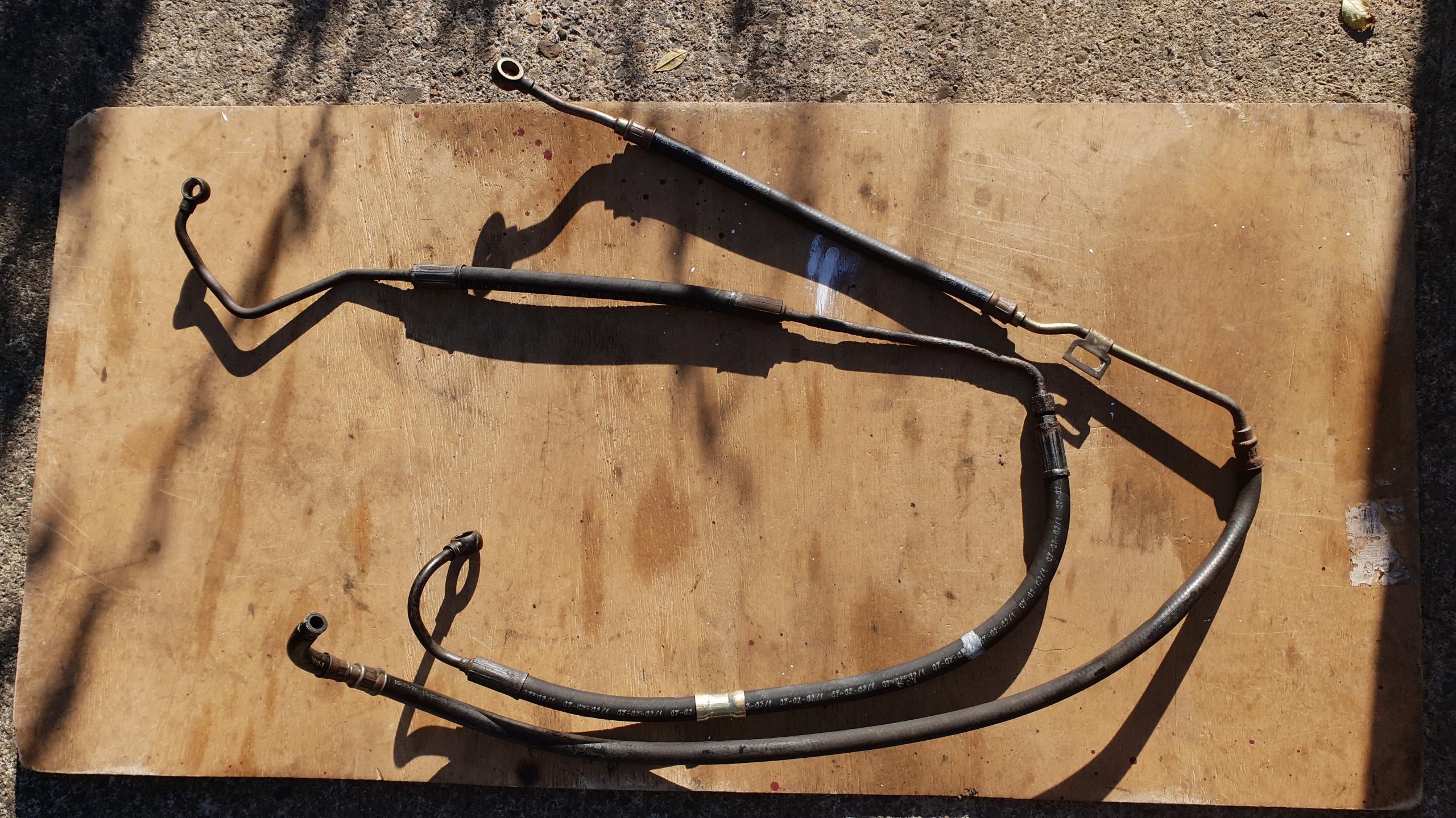

I received the pipes from A8parts yesterday. first off can someone take a look to check if they look right. I'm sure they will be but I was expecting a pipe with a curly pig tail on one end. Is that a different, probably NLA pipe?
Attachment 20367

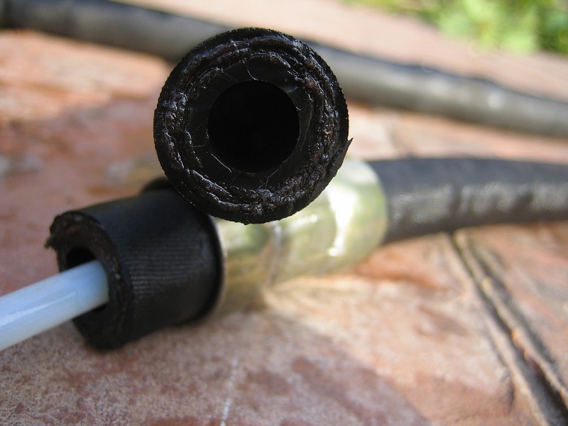

On a second point. Do the pictures bellow accurately represent what it is that is inside one of the hoses that makes it so difficult to replicate,
[ATTACH]Attachment 20369[/ATTACH]
On inspection of the hoses I have it looks like one of the hoses is actually quite un-remarkable in that it is simple hydraulic hoes. The solid pipework looks like the most complex part of this but should be achievable if we can find a good hose company.
The second hose seems to be, again, un-remarkable for half of it's length. Simple hydraulic hose with a solid pipe section at either end. Ok, the solid pipe is quite lengthy and has a few bends in it but surely not impossible to replicate. The second half of that pipe on the other hand does look quite special. Do you agree, have I over simplified the other 3/4 of the two pipes.
I have sent an email to Conti Tec who it looks like originally manufactured this pipe to see if they can help at all but I won't hold my breath. These big companies are not usually that interested in dealing directly with the end user.
MikkiJayne 2nd November 2018 12:12 PM
Yeah those are proper V8 hoses, and your assessment is spot on. The part with the liner is indeed the first part of the pressure hose and that's really the only difficult bit. The inner nozzle is in the pump end banjo, and there is a support bush holding the liner in place just where that crimp is where you cut it open. The liner stops at the bolted union and then the second half is just 10mm hose.
The return is pretty simple as you've seen - its just a hose with a union on one and and a reducer on the other. That one is pretty simple to recover.
My thoughts with the pressure hose are to cut the outer hydraulic hose off and recover both the liner and the support bush. They can be put in to a new hose but instead of having a bolted union in the corner, just terminate the liner in a standard hose joiner, or maybe a 90 degree to get round the corner. Crimp two bits of hose together at that joiner and then crimp on to the rack-end banjo.

The looped section is only on LHD cars. The PF and FL hoses are exactly the same as your pictures so you might as well take the loose ones to your hydraulics guy.
If they can make a proper replica hoses with the liner etc then I'll take a few sets.
This is the S6 pipe overlaid on the S8 one. Its about 3" shorter where it runs parallel with the rack as the S6 hose runs inside the engine bay instead of through the wheel arch. It rusts just as badly though. Interestingly, this has a solid pipe section in the pressure hose in about the same place as the support bush in the S8 one so it may be that the liner only goes about 30cm in the S6 version. Same pump though so hopefully it should work.
