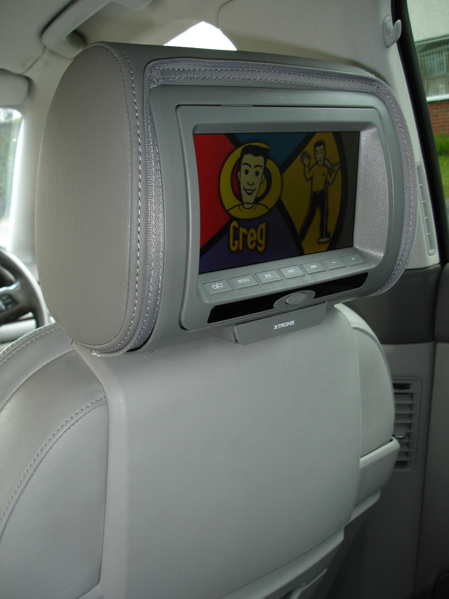

This is the before, headrests in grey, my interior is platinum grey, as far as im concerned very noticable difference, the camera isnt showing the difference to well the first shot looks nearer than it is and the 2nd a bit too much the other way
Attachment 3297
Attachment 3298
After a bit of light grey dye, they look much better (they are within a centimetre of being the same width as the audi originals, but for some reason of camera angles look a bit over sized in these shots)
Attachment 3299
im much happier with them now. they are not as elegant as the oem look headrests that i saw at the a8parts open day, but they are very functionable able to each take their own SD card, USB stick and DVD /VCD variations and on the plus side cost £149 instead of £1200, they also have a zip cover (not yet dyed) to hide them complely
if i didnt leave the car on the street each night i may have opted for the slightly different version for £250, bit more functionality , bigger screen.

no cutting required, comes as shown in the pics. the "leather " surround comes off anyway, as does the screen at the front, if you have a black interior theres really nothing to do,

so do they fit well ? and can you still adjust the electric head rest up and down ?
they fit well, but i dont have elec headrest, i think that you will defo need some 18mm pole to extend the headrest poles down to the bar, im going to do it when i find some poles as well, but you will defo need them or the elec headrest wont work.
and with the FM transmitter i guess that the car radio picks up the signal and is able to play the sound through the bose,
yes it seemed to work ok, i havent used it and i guess when traveling you may need to change channels a few times.as below though if you connect to aux sockets you get better sound through the bose. also i got some IR headphones. or you can connect normal headphones to the headphone jack on the front of the unit
can you use the screens in tandum ?
you can , each headset has a video and audio in and out, so you could connect them together, I have opted to take the outs to the AUX1 and 2 of the tuner, and use the ins for connecting to the tuner out which will give me TV in the back
i quite like the 9" ones too they look tidy http://www.ebay.co.uk/itm/2-x-9-Car-...ht_9083wt_1084
i had a look at the 9" ones, and they are quite a big bigger than the oem hrests, i thought too big, didnt look quite right, these are within a few millimetres of the oem
did you run the power and video cables inside the seat itself ?
yes the cables are already set in the poles so go easily through the chair.
and did you run the wires under the carpet too the boot ?
i havent yet thats the next thing on the list, i bought them over to the console and tucked them in , but they will go under the carpet under the back seat and in to the boot
