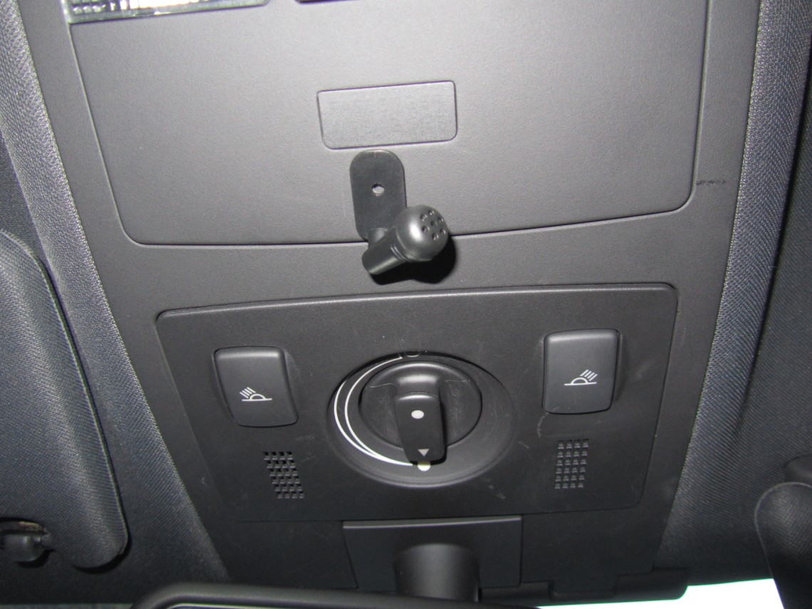

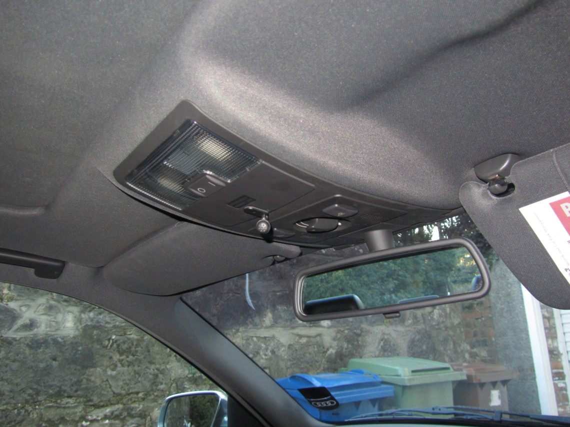

briang9 3rd April 2013 05:52 PM
2 Attachment(s)
Not sure if it helps you or not HP, but just got my tame photographer to take these, sorry about the greasy marks on the plastic:tuttut:
anyhow when I got mine whoever fitted the old BT thinghy appears to have mounted the Mic as shown with double sided tape, and it works fine, did a pretty good job of concealing the wire too, so much so that I cant tell where its routed (and I never noticed before now that its not quite centred properly/OCD Mode off)
http://forum.a8parts.co.uk/attachmen...3&d=1365011507
http://forum.a8parts.co.uk/attachmen...4&d=1365011507
slopes off for the Mr Sheen and a soft cloth:o
ETA just popped back out and the cable just comes out through the join at the edge of the panel to the rear of the mic, but must admit never really noticed it before now. Are the grilles Notorious refers to those in front of the light switces either side of the sun roof control?
HPsauce 3rd April 2013 05:55 PM
Many thanks for that Your Lairdship and Brian, just had mine out and it's exactly the same except no microphone! +++
Odd that the microphone sits on the passenger side though......:Confused:
(though looking at the way everything is installed it could probably be swapped to the other side very easily)
The other panel with the lights in seems rather firmer and I didn't get it out, though I didn't try too hard just in case. :tuttut:
Now I have to figure out how to get a lead up there from the glovebox area.
IT 3rd April 2013 06:24 PM
Mic has always sat Passenger side. Seems to be one of the few cases where something was design for LHD and they just didnt both moving it over for RHD. Never seems to be a problem though.
Behind A pillar is easiest, lots of curtain airbag to work around though to do it properly. A piller trim wont come off unless you remove the grab handle and use needle nose pliers to pull the hidden tab than holds the trim firmly in place.
And watch the alcantara. If you crease it, its never quite the same and it *will* bug you every time you see it... ;)
