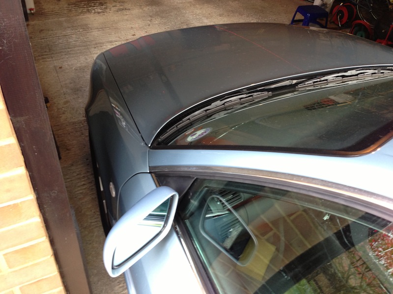

Situation: Double garage with idiotically narrow doors. Who built this? Welcome to the UK !!!
http://forum.a8parts.co.uk/attachmen...1&d=1368985348
5cm tolerance from one side ...
... and 5cm tolerance from another side. Notice red line on bonnet.

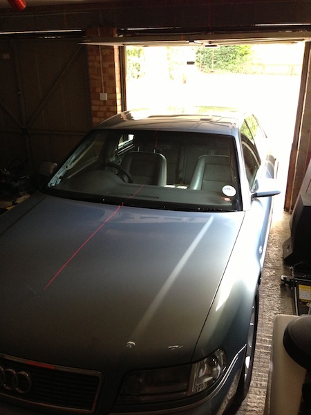

SOLUTION: On approach to garage you can see a red line on the bonnet. Align the line with climate control sun sensor and just press gas. That's it.

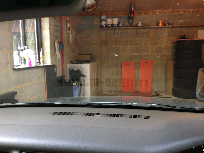

Don't worry about mirrors -- just relax and drive. Make sure sun sensor is always in the middle of the red line. And don't look right or left -- it is scary.

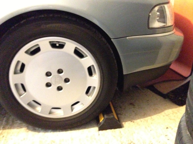

These black/yellow things will make sure you stop at the right place even if you drive fast. No cork on rope !
Stopped. This ensures parking with laser accuracy.

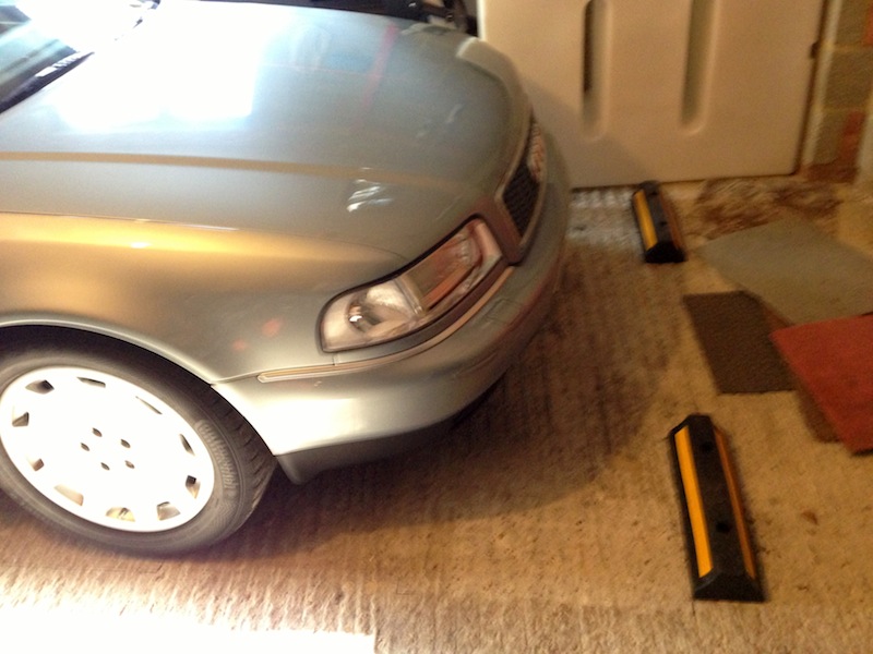

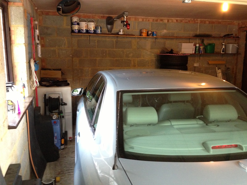

Result: 5cm from front bumper to front wall ...

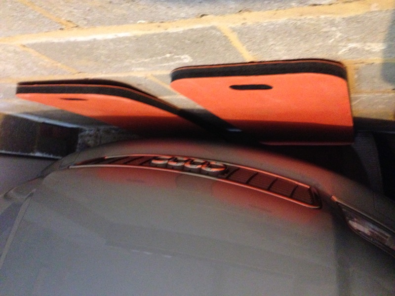

... 5cm from left to water tank ...

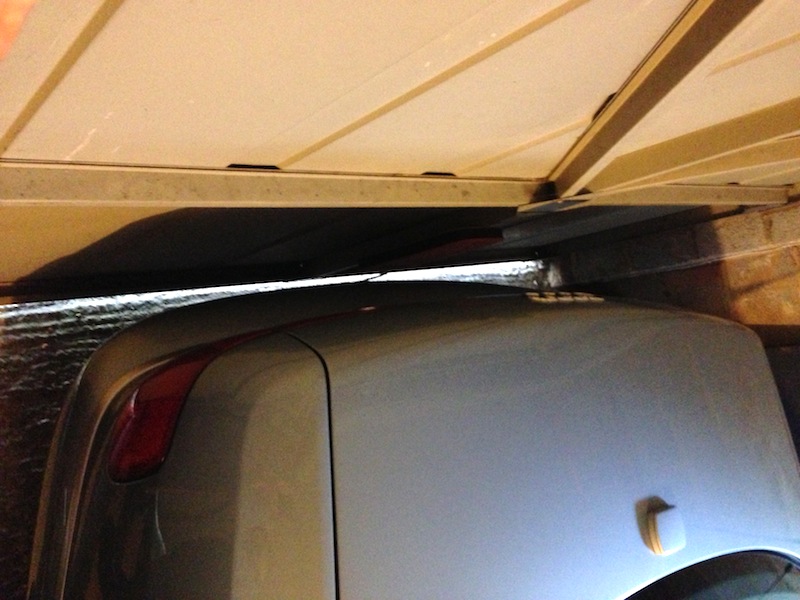

... and 5cm from rear bumper to closed door.
This system guarantees you **always** park exactly on the same spot with 1cm tolerance. Red line is visible even in bright sunny weather and activated via remote control from car.
