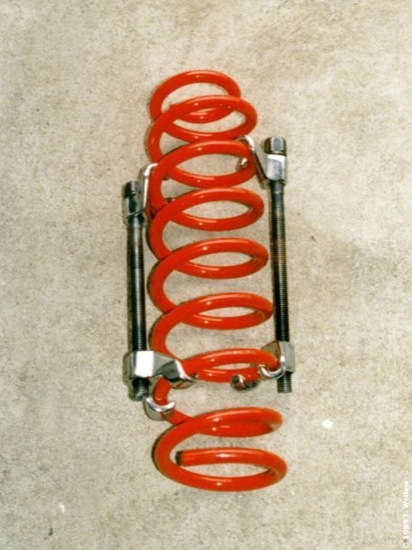

1 Attachment(s)

And spring compressor all i've used is something like this

I´ve done som search and It looks like the stock springs are to long to get out without a compressor. Maybe the FK ones on the car now will drop out tho, they are alot shorter and stiffer than stock.
Seen pictures of people using the type of compressor you mention, but looks like they might foul the bodywork on the inside when they are compressed, The one on ebay looks like it should be able to grip the whole spring for easy removal. I think I might buy it and do a trial run.. if it doesn´t work I can prob resell it for same price :)
