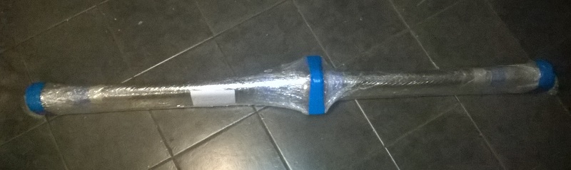

Propshaft going off to be stretched by 122mm +++

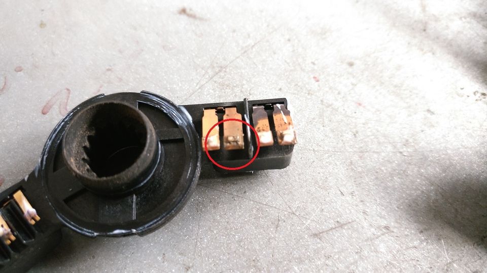

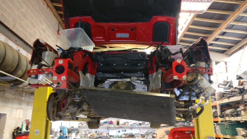

After retrieving BR from storage, I noticed a shudder in from the gearbox in D around the point where the converter clutch should lock up. Whilst studiously ignoring this and driving everywhere in S, reverse then stopped working too. Reverse was just an F125 fault as it could be persuaded to work by holding the gear stick in a particular position between R and P. I have a box full of repaired F125s so I thought I'd spend a couple of hours on Saturday swapping that over, and pretend the shudder was just my imagination.

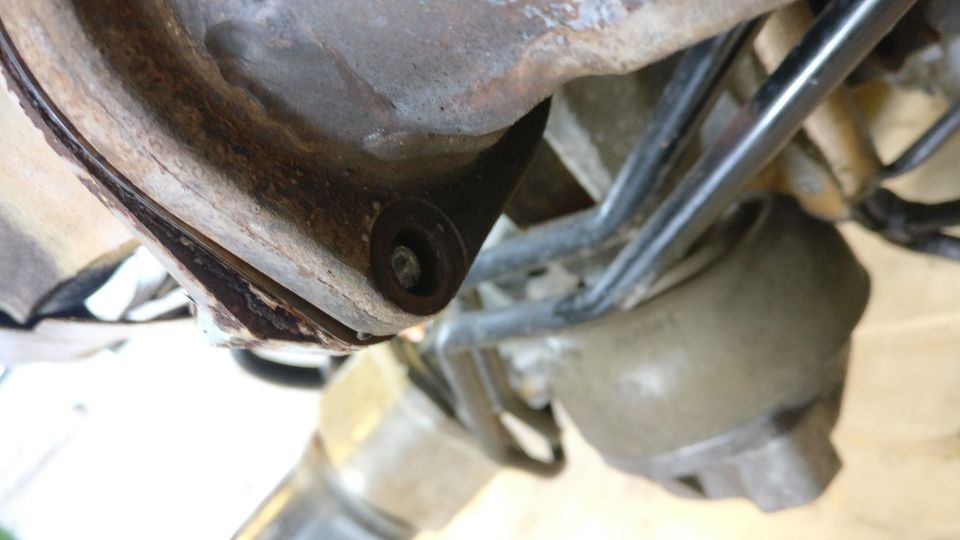

But, as I mentioned waaay back at the beginning of this thread, the V6 is a packaging horror compared to the V8, and on the FL2 2.8, the upper cat is in the way of the gearbox mount which in turn is in the way of the F125, so the downpipe has to come off. It was about this point where everything went very very wrong:
http://forum.a8parts.co.uk/attachmen...1&d=1599168032

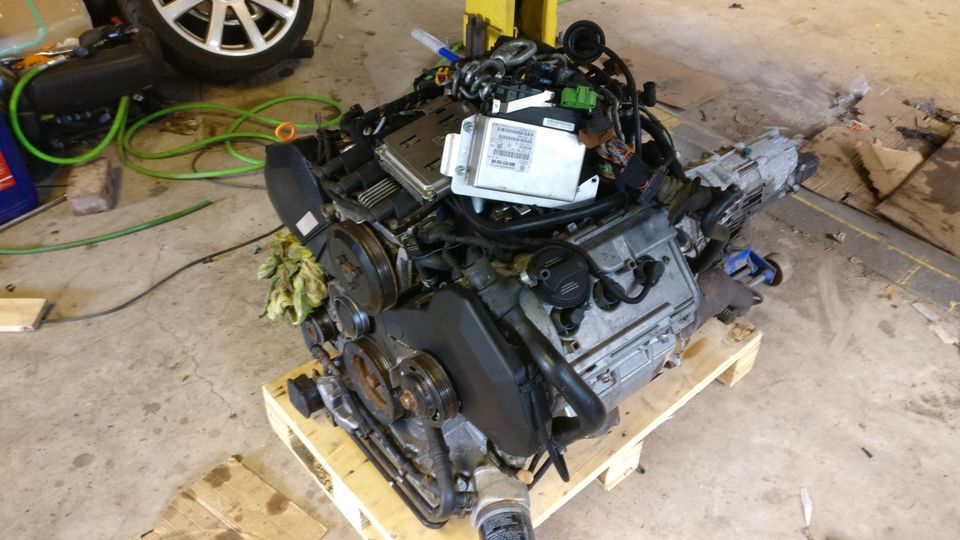

Yes, thats a snapped stud :( There is no way that can be repaired in the car so...
that escalated quickly :mad: At least it wasn't oily this time.

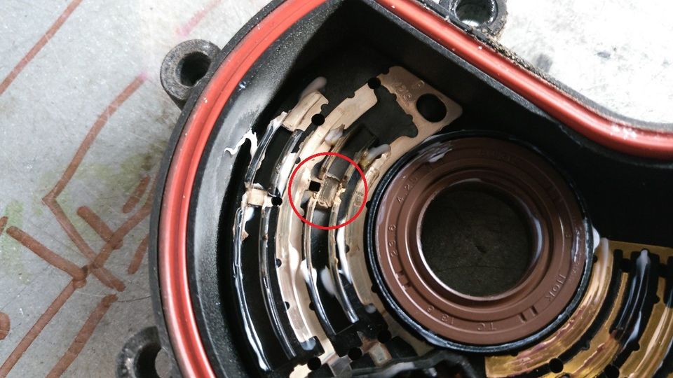

Once the engine was out I was able to safely apply some heat to the other downpipe nuts and they all came off without too much of a fight, and then I could get to the F125:
The usual burnt contacts, but this time only on the reverse terminal for the TCU. This can be cleaned and recovered and put back together, but I'll use a known-good one from stock in this instance because I don't want to be taking it apart again.

HPsauce 3rd September 2020 09:37 PM
My "theory" is that the Reverse circuit is the most vulnerable in that later design F125 because it actually takes all the current for the reversing lights, rather than just an electronic signal as I guess the other circuits do.
And it's actually 2 contacts for the full circuit, but one is a continuous track with no break, so it's almost inevitably the one illustrated that will burn out.
Though there is a corresponding mark on the other track presumably from the current load.
However sods law has determined that it's the P/N circuit (starter relay, very clean on your photo) that's given up on mine......

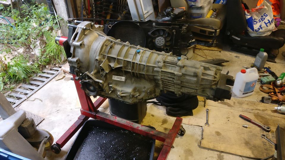

4 Attachment(s)
After a quick call to our sponsors I'm having deja-vu...
http://forum.a8parts.co.uk/attachmen...1&d=1599168657
A 100k mile 5HP19, so only 2/3rds of what the current one has on it. It was a very sensible price too, on the basis that no one (else) is daft enough to go to the trouble of swapping the gearbox in a 2.8 A8 these days :o
I'll service and re-seal this before it goes back in of course. It had never been opened since new.

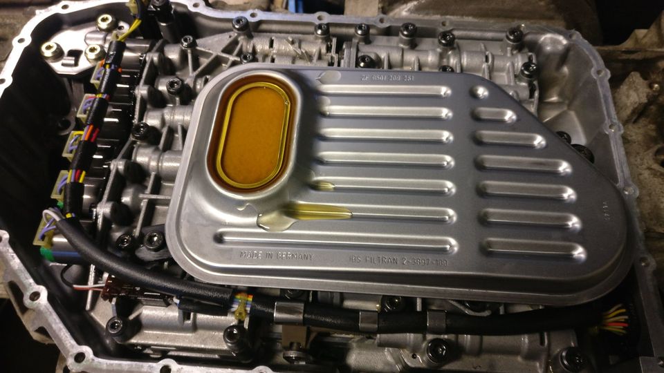

Very clean inside:

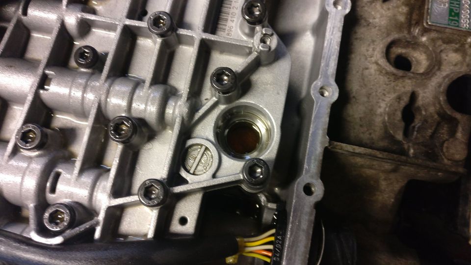

When the filter is removed with the gearbox in the car, the oil drops out of the oil pump pickup. This means that when it is refilled and started up the pump briefly sucks in air before it can pick up any oil. While it is expected behavior given the design of the gearbox, these things are so fragile they need all the help they can get so while its upside down I will prime the oil pickup and the filter with fresh oil.
