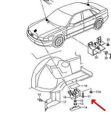

Conan_the_Librarian 4th July 2009 12:35 PM
1 Attachment(s)
That sounds to me as if the main power feed has coroded and no power is being supplied to the starter motor. The junction where the power supply jumps from the battery cable to the starter motor is where you can see the brown cable in this picture...
http://i25.photobucket.com/albums/c7...n2DSCF1509.jpg
Here is the schematic for it.
http://forum.a8parts.co.uk/attachmen...1&d=1246710869
If the cable ends have coroded then there will be no power to the starter motor.
Singh 4th July 2009 01:28 PM
Cheers for that Mike, could you let me know if this is the drivers side or passengers side?
IT 4th July 2009 01:42 PM
I concur with Mike, main power feed corroded....
Its on the drivers side.
The cable, being a live earth, is encased in a plastic block. It may be easy to overlook, but keep looking and you'll find it. Theres only one bloody thick power lead under the front end of the chassis i promise you +++
