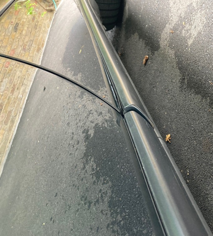

My drivers door lower trim is damaged; while doing some pre-MJ checks I caught my leg on it a few weeks ago! She didn't have time, given the huge load of other jobs, to look at it while it was there.
I found the plastic strip on the inside but it didn't want to slide. :tuttut:
It was quite loose at one end anyway and eventually just unclipped straight off; hopefully not too damaged to clip back on, otherwise it may need some adhesive or double-sided tape at the end of the job.
This is the door trim, not bad but I know it's wrong:

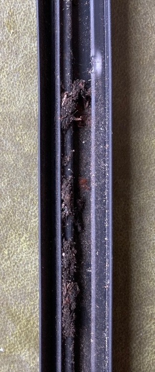

HPsauce 1st July 2022 11:49 AM
1 Attachment(s)
The evidence, there's a handful of places with similar witness marks. :mad:
http://forum.a8parts.co.uk/attachmen...1&d=1656681781
(The others also have smaller marks the other side of the channel as those clips did engage - this didn't hence the muck!)
Hopefully, if it doesn't go back on securely, A8Parts can supply one.
PS The photo is indeed upside down from how it is mounted on the door, but the lighting makes it look weird the other way up.
HPsauce 4th July 2022 10:23 AM
Today I removed the two screws that stop the strip moving, slid it backwards and removed it.
Oddly it looked fine, apart from some tears in the rubber seals, it was straight and true. :Confused:
Then I realised that there are seven fixing clips on the strip and that one was still on the door, the rearmost one!
They just clip into a channel and this had popped out but wouldn't push back on, so the end was sitting proud.
I just slid it off the door and clipped it back in place after carefully reshaping the metal it had been pulled away from.
For now it's just going back on; I'll see if our sponsors have an undamaged one that I can fit in its place in due course. If not I'll have a go at repairing the tears in the rubber.
(I have some compound that I've used fairly effectively on damage to the boot seal on the lower lip.)
HPsauce 4th July 2022 10:47 AM
1 Attachment(s)
Looks good now and was a lot easier to fix than expected. +++
The cover strip on the inside also slid on correctly with a little "persuasion". :tuttut:
http://forum.a8parts.co.uk/attachmen...1&d=1656933478
