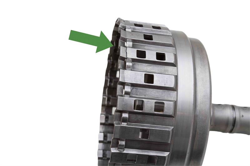

I suspect the code you'll see is 'output speed sensor implausible' or 'incorrect gear ratio', both of which require a rebuild. At this point I feel its pretty unlikely to be the F125 as that will throw a code as you select a gear, not when you try to move. What I think has happened is that it has blown the end off the 'A drum' thusly:
http://www.cascadetransmissionparts....orDrumBAD2.jpg
The bang when it does try to move is the TCU not getting the result it expects (movement) and just going 'f it' and throwing it in 3rd with full line pressure. If it reverses then it has enough fluid to drive the torque converter and clutches etc so I think its unlikely to be a fluid level issue.

I'd echo what IT and MJ have said: both Mark (Moltuae) and I have driven these cars - admittedly not in full limp mode - more than 200 miles each when it was pretty clear that both our respective gearboxes were suffering from the sort of terminal problem that MJ pictorially described so clearly above, so I also think you'll be ok driving it in limp mode for 8 miles.

After having had a nose at the photo MJ posted, it reminded me of my gearbox woes which I've cunningly hidden in the Engine/Under the bonnet section here:
http://forum.a8parts.co.uk/showthread.php?t=7550
Your current situation as described seems to be very similar to mine - my A-drum has some of the top lip destroyed, which was discovered when it went to KSM in Carshalton, Surrey for a rebuild. I was able to select reverse no problem, and it went into limp-home mode aka thump mode upon selecting drive. The thread posted above contains plenty of pics. When my gearbox went 'bang', I drove it for 13 miles back home from Gatwick, and then 3 miles to Carshalton where it was going to be repaired. Auto gearbox man told me to take it steady and not rev it too much - seemed to be quite happy on the way back home. Traffic light starts were of a glacial pace, at best so I used my hazard warning lights to good effect.
