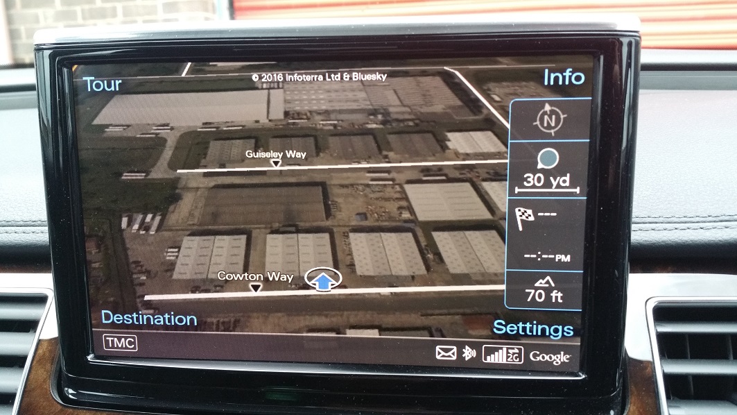

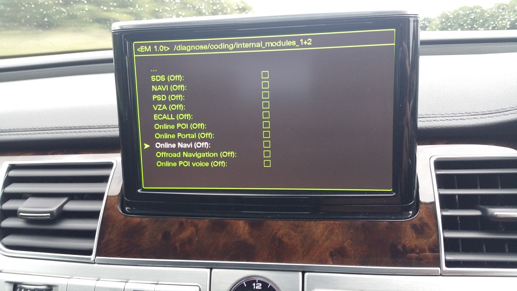

IT 1st July 2016 07:21 AM
Success.....
3 Attachment(s)
As the D4 has been parked on my drive for weeks, thought I'd take it for a run and use some of the fuel sat in it.
Took the time to play with the green menu whilst the adaptive cruise was doing most of the driving... +++
Found this menu option (highlighted) which was on. Set it off, rebooted and it al burst into life.
http://forum.a8parts.co.uk/attachmen...1&d=1467357403
So, all working perfectly now :D
2G is working ok - if you are motorway speeds and zoomed in quite close, it stutters a bit. 3G would definitely help there, as it would when my phone is tethered and decides to do app updates :rolleyes:, but overall it works very well. I wouldn't be bothered enough to need to upgrade to 3G.
Best value for money A8 upgrade I ever did. - £0 ;)

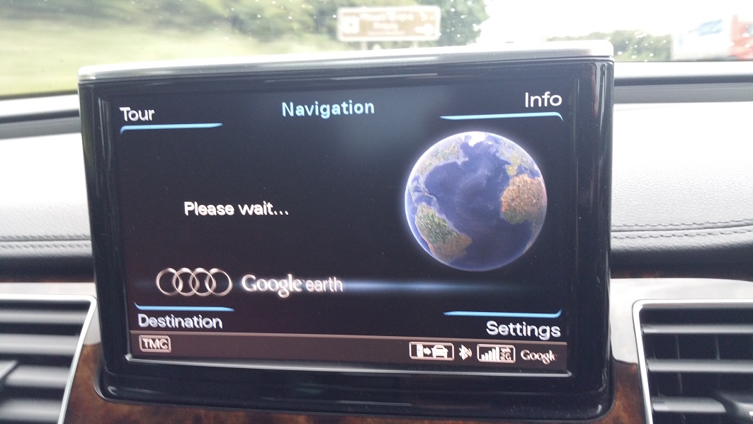

Markr 17th October 2017 07:18 PM
Hi,
I have or should say had Google Earth working in my 2015 D4 from day 1, however this morning it stopped working. Normally nav starts off in 3D mode then flips to Google Earth maps after a minute or two, however got a message saying that Google Earth was restarting and did I want to revert to standard maps or continue with Google Earth. I selected Yes to continue with Google Earth and got a splash screen, as in IT’s post above showing the Google Earth logo and either please wait or restarting. It stayed for the 35 minute drive to work, and had exactly the same experience coming home for an hour’s journey.
Nav is still fully functioning and showing ok in the display between the dials, and if I hit the “back” button, it immediately reverts to the 3D maps.
No settings have changed my side.
Any ideas?
