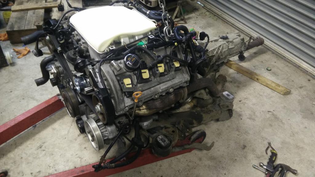

I took the engine off the separating table and put it back on the subframe ready to go back in
http://forum.a8parts.co.uk/attachmen...1&d=1554836696

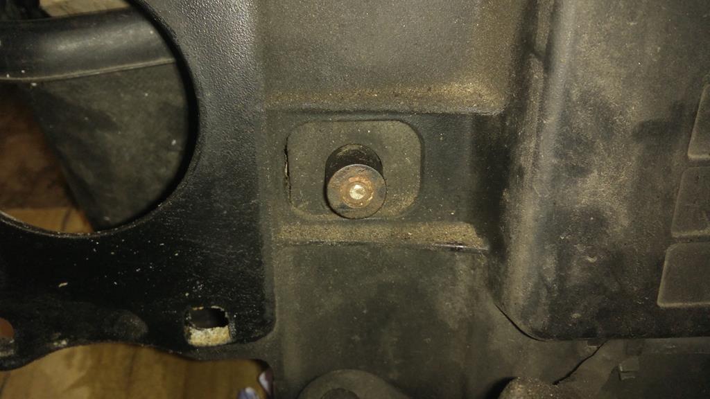

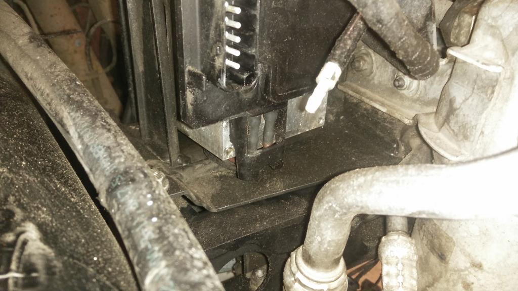

As I have another car under Jim's at the moment I can't get to the engine bay yet, so on to a particularly tricky little job - the broken bolt in the radiator:
This just snapped off like a twig as soon as I put any torque on it :mad: It's properly stuck in there so the only option is to drill it out.

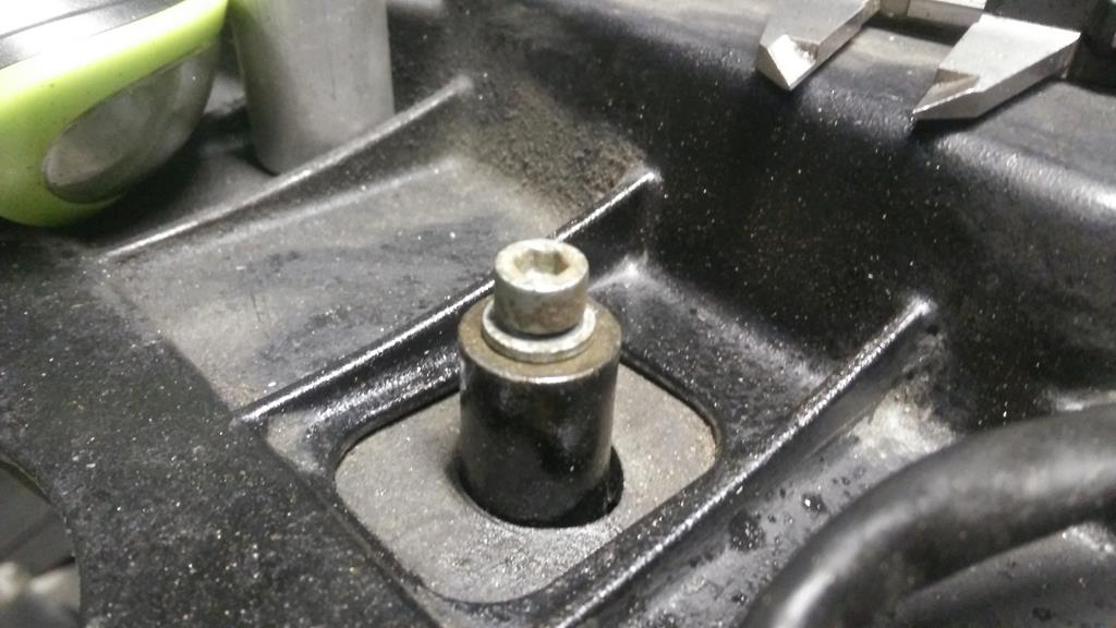

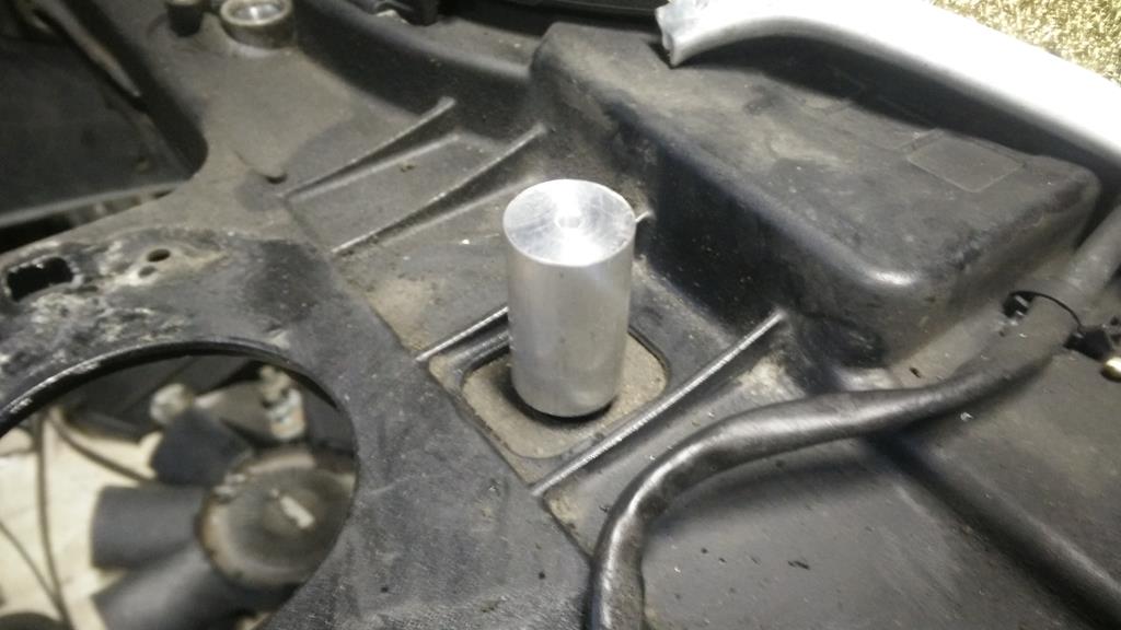

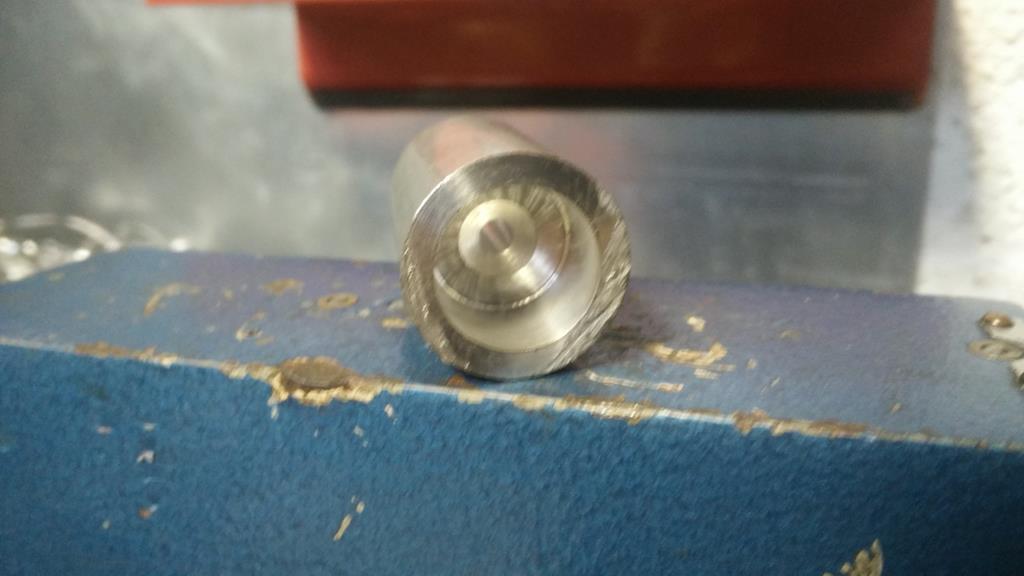

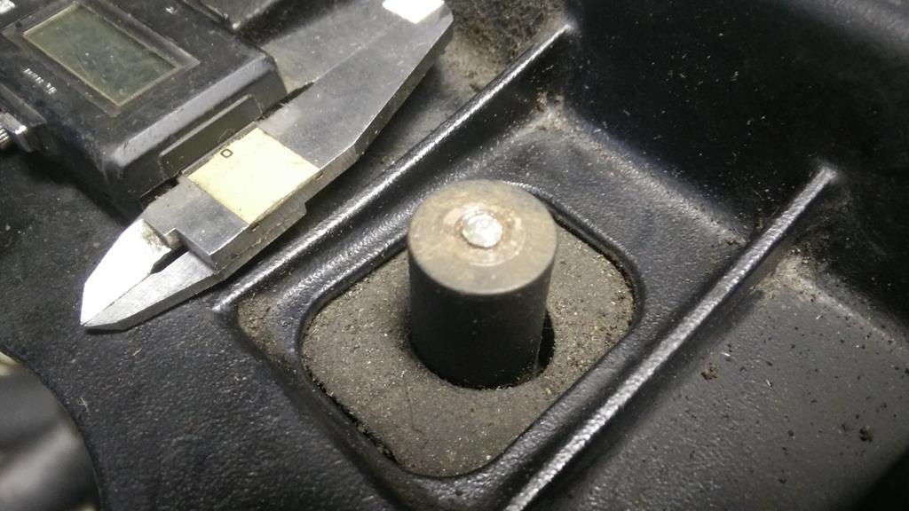

I made a one-use tool to hold the drill straight. This is 18mm ID at this end, with a 4.5mm hole through the middle (as I happen to have a few very sharp 4.5mm drills!)
It is a nice snug fit on to the boss on the radiator

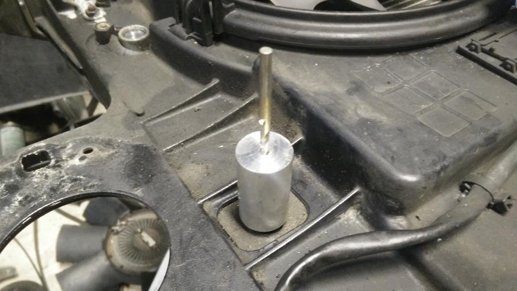

and holds the drill bit centred and straight
Drilled out to 4.5, then I opened up the tool to 5mm and went down with a 5mm drill too so there was only thread left in the hole
I then ran a tap very carefully down the hole, turning only a few degrees at a time to dig the remains of the steel bolt out of the brass insert. I had to be really steady here - it took a lot of torque to dig out the steel, but too much torque would break the radiator so it is a very fine (and nerve-wracking) balance!
It worked though +++
It took about 2 hours start to finish, which is a substantial saving on a new radiator! I got too cold to continue at this point so had to stop.
Yet another reason to read these threads, with ingenious ways of sorting out tricky situations. +++++++++

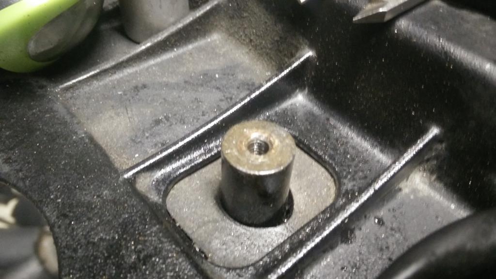

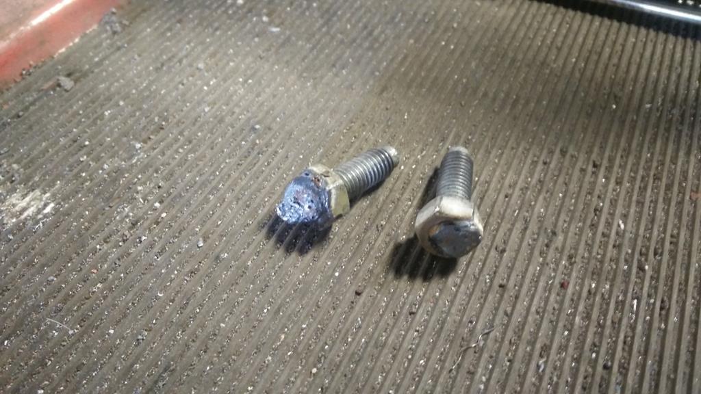

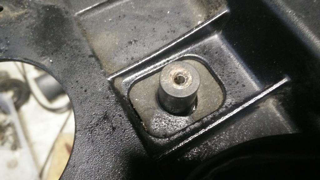

MikkiJayne 10th April 2019 08:28 PM
20 Attachment(s)
Remember these?
http://forum.a8parts.co.uk/attachmen...1&d=1553983807
Put a nut on each one
http://forum.a8parts.co.uk/attachmen...1&d=1554927248

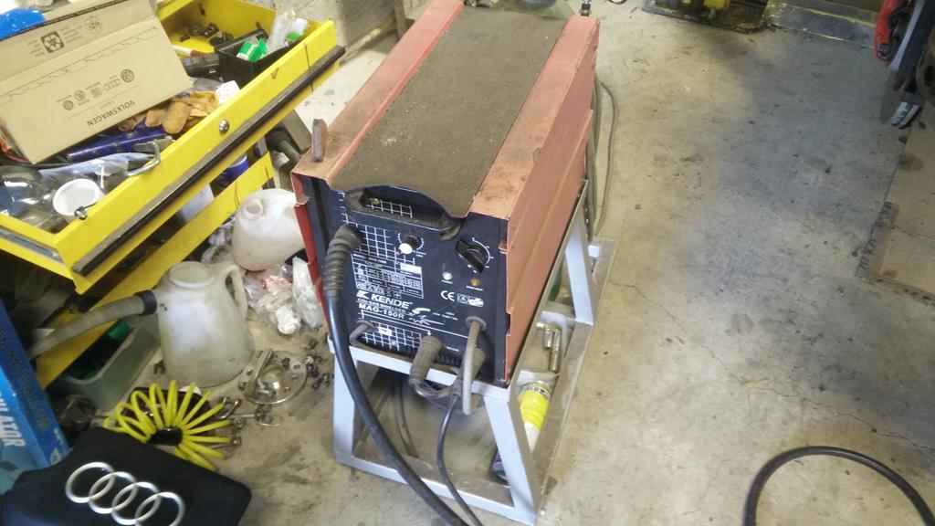

Break out the welder and weld the nuts on to the broken bolts
The heat of the welding breaks them free, along with a good squirt of WD40 as they cool down, and they unscrewed without a fight

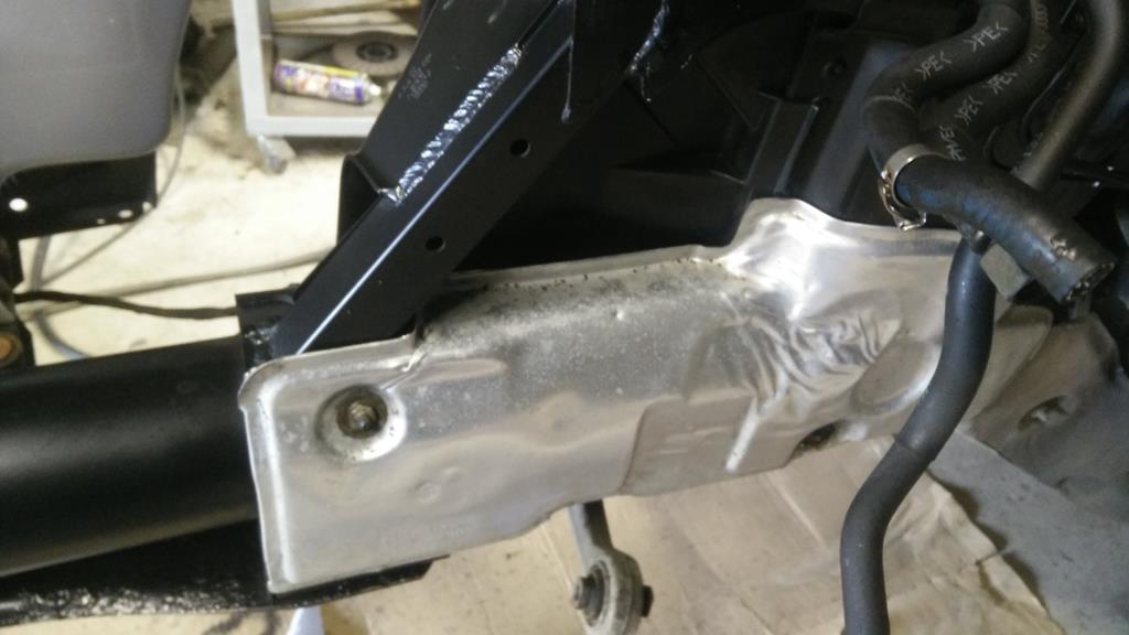

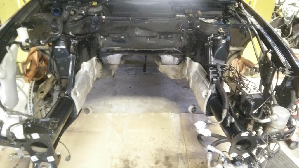

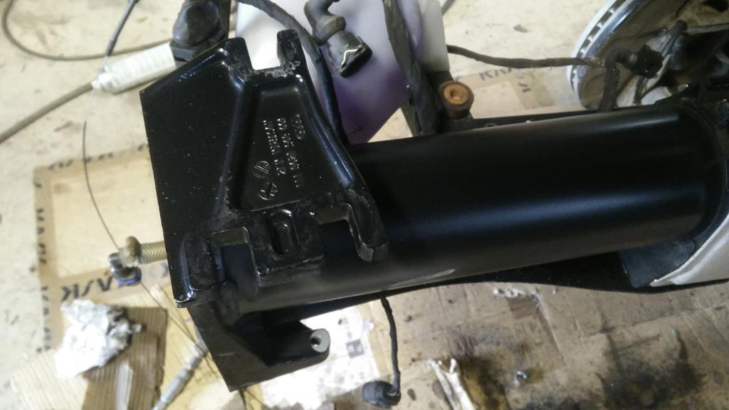

Time to clean the engine bay
That's better :)

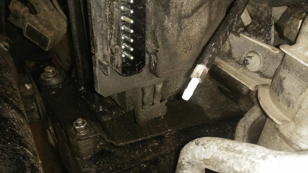

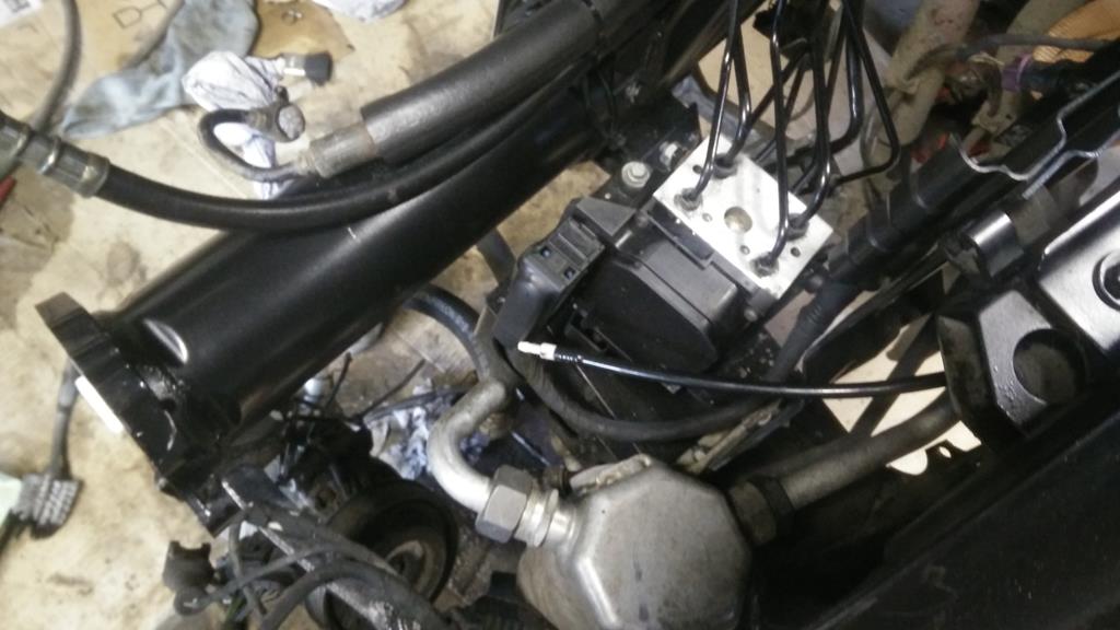

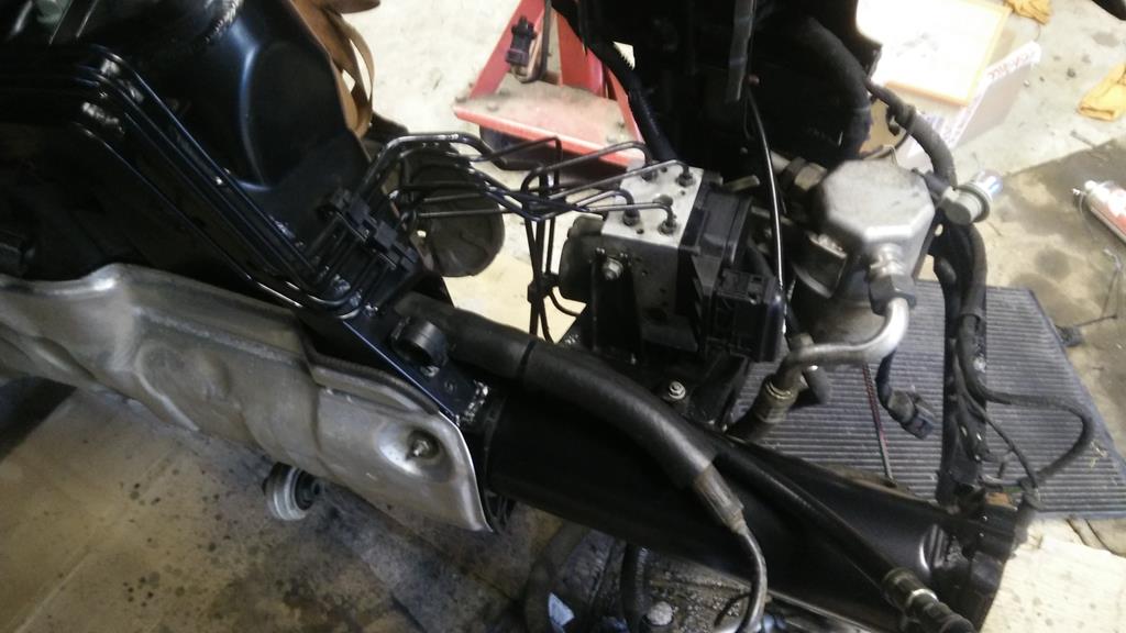

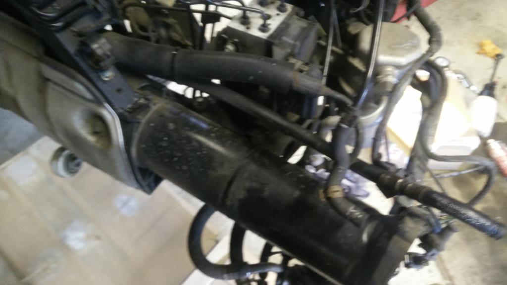

Lots of grot down by the ABS pump as the power steering hoses are always leaking
Most of the heavy gunge off

All clean and ready for the engine tomorrow

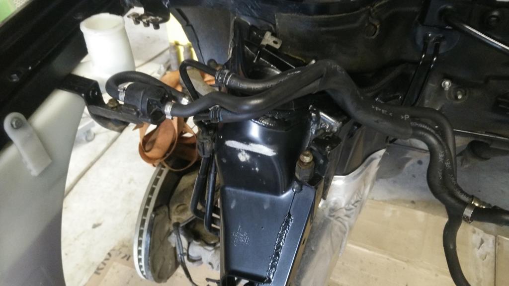

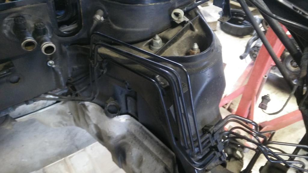

Today was a day of great progress, countered by great vexation, and very few photos taken with a potato.

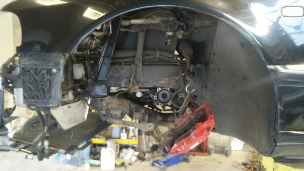

Mike came over to lend a very welcome helping hand and we got the front suspension off in preparation for replacing the upper control arms.

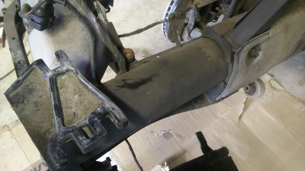

http://forum.a8parts.co.uk/attachmen...1&d=1555011134

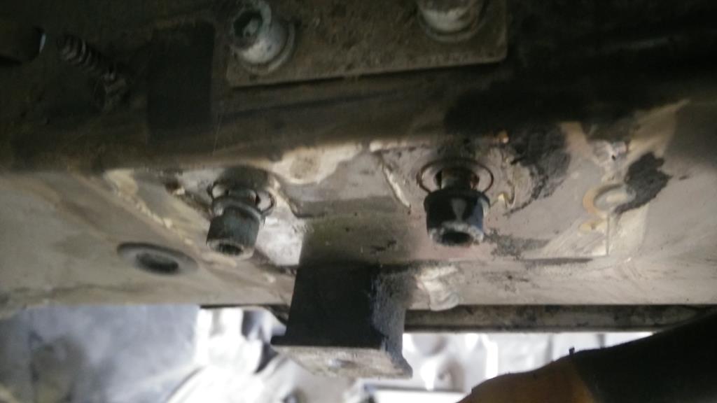

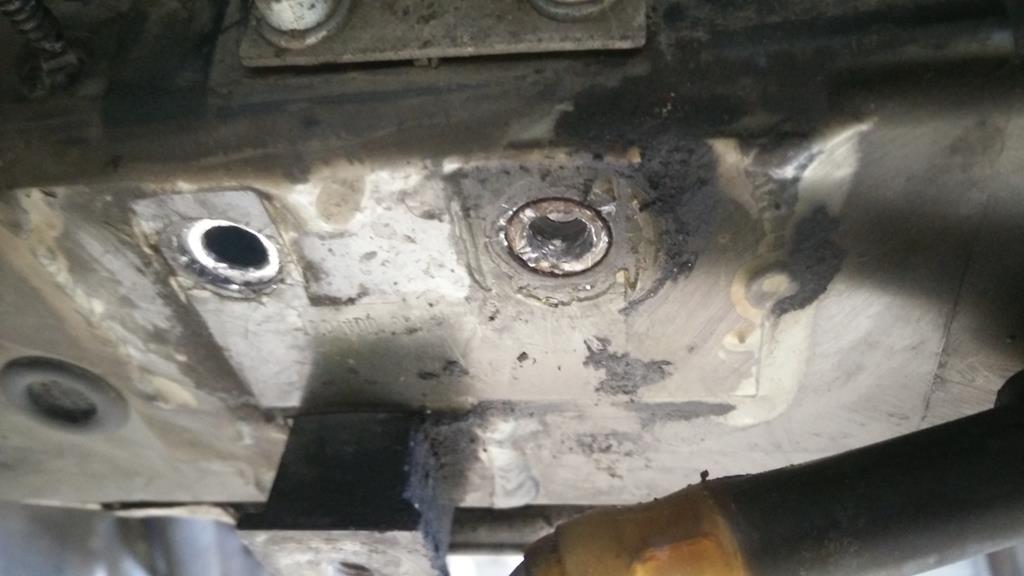

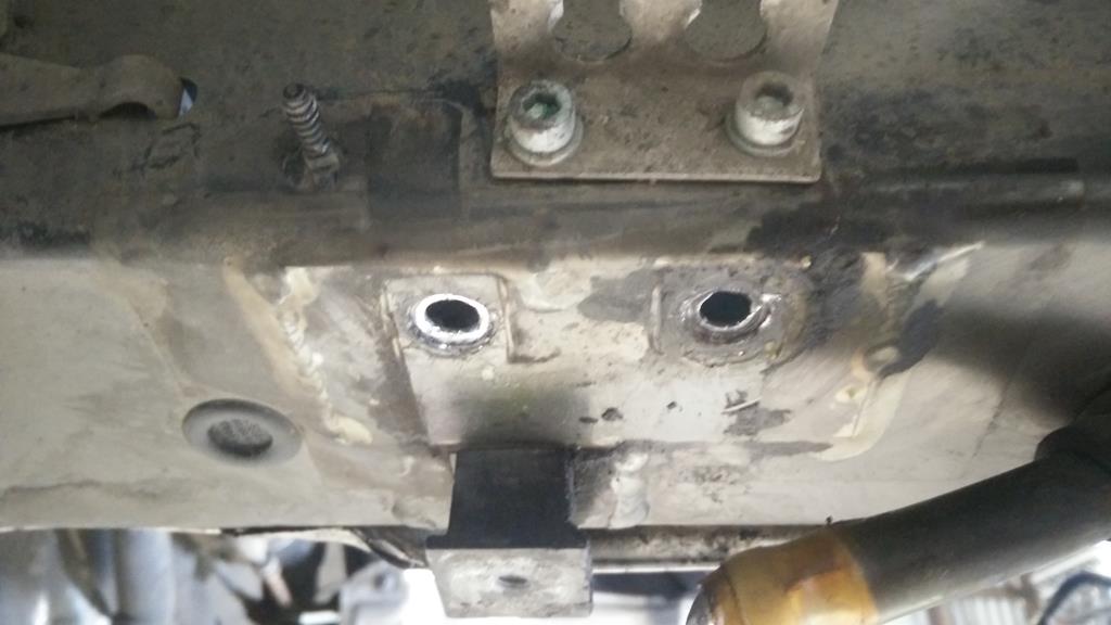

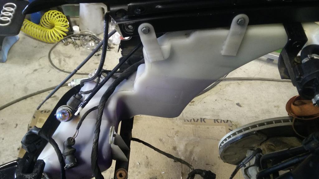

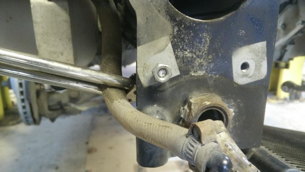

As usual the junction box under the chassis leg had disintegrated, so while the suspension was out I figured I'd get these two bolts out and clean this area up, and thus began the vexation :mad:

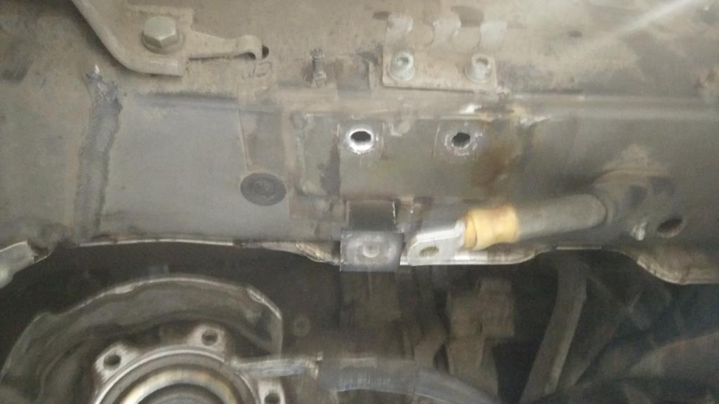

Doing so many of these, it was inevitable that these nutserts were going to get me eventually, and today was the day - the bolts were seized in to the nutserts so they just spun in the chassis leg :-(
I started off drilling off the bolt heads, and then tried to drill out the nutserts, but they were so loose the drill then spun them round instead. In the end I had to use a carbide burr in the dremel to separate the top and bottom bits of the nutserts and then broke them apart with a centre punch.

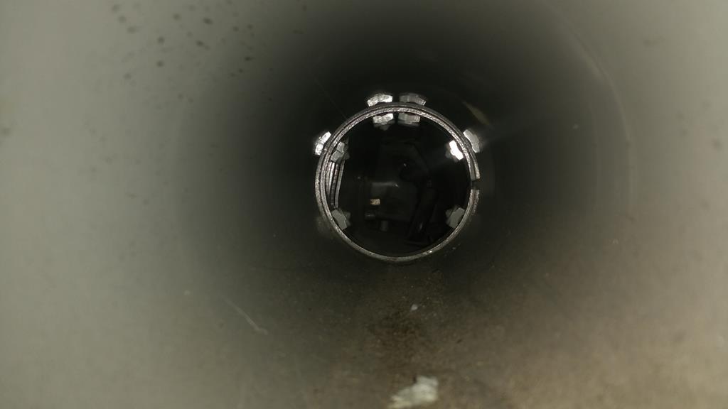

I had to use a magnet on a stick to fish the bits out of the chassis leg - they are about 2 feet down here
The vexation continued when I realised I don't have any M6 nutserts. Plenty of M5 and M8 obviously :rolleyes: Hopefully some will arrive tomorrow, and if not Mike has some.
They will go in here

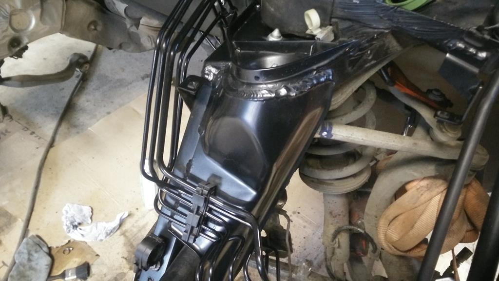

Cleaned up ready for tomorrow. It took well over an hour to get here from the first turn of the bolts :(

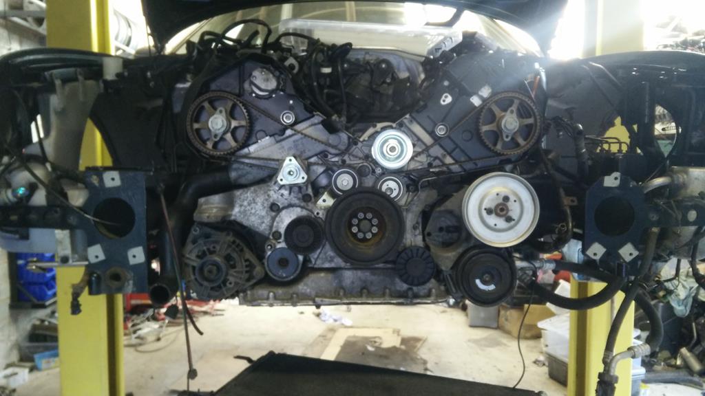

After lunch we put the engine back in and started reconnecting everything and I forgot to take any pictures

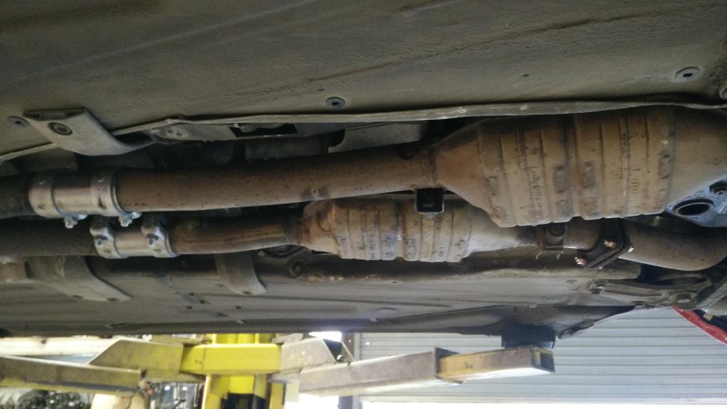

I did get a snap of some new exhaust hardware
