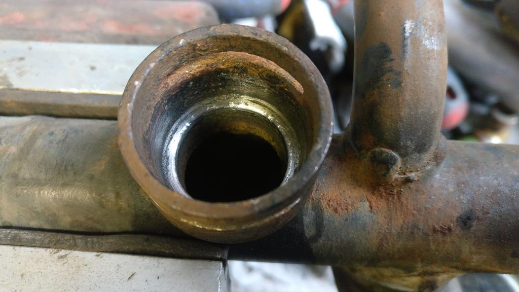

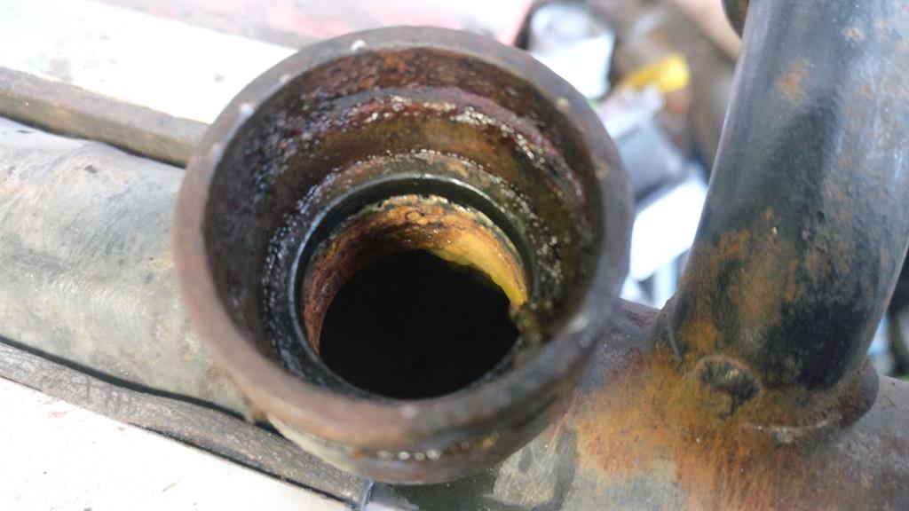

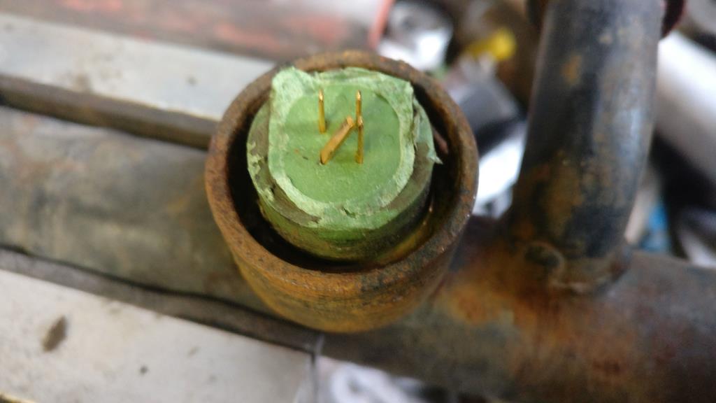

As usual the temperature sensor was rusted in place, so had to be destroyed to get it out.
http://forum.a8parts.co.uk/attachmen...1&d=1621890451
Pretty crusty
Cleaned up ok

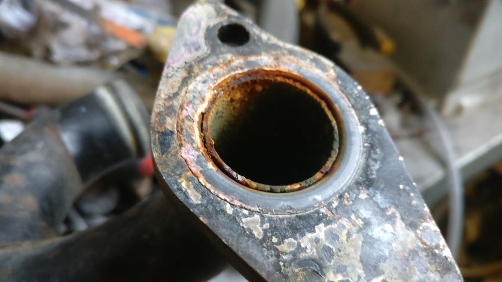

The coolant pipe o-rings were also pretty crusty

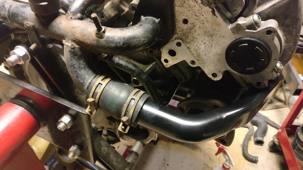

Replacement link hose and powdercoated coolant pipe

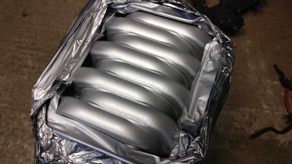

No amount of elbow grease would clean up the manifold, and I had nothing else to do so I gave it a lick of matt silver paint

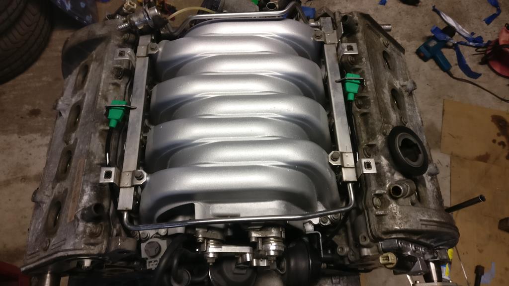

Sunday morning after the paint has dried. New inlet manifold gaskets on, ready for the manifold
Manifold refitted

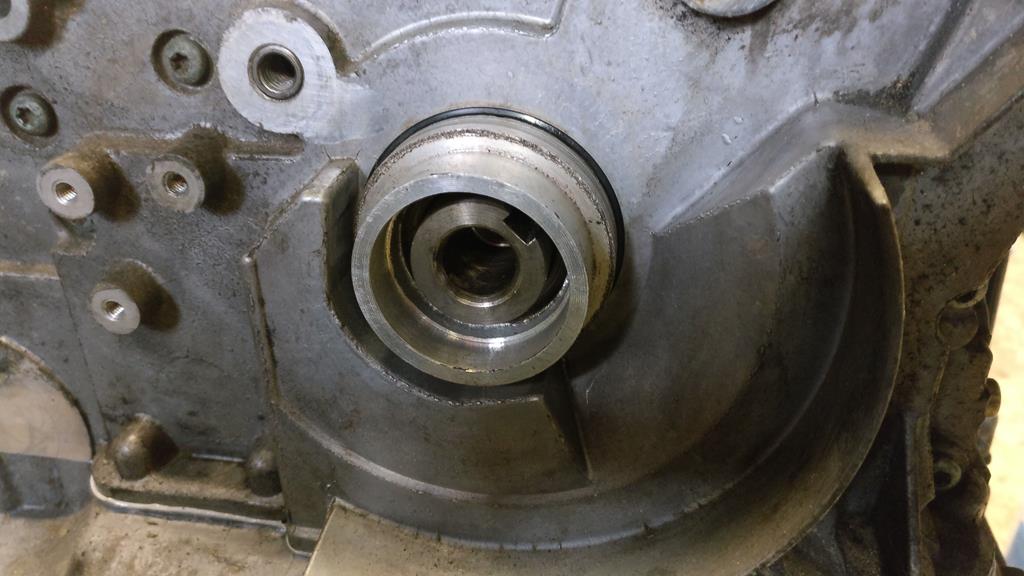

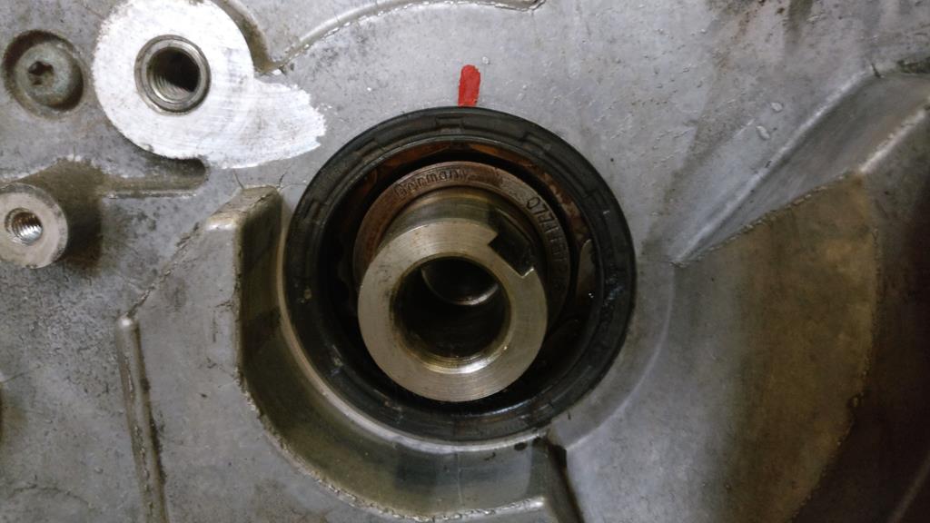

Crank oil seal - this was dried up and leaking
New seal fitted to the bushing
and pushed in place with the purpose-made tool. The manual says to push the seal in place and then fit the bushing, but that is extremely difficult to do without folding over the lip of the seal, hence why I fit the bushing to the seal off the engine so I can make sure its all ok, before fitting both bits together.

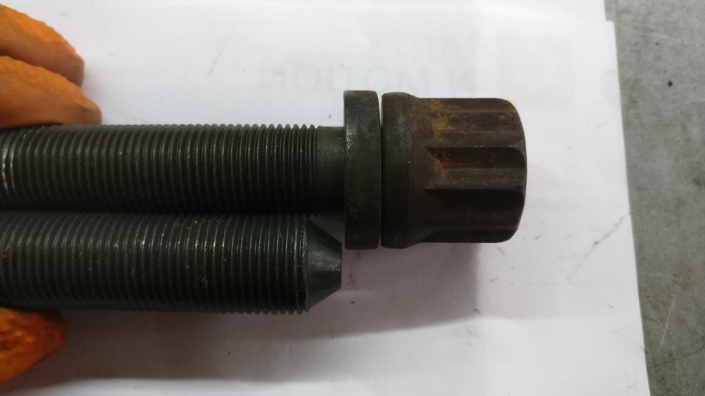

Old crank pulley bolt at the top, new one at the bottom. It has stretched about 2mm!

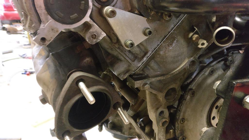

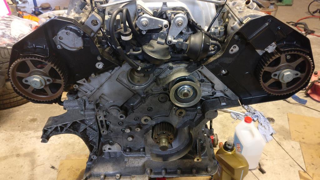

Stuck now with no timing belt or thermostat

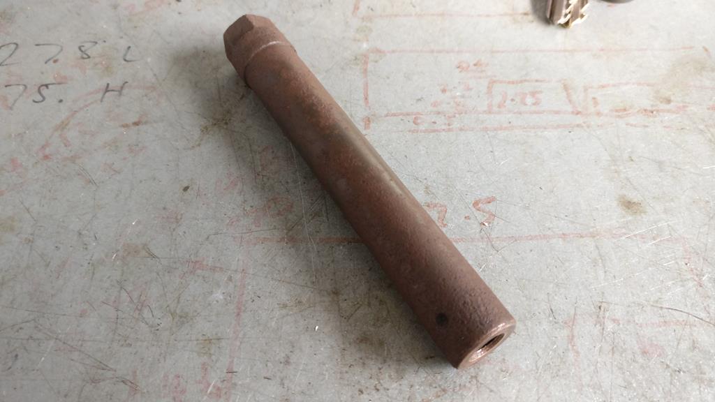

Mark - this is one of the long nuts which goes through the manifold
Markiii 25th May 2021 08:43 AM
thanks MJ so that bolt, holds on the manifold?
ref http://forum.a8parts.co.uk/attachmen...1&d=1621890451
what am i looking at there? coolant pipe? green cable ties?

MikkiJayne 25th May 2021 08:16 PM
Yes. there are a dozen ordinary M8 flanged nuts, and then two of these long nuts which go right through holes in to the manifold.
Thermostat bypass pipe with the bank1 knock sensor cable tied to it, per the factory installation, although the factory used black ties. You get green since I ran out of black :D There is a satisfactory serendipity having the cable ties match the knock sensor connector, not that you're likely to ever see them again since they live under the inlet manifold.

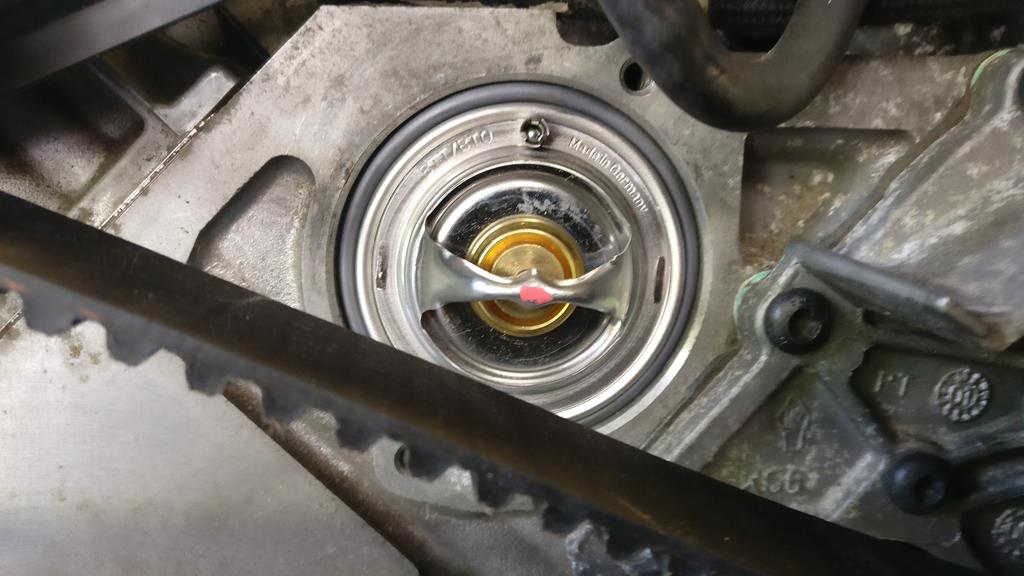

New thermostat in place
http://forum.a8parts.co.uk/attachmen...1&d=1622060908

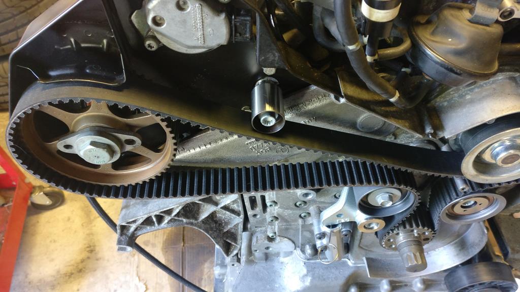

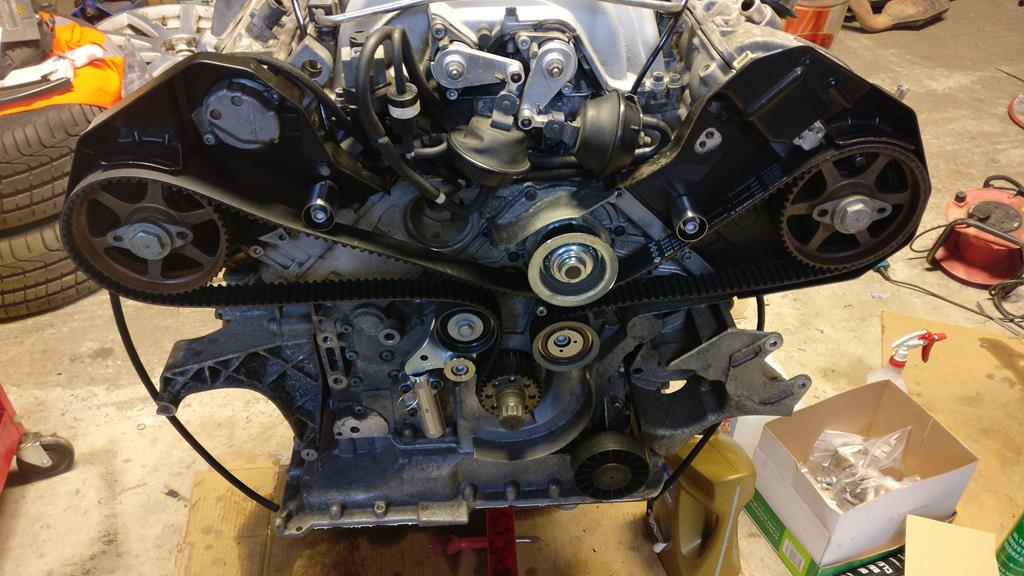

The cover went on without fully removing the belt

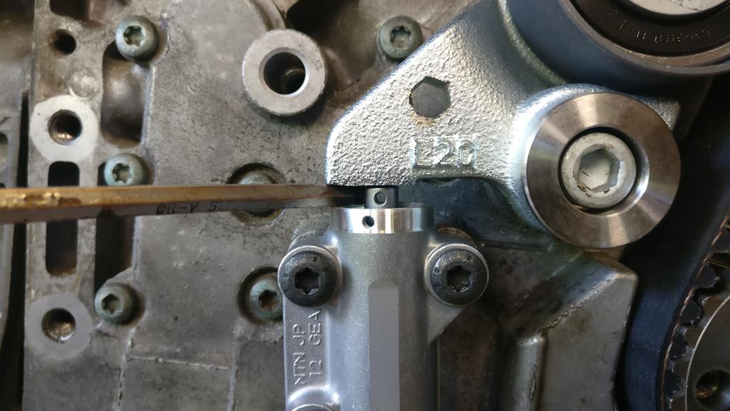

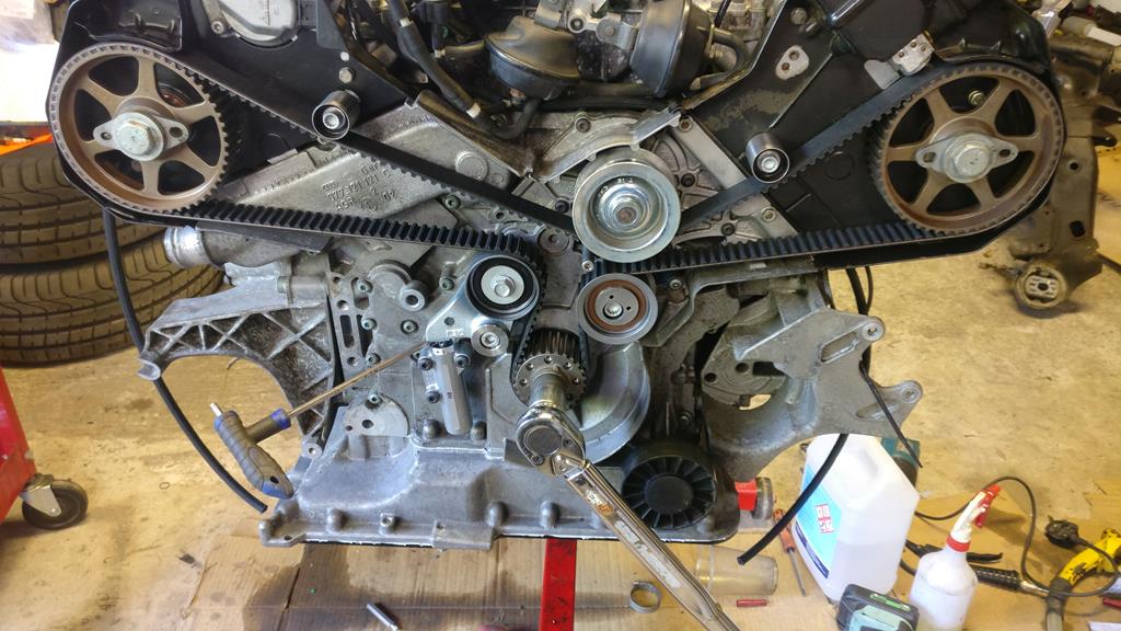

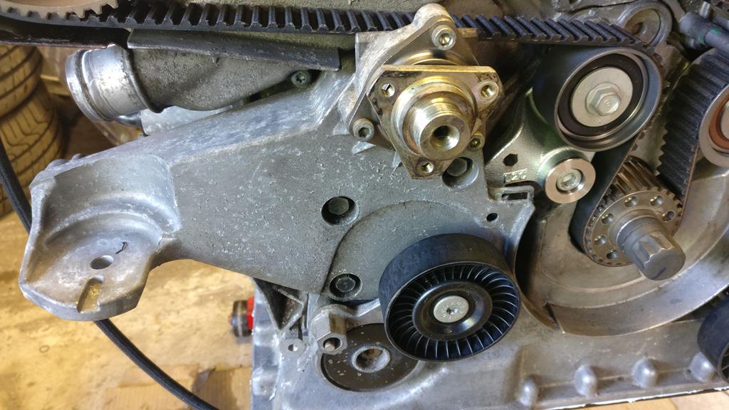

Tensioned the belt and finished everything off
Spec here is 5mm +/- 1mm.
New fan bearing and tensioner roller also in place

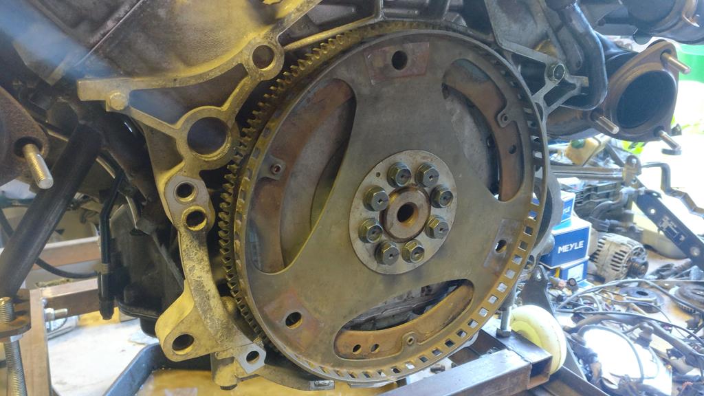

The starter teeth on the original flex plate were pretty trashed after eating bits of starter motor so I replaced it with a good spare, and thats the major engine work complete. All that's left is to put the spark plugs back in and coil packs on once I've spun it on the starter to get oil pressure, and then the replacement wiring harness and coolant hoses go back on when it's reattached to the gearbox.
