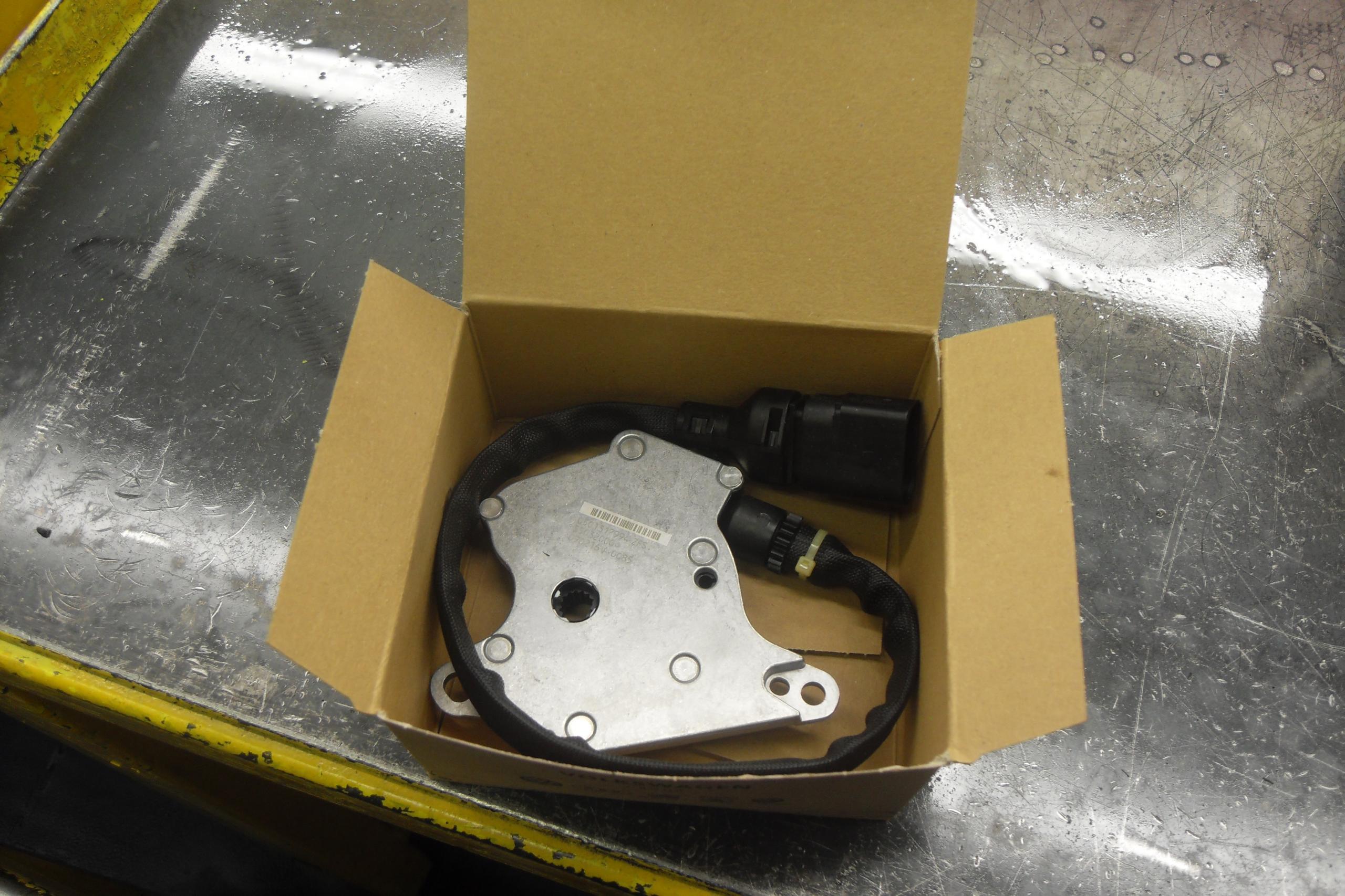

moltuae 23rd June 2017 12:18 PM
1 Attachment(s)
Originally Posted by tintin (Post 129510)
I must check my codes from the recent A8 parts visit - my car is going into Mackies in a couple of weeks for a gearbox service, so I may get the F125 switch replaced then, if they can do that.
When I spoke to them, they weren't sure about what the F125 switch was, but referred to a range selector switch instead? Anyone on here know whether that's the same part/item or not?
Yep, that's the one. I had them change mine when they rebuilt the box last year (see invoice below).
Attachment 16373
Coincidentally, I was just speaking to John at Mackies yesterday to provisionally book my car in for an annual gearbox service in early October.
tintin 23rd June 2017 12:58 PM
Perfect reply - thanks Mark. And you have to love their warranty - also perfect.
moltuae 23rd June 2017 01:35 PM
1 Attachment(s)
Certainly can't fault them. My box has worked flawlessly since the rebuild. +++
Stephen, in case there's any confusion, this might help. This is a photo they sent me of my new F125 switch waiting to be fitted. You can just about make out part numbers if you zoom ...
Attachment 16375
I'm assuming of course that your car has the same part/connector, being about the same age.
tintin 25th June 2017 07:10 PM
Thanks again Mark - very helpful, as I'll be talking to John @ Mackies tomorrow: I'm sure it'll be the same part number, for the reasons you've said, but he'll be able to check this. I'll get the gearbox service and this replaced when I'm up for the Celtic Champion's League match on 19th July +++
