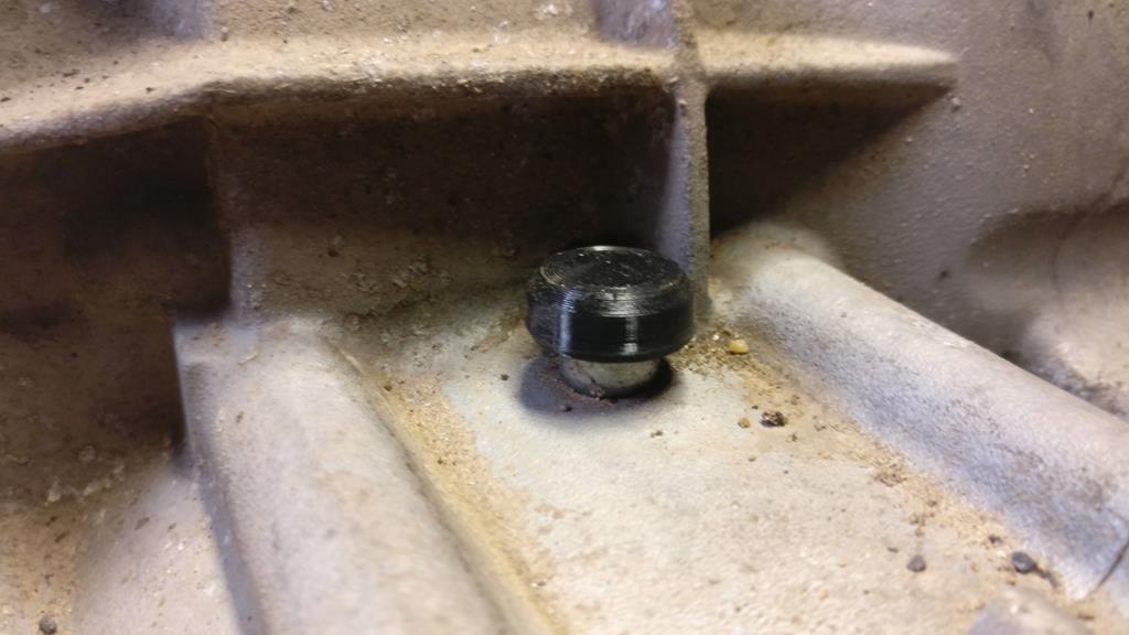

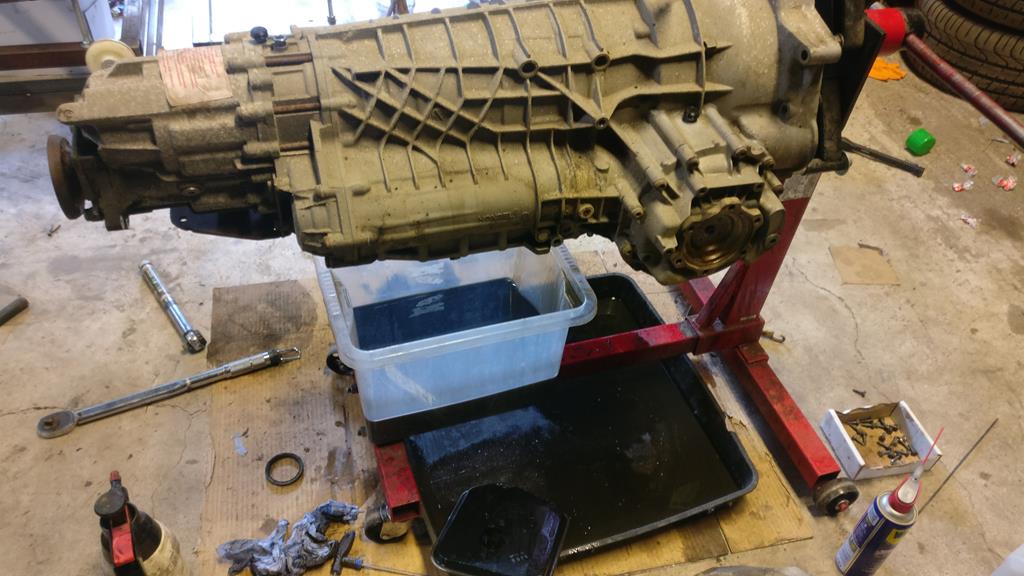

Gearbox next. As usual, I will flip it over to get to the sump and filter, however normally when I do that the diffs are drained ready for re-sealing. This one though is not leaking and so I'm not touching the output flanges and not draining the diffs. That means that if I flip it over, the gear oil will all leak out of these breather holes:
http://forum.a8parts.co.uk/attachmen...1&d=1622148471
So, I printed some polyurethane plugs for them which worked very nicely

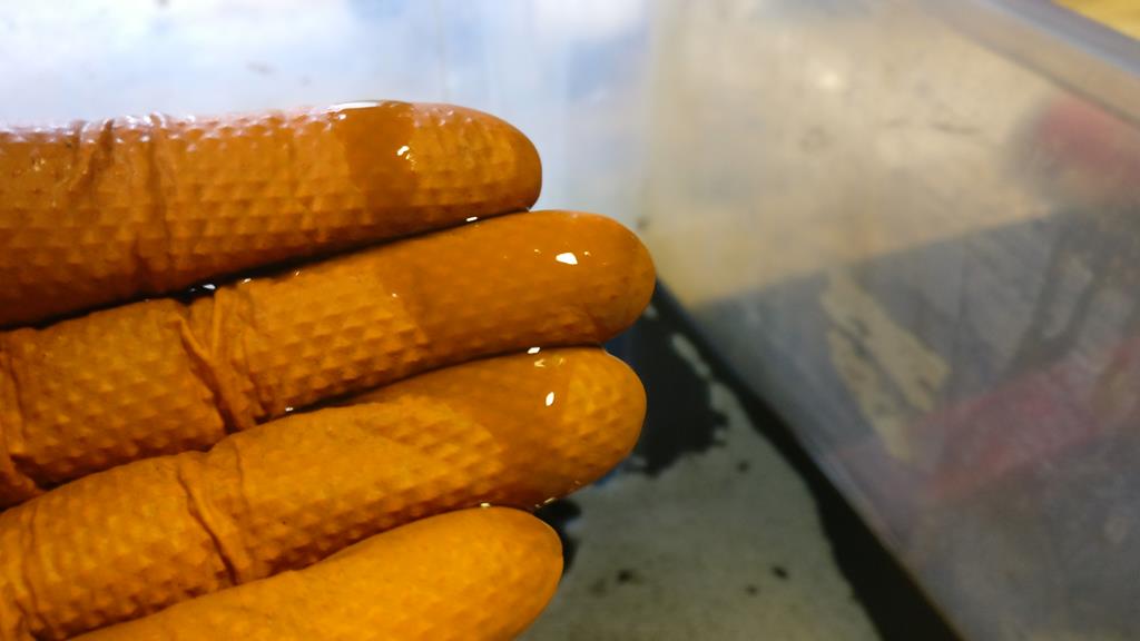

The ATF is nice and clean

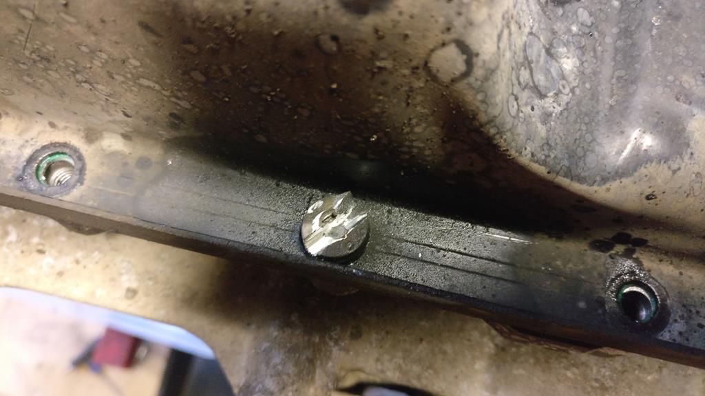

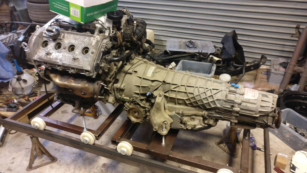

I flipped it over to remove the sump. This bolt was stuck and stripped out. I cut a slot in it with the grinder and then persuaded it loose with a cold chise. There are usually a couple stuck on this side because the holes here go right through and the end of the threads get rusty. I have plenty of spare bolts so not a problem.

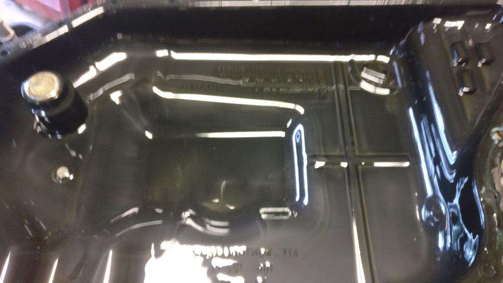

Nice and clean in the sump - no fluff on the magnets. The phone had considerable trouble focusing on the shiny surface.

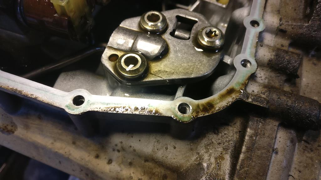

Evidence of a leak on this corner
Left it overnight to drain. New filter and sump back on tomorrow

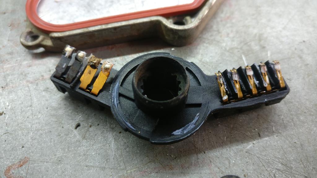

At Mark's request I dismantled and inspected the F125 while it was easy to get to - nothing unusual to report and everything ship-shape so I re-greased it and bolted it back together.
http://forum.a8parts.co.uk/attachmen...1&d=1622231966
Contacts are all good

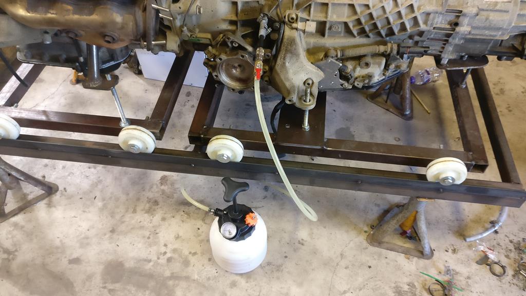

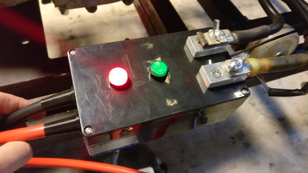

I have built a magic box to simplify the process of spinning the engine to get oil pressure while its on the separating table. It plugs in to the oil pressure switch, has a couple of flying leads to connect to a battery, and the starter cables attach to the right hand side. The red button is a switch which lights up when it has power
http://forum.a8parts.co.uk/attachmen...1&d=1622490389
Press the switch to activate the starter, and the green light comes on when there is oil pressure +++

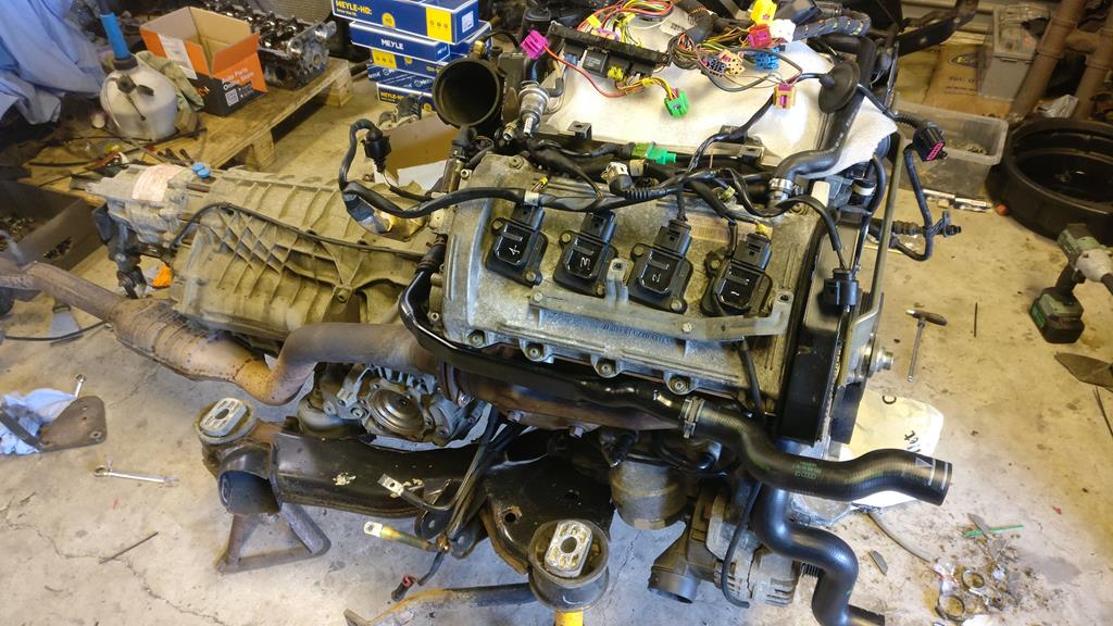

Took the engine and box off the separating table and put them back on the subframe to refit everything else. Spark plugs and coil packs on.

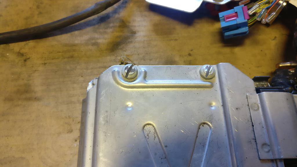

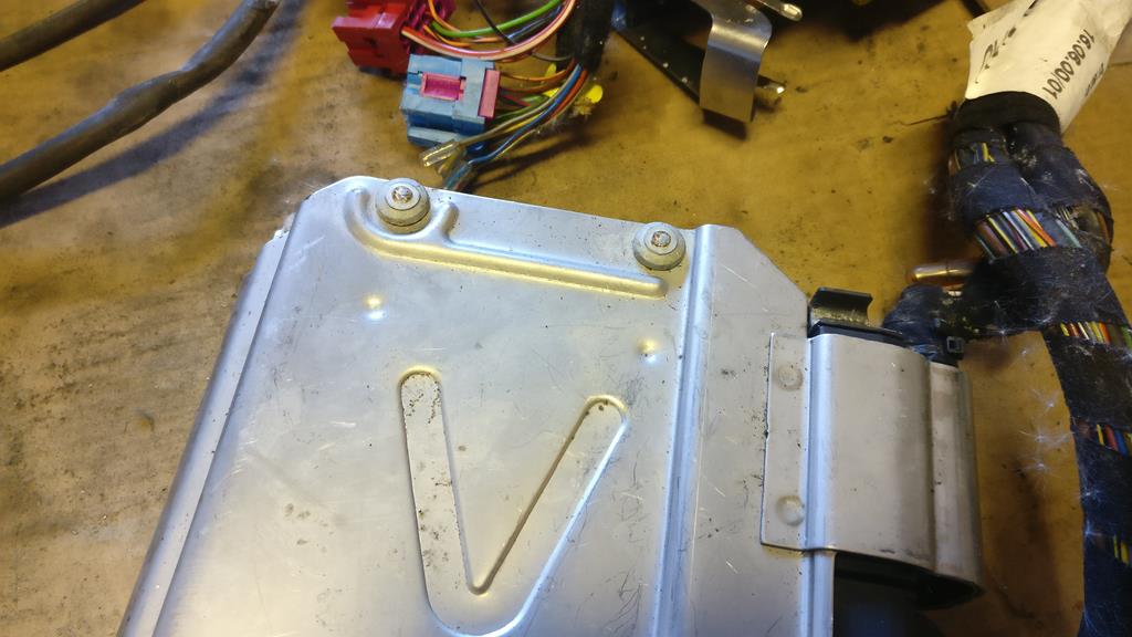

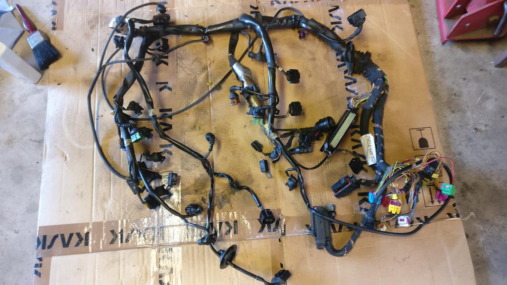

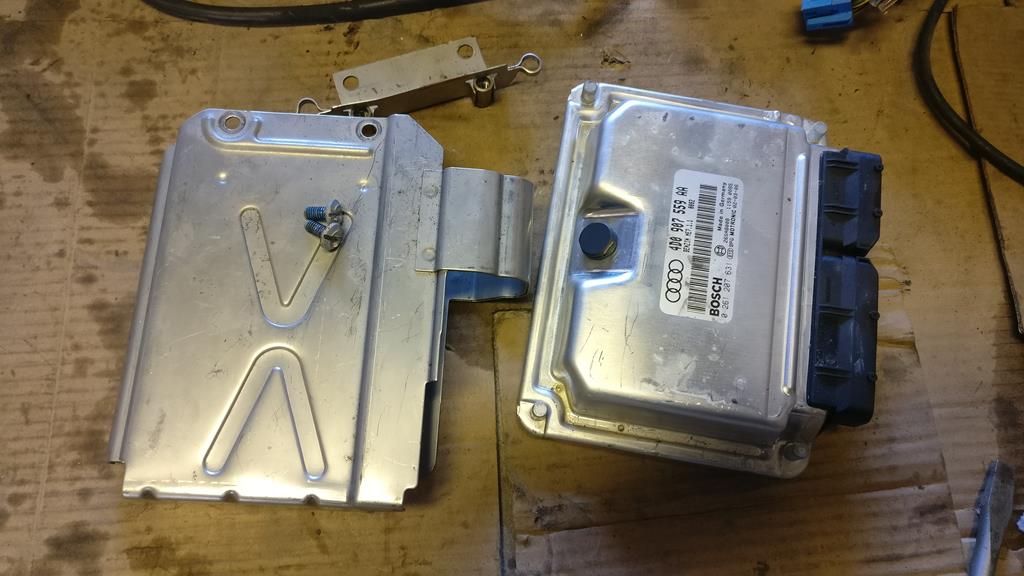

I'm swapping the engine harness (because of the missing connectors) and so I need to swap over the ECU, but first it needs breaking out of its jail
Cut slots in the shear bolts so they can be removed with a screwdriver
Escaped!
The replacement harness
Fitted to the engine

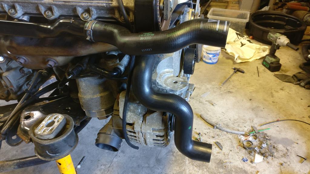

New coolant hoses

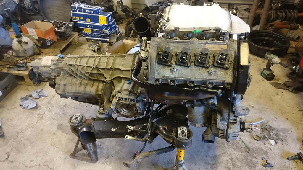

The engine and box are finally complete, at long last. As I'm replacing the control arms, I'll attach the lower arms and driveshafts to this tomorrow which will make it much easier to put back together.
