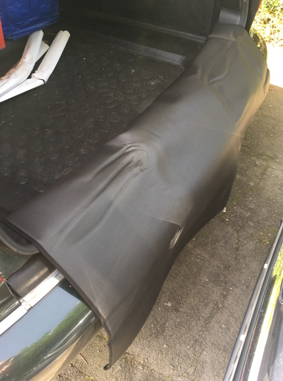

HPsauce 6th October 2017 01:04 PM
1 Attachment(s)
Barry the Barrier in place (made in Poland if anyone is interested):
