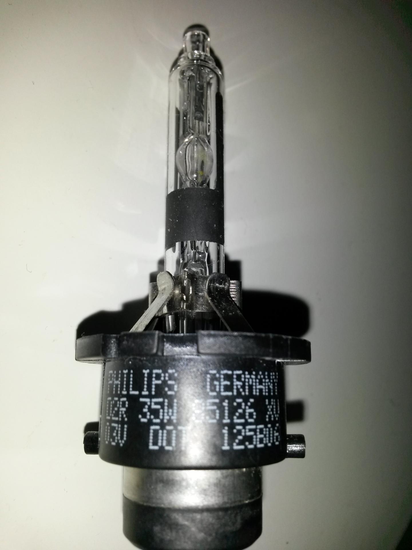

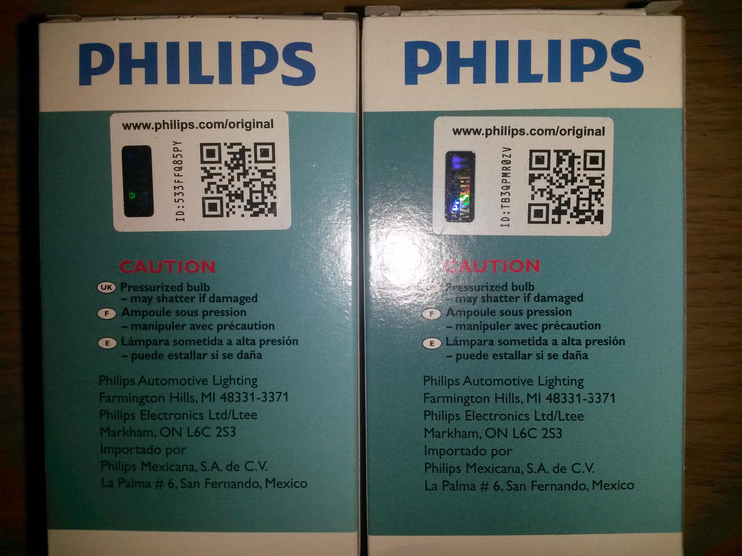

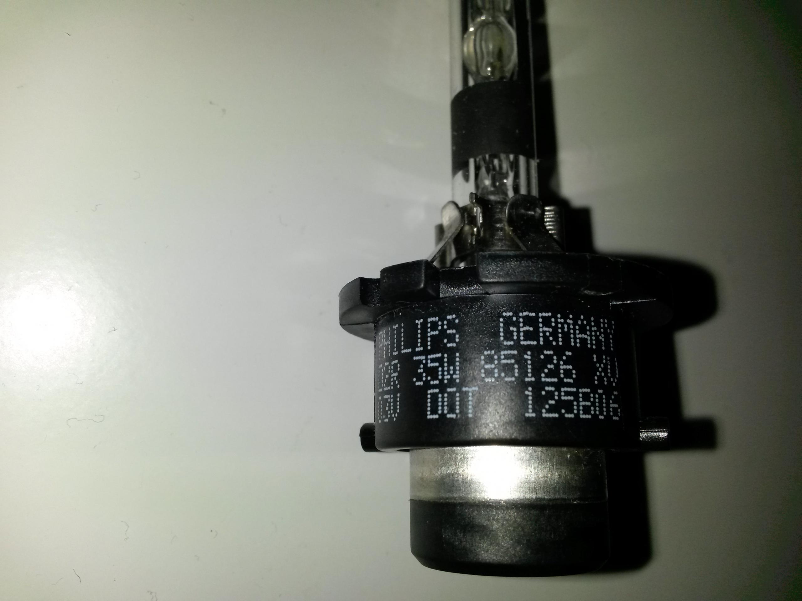

You're welcome :) For reference/comparison, these were the fakes I received. It's hard to tell from the photograph, but the holographic element is 'flatter' on these than the genuine units. Comparing the bulbs with photos of fakes online suggests they fakes have been gradually improving, making it more difficult to tell but the lack of weld points was the clearest indicator.
Attachment 15829 Attachment 15830 Attachment 15831 Attachment 15832
I won't publicly mention the seller since it may have been a genuine mistake (if you pardon the pun) or an issue with his supplier. PM me if you need know.

Thanks for those pictures Mark, where would these weld points appear and what do they look like?

These are the weld points (genuine bulb on the left):
https://i.imgur.com/iXAxK7R.jpg
The image was taken from here, which gives a few more things to look for:
https://www.powerbulbs.com/blog/2014...e-real-or-fake
It seems to vary from one fake to another which of the traits are present. The fakes I had were almost identical to the originals (as far as I could tell) apart from the missing weld marks and the missing 'curved' part mentioned here:
http://www.hidconcept.com/blog/a-war...eadlight-bulb/
The seller I bought from also sold on Ebay (and had lots of positive feedback) but I bought them from their website instead.
The name of the seller's business you bought from doesn't happen to contain the word 'style' does it?

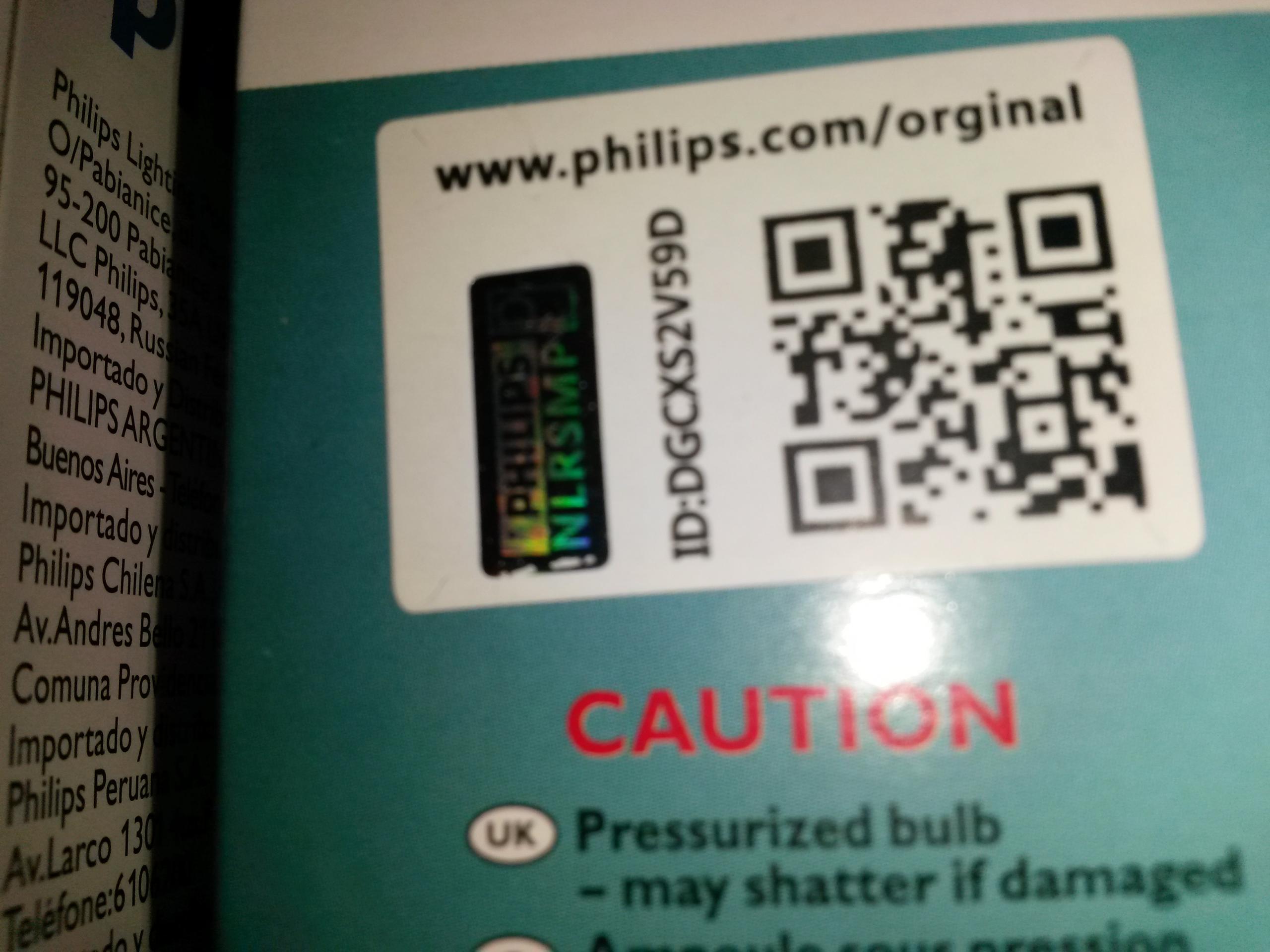

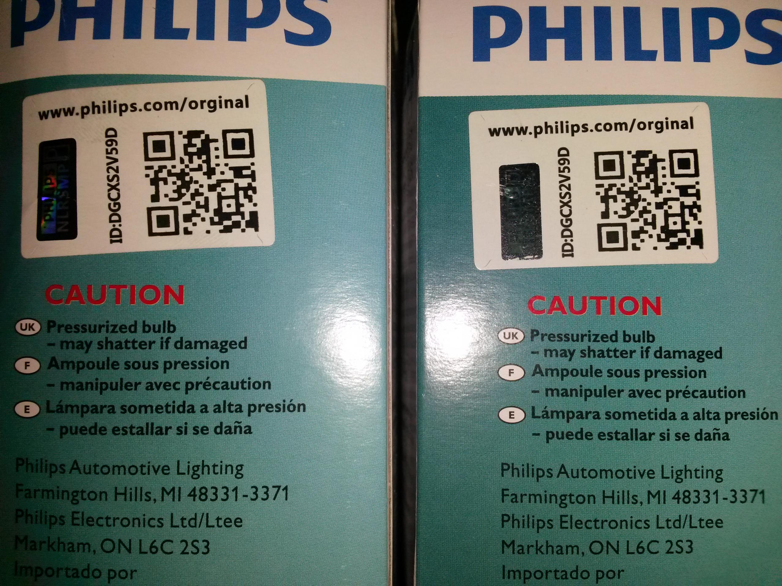

OK, so they have arrived and I reckon they are fakes. :angry2:
Same ID on each for a start, no inner tube to protect, hologram very flat, no visible welds.
The question is how to deal with this....
Edit: Just spoke to Philips, they are fake. Recommendations anyone?

Well, well, well, exactly the same (unique according to Philips!) codes on both my boxes! :angry2:
I'll post again when I've made some progress, meanwhile "lips are sealed".

The first thing that I saw when reading this thread and viewing the accompanying photographs was the heinous typo on the packaging, and that would have set Johnny's SPAG pedant alarm bell ringing (spelling, punctuation and grammar.)
www dot philips dot com ORGINAL?
