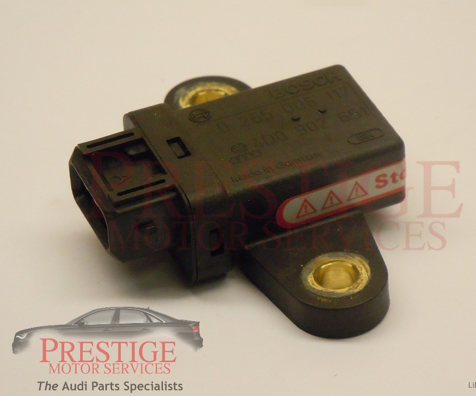

It's going into the garage tomorrow so I've picked up a spare lateral acceleration sensor (from our forum sponsors), part number 4D0907651. Do I have the right one (for a 2002 S8)?:
Attachment 16988
I figured it would be better to have a spare one ready to swap in case it turns out not to be a connection issue.
I've been trying to find some information to give to the garage but all I've found so far is page 156 of the attached pdf, which appears to describe different (earlier?) sensors.
Does anyone have any info related to accessing/replacing the sensor I have?
