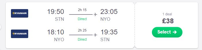

I could probably go and pick it up for less than that http://www.corradov8.com/pics/screwy.gif
An independent specialist or accommodating DIY'er has to be the way to go +++
