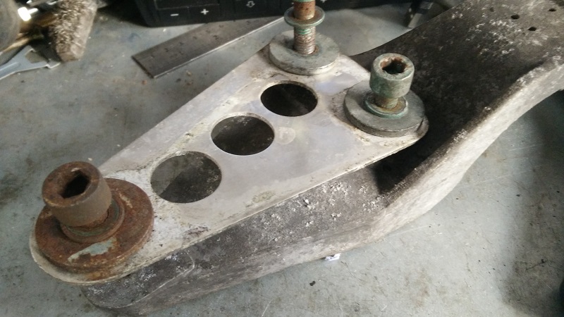

MikkiJayne 14th September 2018 04:24 PM
1 Attachment(s)
They're often stuck on to the bottom of the bracket with corrosion :)
http://forum.a8parts.co.uk/attachmen...1&d=1536942268
27litres 14th September 2018 11:57 PM
With those shims/spacers, its almost as if Audi expected that torque mount separation to happen!
