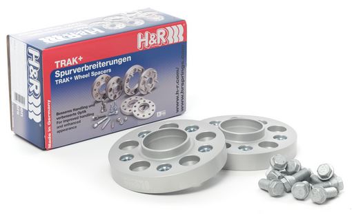

Use these instead then
http://forum.a8parts.co.uk/attachmen...1&d=1550749851
I think the thinnest they have is 20mm though.
Do you need spacers for them to clear the suspension or are they just for visual effect?
roberto 21st February 2019 11:01 AM
just visual
but ive looked at them and the small bolts that go into the original hub only pull on a very thin lip on the spacer and i dont like that looks like a weak point
MikkiJayne 21st February 2019 11:44 AM
Well my wheels haven't fallen off yet :ROFL: I've run a set of these on my daily driver for about 10 years, and I also have a set of adapters in the same design to run the Q7 20s on my S8.
The wheel bolt threads in to a steel insert which is pressed in to the alloy spacer from behind. The insert is as thick as the car's hub so no less strong +++
