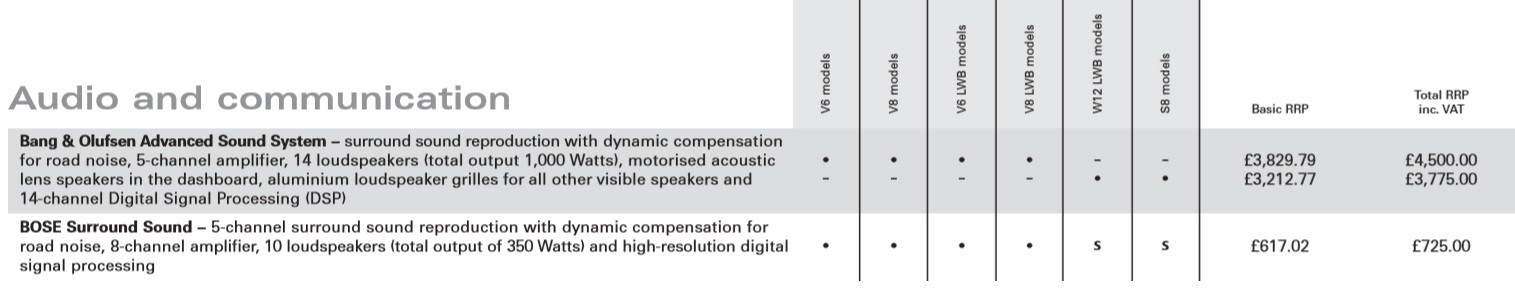

IT 18th May 2020 11:28 PM
1 Attachment(s)
Originally Posted by NightOwl (Post 157501)
A question in the end, how much did the BOSE option cost ordering a new car? And how much for the B&O option?
http://forum.a8parts.co.uk/attachmen...1&d=1589844476
