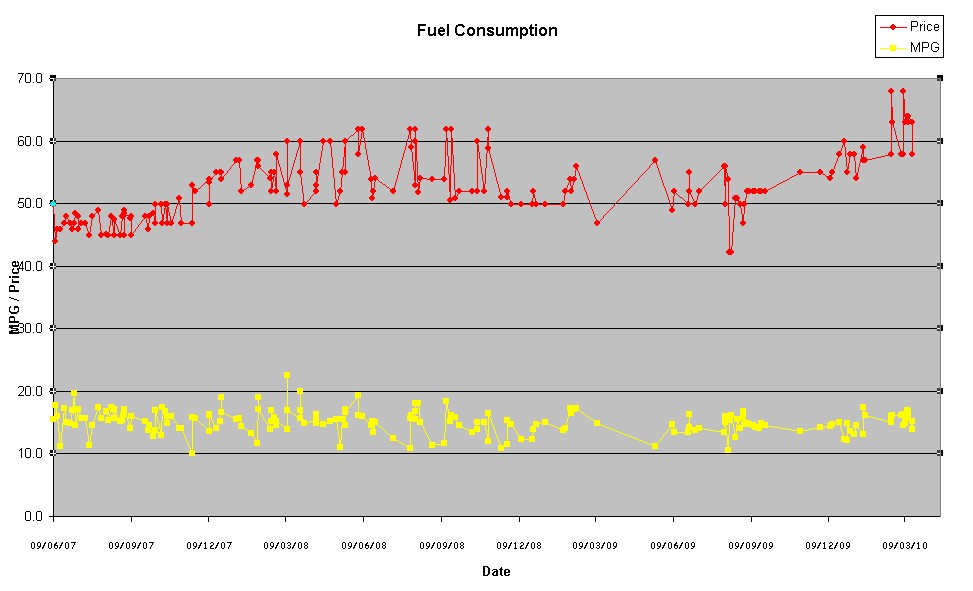

Conan_the_Librarian 19th March 2010 12:44 PM
1 Attachment(s)
Thought I would add this for mild interst sake. :)
http://forum.a8parts.co.uk/attachmen...1&d=1269006094
Kinda proves my fall off in MPG over the period of ownership! Must recalibrate my right foot! :D
