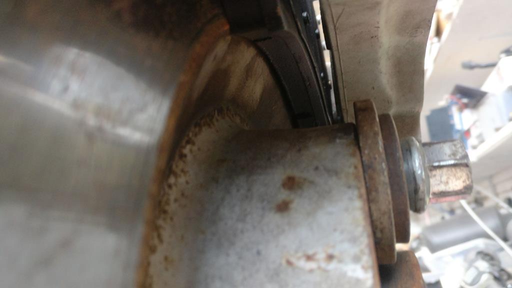

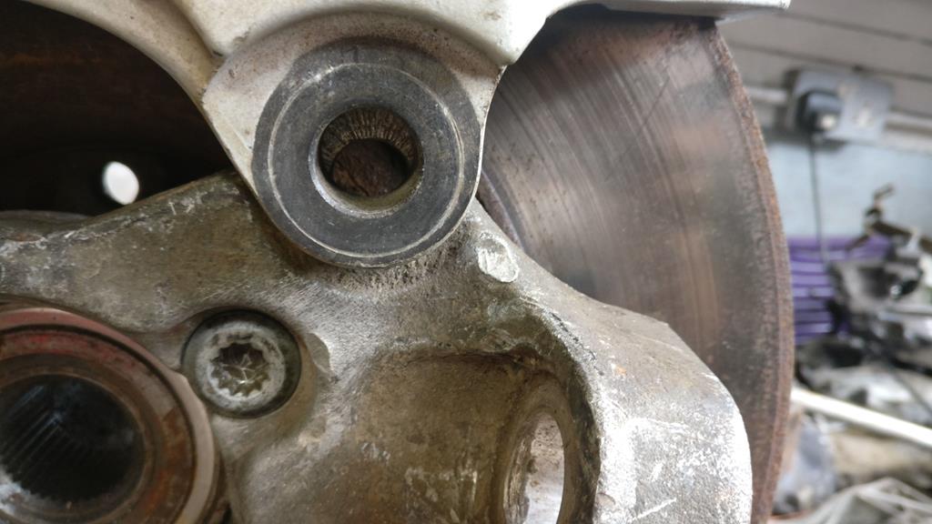

2 Attachment(s)
I can't lock the wheels on my S8. I can't even trigger the ABS on dry tarmac.
This is what I mean about the 18z calipers btw:
http://forum.a8parts.co.uk/attachmen...1&d=1594823804
The caliper lugs and the upright lugs both occupy the same point in spacetime. There's nowhere to create a bracket.
However, this is the first time I've tried with a 345mm S8 disc, and its actually pretty close. I am going to try some C5 A6 hub flanges later which sit 6mm further inboard than the D2 ones, and it might just work. I feel that these calipers would be a worthwhile upgrade from the stock Brembos, even on the same size disc as they tend to work properly for longer, are lighter, and should give more even pad contact. I'm not sure they would be better than the 360mm D3 setup though, even with the associated weight penalty. I'd probably have to try both back to back.

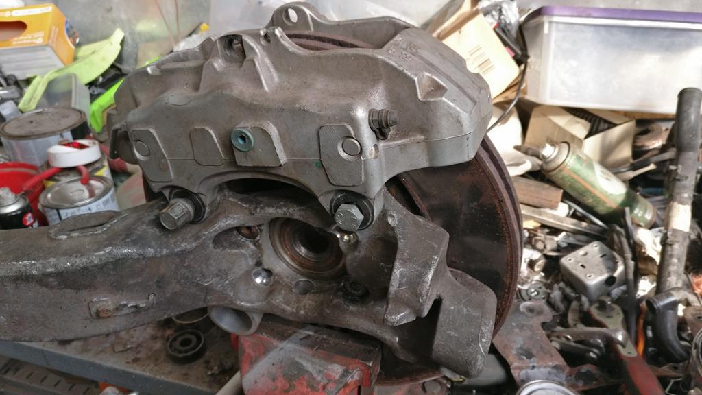

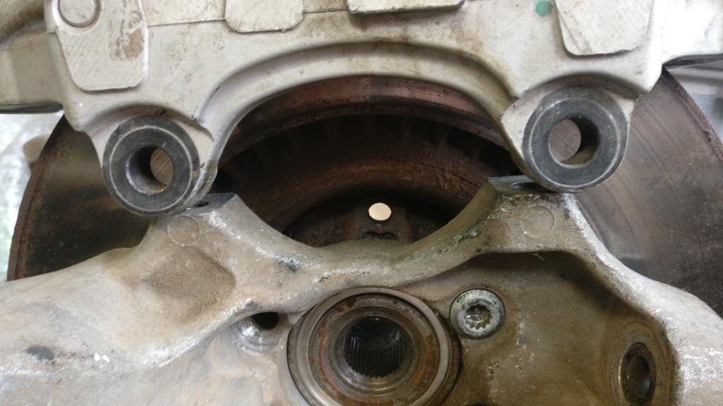

MikkiJayne 15th July 2020 05:04 PM
3 Attachment(s)
Sooo....
A8 upright, A6 C5 hub, OE S8 345mm disc:
http://forum.a8parts.co.uk/attachmen...1&d=1594831739
To make the S8 disc work on the A6 hub (moving it inboard 6mm) means you forfeit the splash guard, and I think the hub needs a little 'lightening', although it is possible to offset the hub up to 2mm with a laser-cut aluminium spacer so that might be a solution. The 18z caliper fits fine with a spacer washer (maybe offset by spacing the hub) and the usual bolt adapter set with a sleeve for the caliper side. The pad may overhang the disc slightly (since its 2.5mm too small), although I've seen mention of using 17z pads in 18z calipers to solve that. Still, with M12 hardware it would be possible to move the caliper in a couple of mm.
That gave me an idea...
A8 upright, A6 C5 hub, D3 A8 360mm disc:
This also forfeits the splash guard and definitely needs a mm or two shaving off the upright, as it is exactly centred in the caliper as-is. Its very tight on the caliper and may need a little massaging of the caliper inner radius (or machine 2mm off the disc). Again, with 12mm hardware it might actually be possible to move the caliper out a little.
Alas, none of the lightweight discs I have are even close to fitting as the offsets are completely wrong. It could be done with custom alloy bells, but thats missing the point.

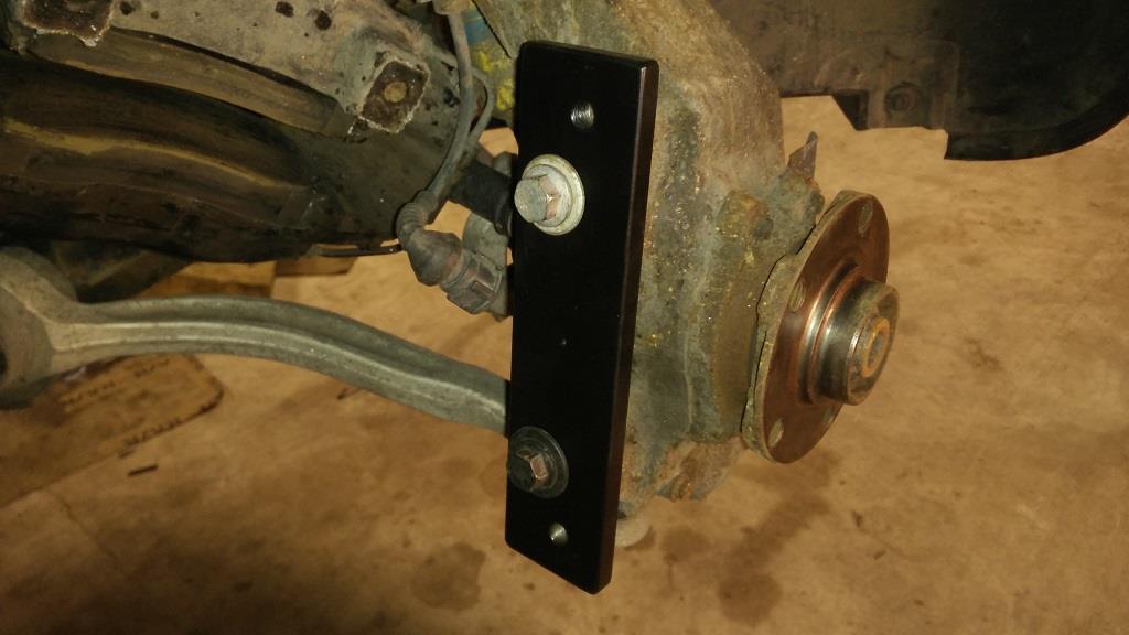

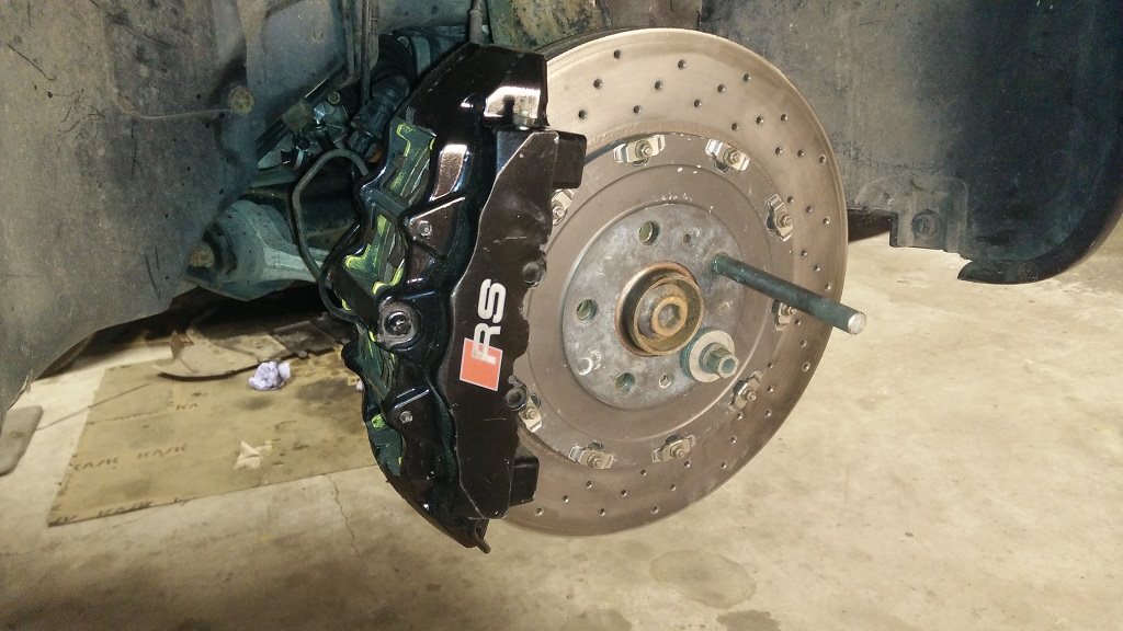

MikkiJayne 16th July 2020 08:47 AM
2 Attachment(s)
Originally Posted by ainarssems (Post 158611)
I could get fronts lock up fairly easy on my PF D2 with stock 323mm brakes but they would also heat up and fade after couple of hard braking sessions.
All of my HP2 D2s brake better than my Brembo D2s :(
Originally Posted by Audifan (Post 158609)
Thanks for info and pictures MikkiJayne +++. Curious if you have any pictures of the B7 RS4 brakes installed on a D2?
http://forum.a8parts.co.uk/attachmen...1&d=1594888873
Pretty simple really. The adapter is just a piece of 10mm flat bar with four holes in it. Wheel clearance is an issue as the caliper is quite chunky and the disc is quite flat compared to the D2 stock disc offset. I can't remember if 18" Avus clear, but the 20" FE wheels need spacers. ET needs to be 30-35 I think.
They stop very well but these discs are very prone to warping and judder and, at £1000 a set, that can get expensive very quickly! This particular car is going to get updated to C5 RS6 discs which are non-floating 2-piece and which are both cheaper and more reliable, at a small weight penalty. They also have more disc offset so we can move the caliper inboard to make more room for wheels.

Audifan 16th July 2020 11:35 PM
Thanks again MikkiJayne +++ but now I'm confused. How is the flat bar mounted as there is no way it will mount flat to the upright as see in this picture :Confused: Or is the opposite side of the upright flat that's not visible in this picture?
ainarssems 17th July 2020 12:26 AM
Your picture is from different car. Flat bar was on S8 with Brembo brakes. Different brakes and uprights on S8 compared to A8
MikkiJayne 17th July 2020 07:54 AM
Correct ^
The RS4 setup is on an S8 Brembo upright whereas I am showing the Porsche 18z with the A8 HP2 upright.
Audifan 17th July 2020 11:30 PM
Thanks for the clarification as that makes more sense.

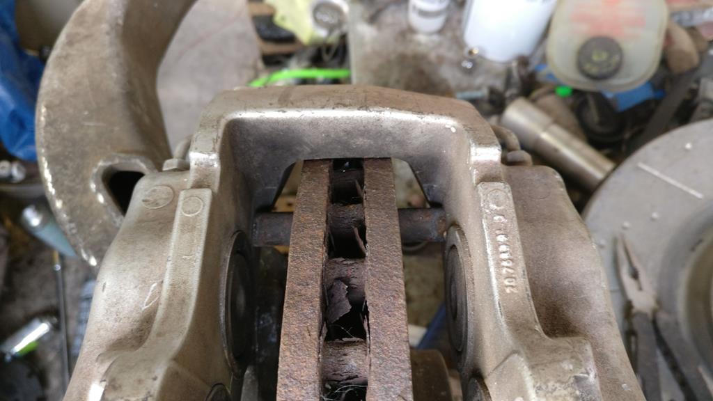

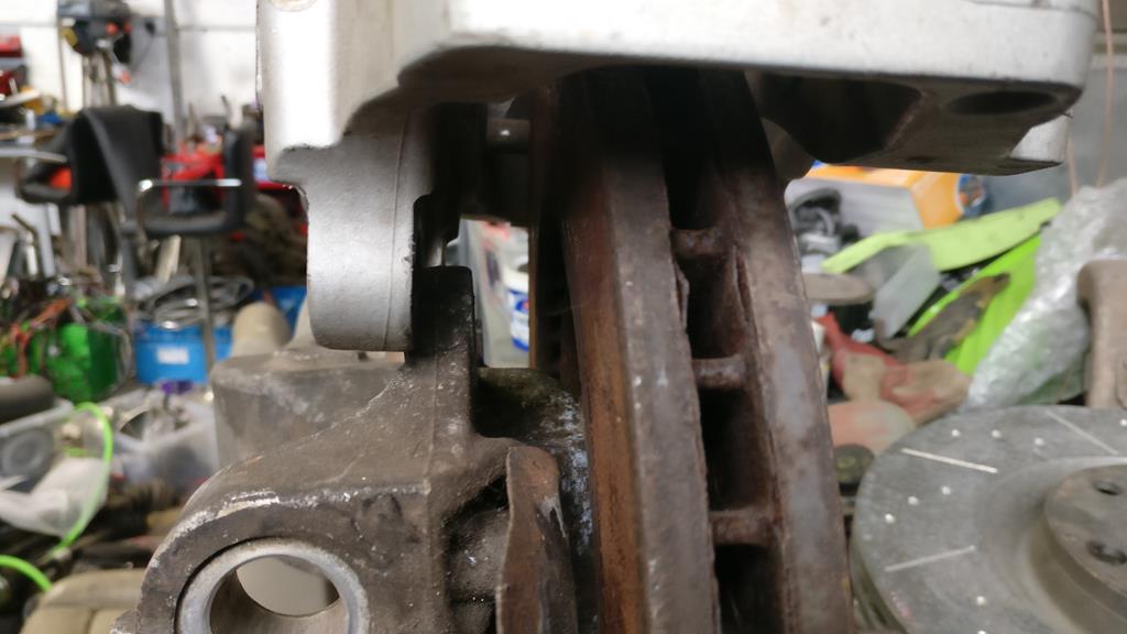

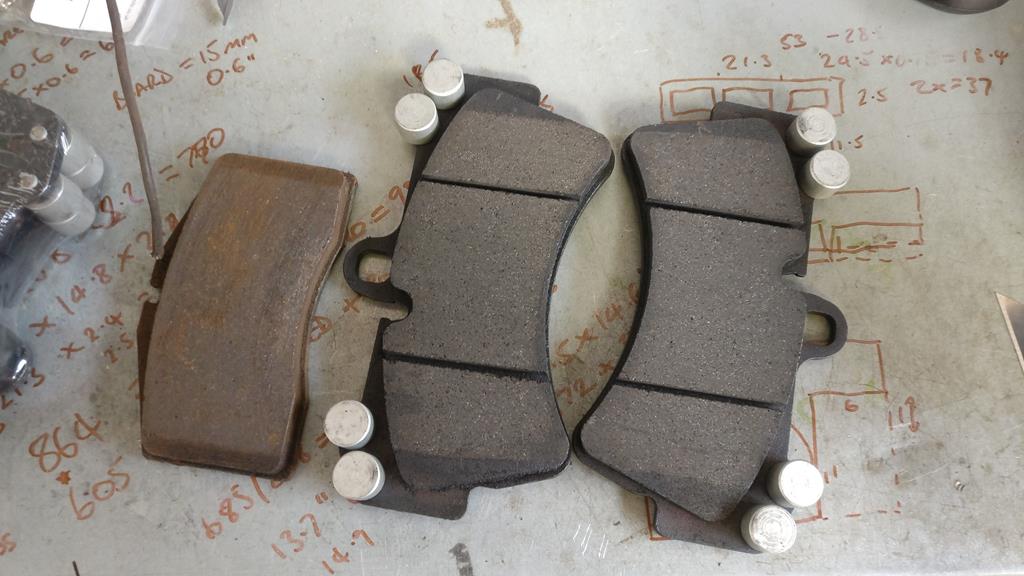

MikkiJayne 20th July 2020 09:13 AM
6 Attachment(s)
Larger pads you say...
http://forum.a8parts.co.uk/attachmen...1&d=1595235429
Porsche / Q7 18z pad vs S8 Brembo! These things are huge :eek2: Tbh I should have figured that out from the size of the caliper but it didn't really register until I had them in my hand.
Btw, cheapest brake pads on the market for a Porsche Cayenne / Audi Q7? £26 :ROFL:
For reference, this is the 18z caliper on an S8 Brembo upright - no way this will work:
This is the 18z caliper on the S8 345mm disc - also not going to work
However, the pads fit the D3 360mm disc perfectly. The only challenge then is a 4mm offset in the mounting holes:
I think this might be possible to solve by boring out both the caliper and the upright an additional 1mm and creating an offset bushing to take an M12 12.9 bolt, something like this:
http://forum.a8parts.co.uk/attachmen...1&d=1595236134
I'd have a plain one in the caliper, and the threaded one in the upright, both knurled slightly to grip the aluminium and not rotate, then they'd hold everything in place nicely. I did this many years ago to get Nissan Skyline 4-pots caliper on my Corrado :) However with this setup, its a compromise between using M12 12.9 hardware vs OE M14 10.9 hardware or removing sufficient material from the caliper to get M14 hardware in without losing strength.
