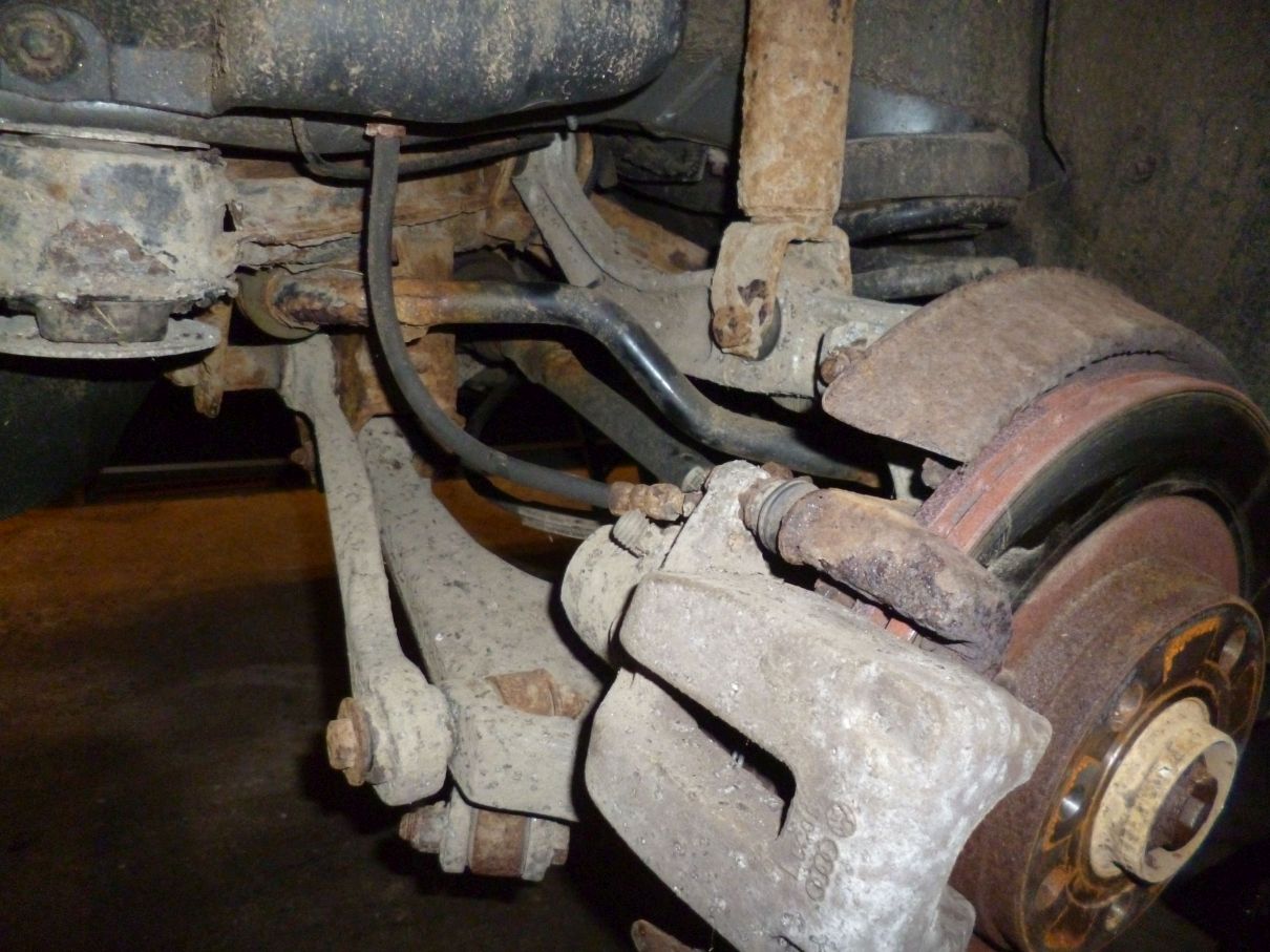

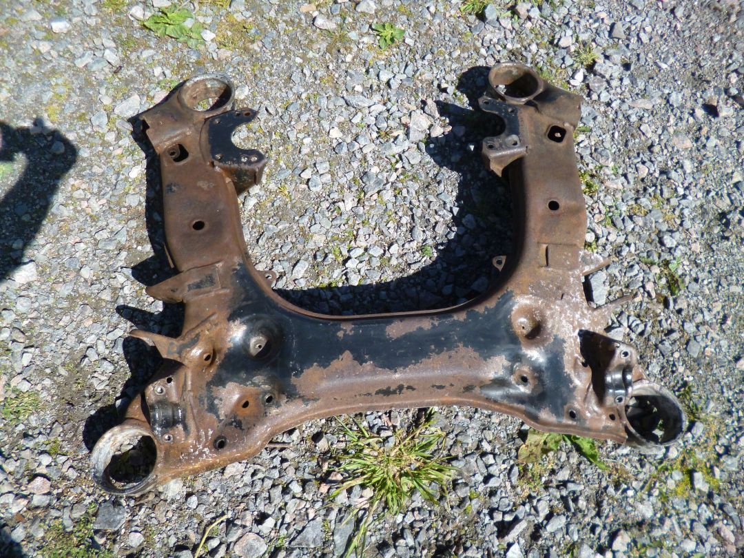

I am well underway with a rear subframe overhaul, and though I would post with some pictures of the progress and a few questions…
It was looking quite rough:
Attachment 27996
Attachment 27997
Attachment 27998

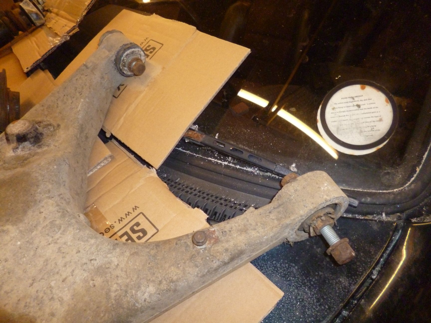

The process of stripping down has been generally been quite pleasant. The only real issues were some stubborn prop shaft bolts, a diff crossmember bolt seized in the bush (which had to be cut), a seized anti-roll bar drop link end (seized into the hub) and a very stiff n/s hand brake bracket bolt (the one done once the subframe has been lowered slightly).
I refurbished an A4 B5 (2.5 TDI quattro – what a lovely car that was) rear subframe a few years ago, and I seem to remember it being a real pain to dismantle!
I used some pictures from one of MikkiJayne’s old threads as a guide on what to strip off the subframe before lowering, and that worked very well, so thanks for that.
Attachment 27999
Attachment 28000

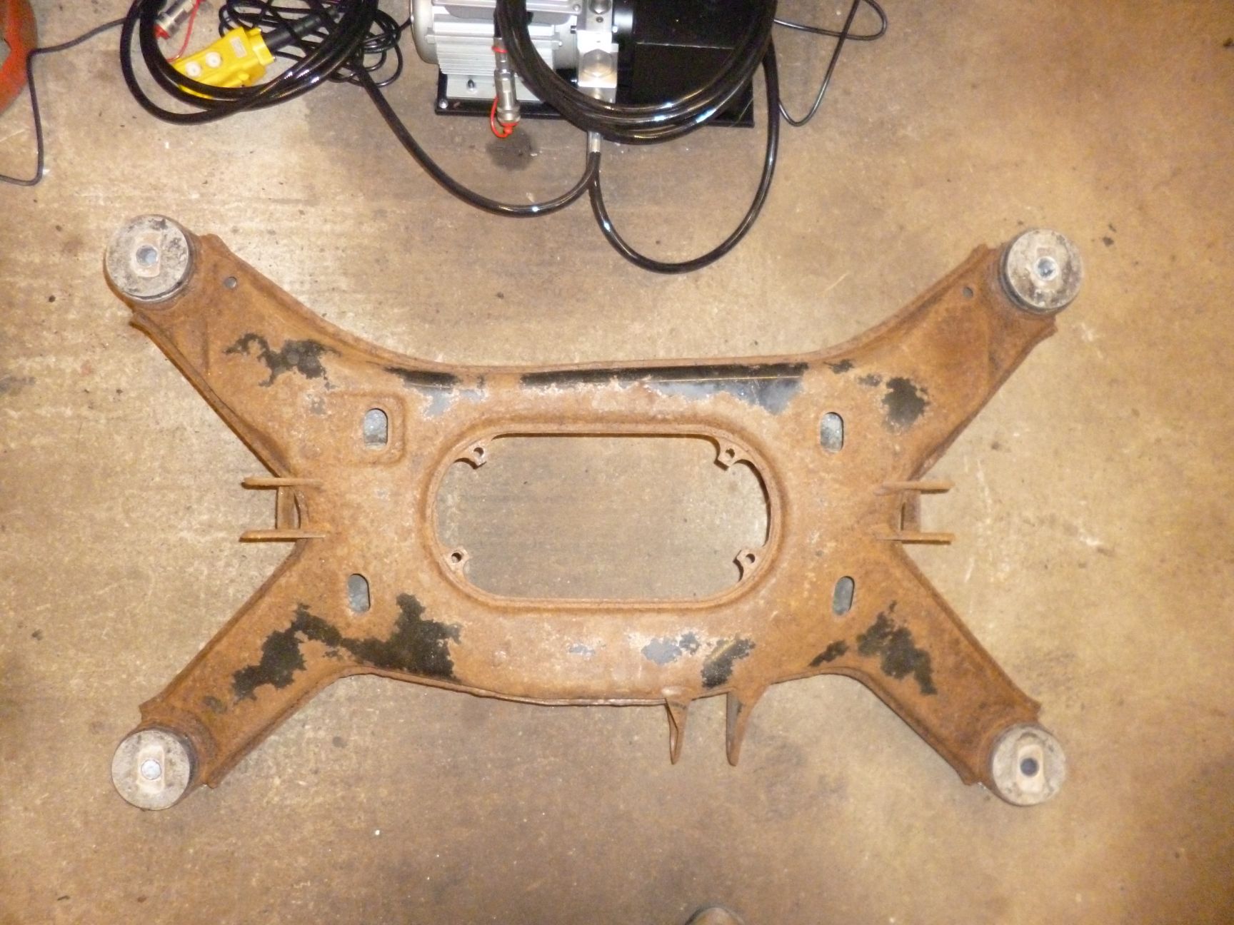

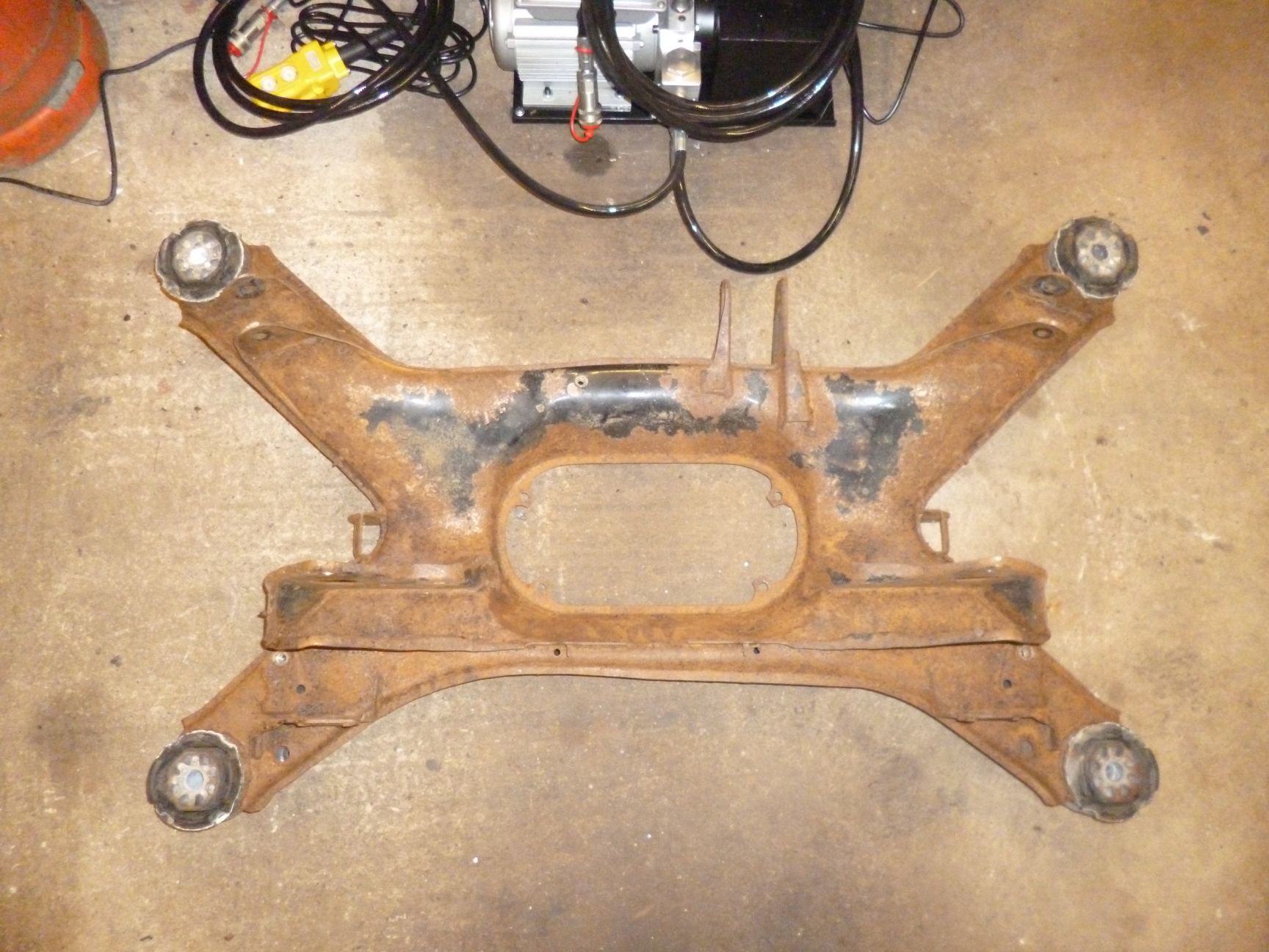

The subframe looked very crusty, as expected, but after spending a couple of hours with a needle gun it was looking not bad, and actually seems very solid. The eccentric bolts guides (? – the raised bits that hold them in place) were all in great nick, unlike the ones it the A4 one I did (which had mostly rusted away!). Maybe this car hasn’t spent all it life in Scotland!
Attachment 28008
Attachment 28007
Attachment 28009
I will give it a bit more of a clean, and then probably paint it (I have ordered some Rust-Oleum as per MikkiJayne’s recommendations that I have seen). I might look into getting it blasted and powder coated, but am not sure if this will be worth the extra cost? This may also depend on the subframe bushes…

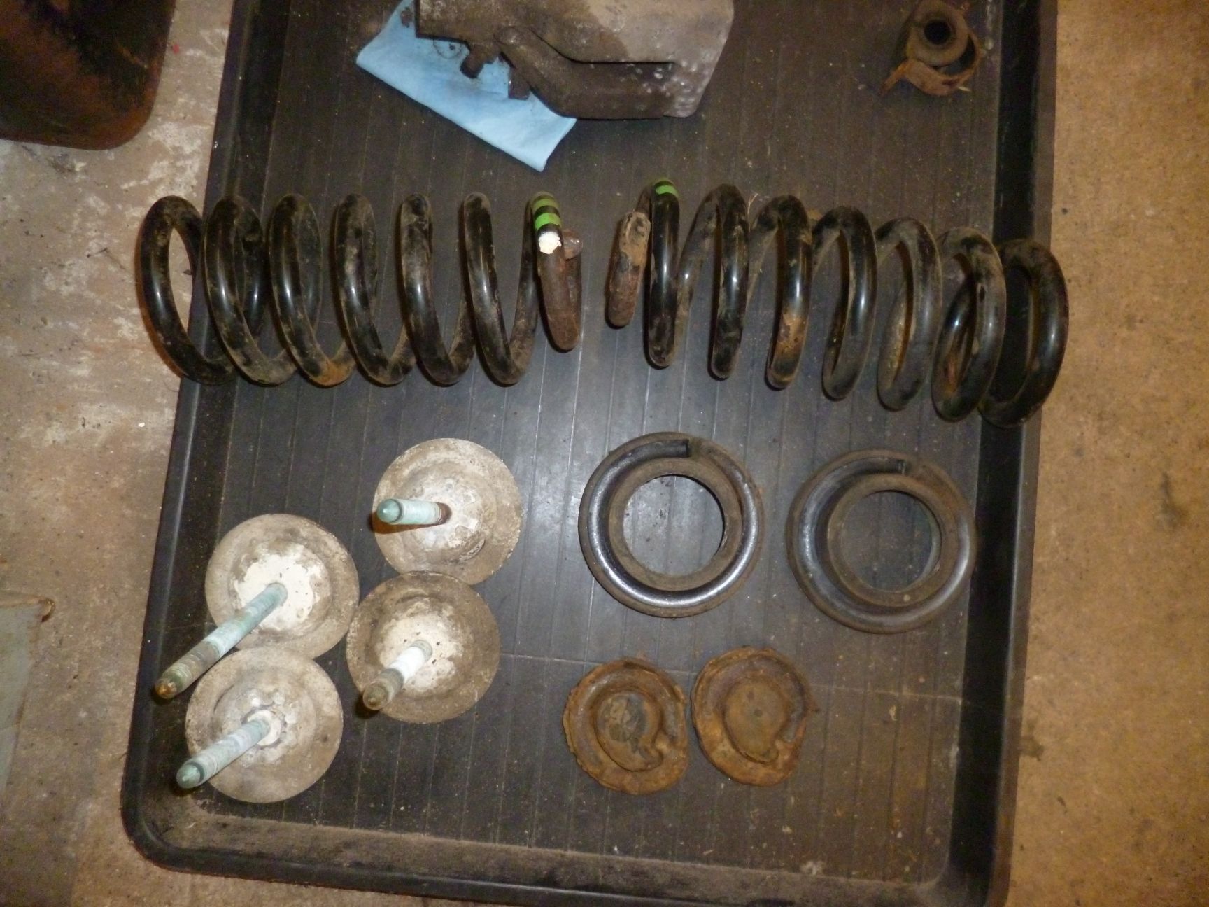

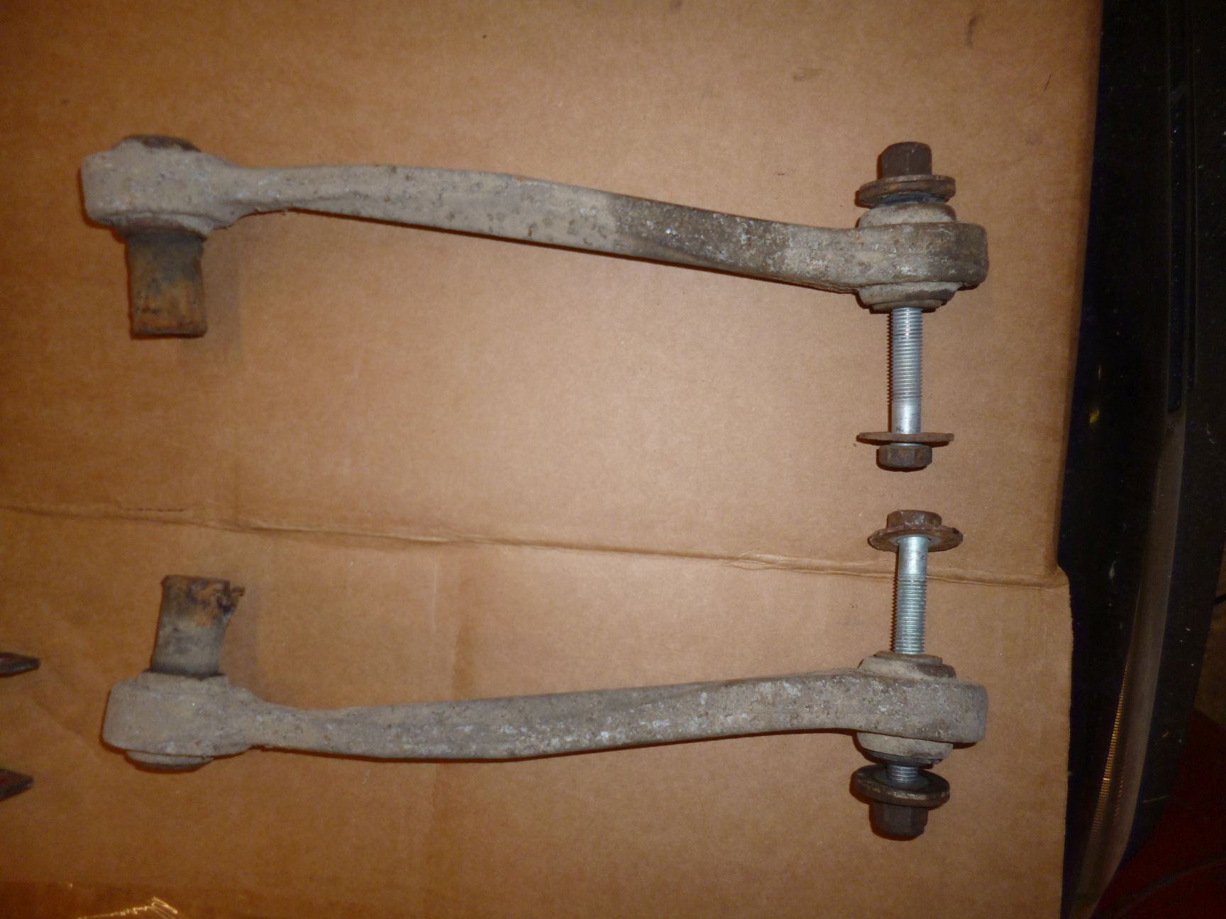

Other stripped parts:
Attachment 28001
Attachment 28002
Attachment 28003
Attachment 28011
Attachment 28004
Attachment 28005
Attachment 28010

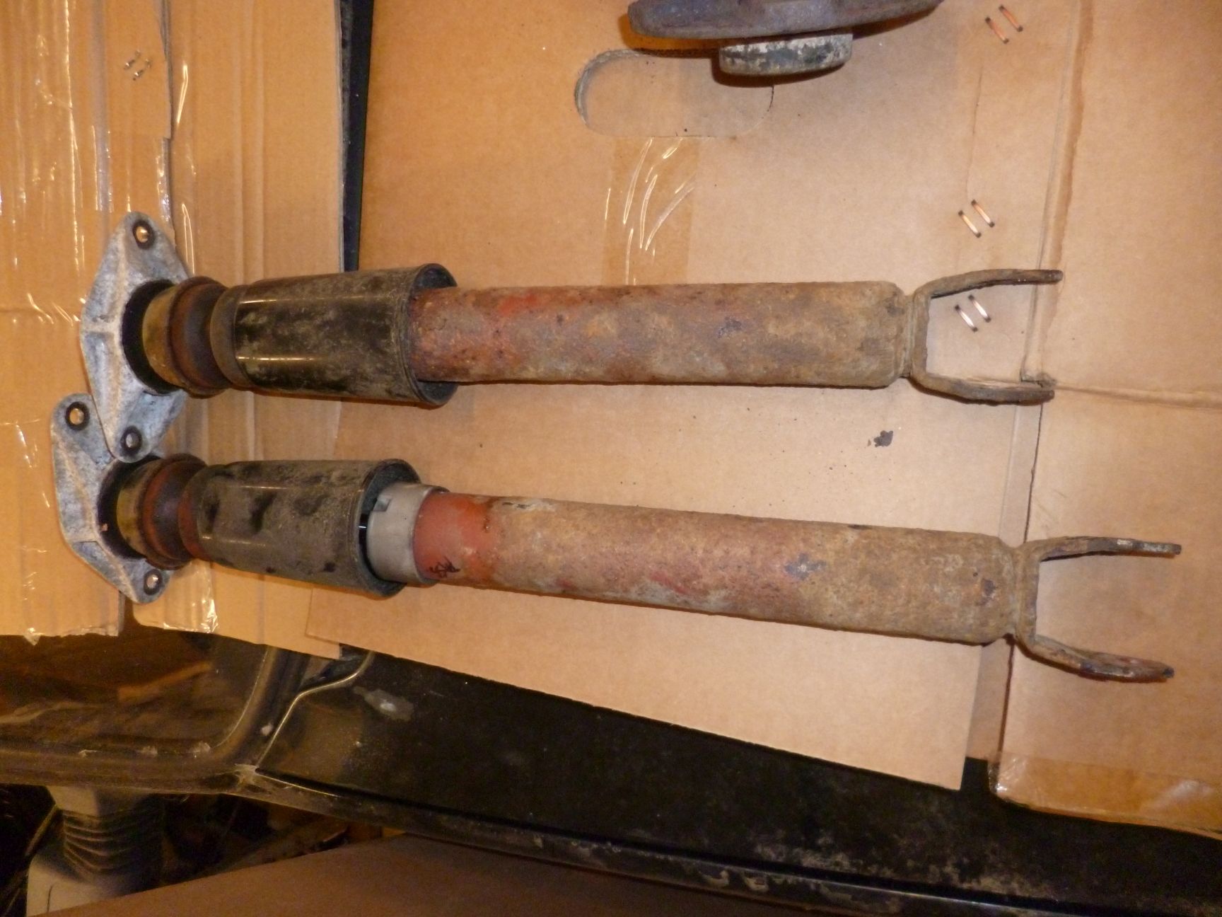

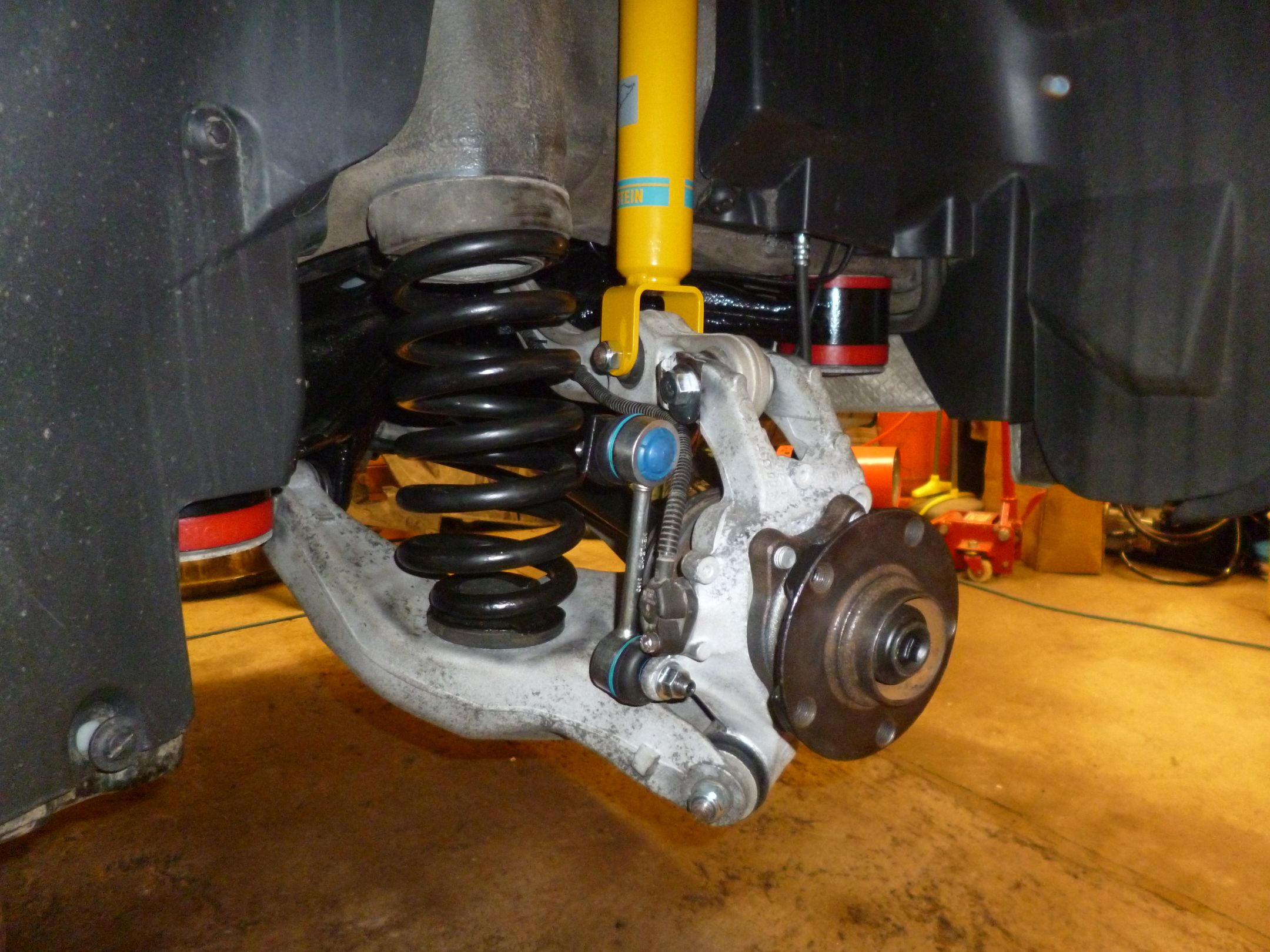

Shocks & Springs
So what does that leave? Well, shocks and springs…
The springs seem pretty good, though quite rusty at the very bottom. I think the shocks might be done though, however to be honest I don’t really have enough experience of testing them to be sure, as I am not sure how stiff they should be.
Attachment 28006
I have attached a video of me pushing and pulling them, which is easy enough with a couple of fingers – I would have assumed it would be harder than this?
If they do need replaced then the question is with what. The one thing I do not want to do is lower the car, and I don’t want it to be particularly stiffer – mainly because I live a long a track. I guess I could get some decent 2nd hand ones from the forum sponsors, or go for something like the Bilstein B6s (if these work with the standard springs; or even the full B12 kit if not, or if this would be a good thing to do anyway), as long as these don’t lower it etc. Or is there any other recommendation?

Given the lack of the main subframe bushes, I'd suggest sandblasting the subframe and painting it which is what I do with the fronts.
The OE shocks seem to last pretty well, and tbh there isn't really much in the way of alternatives. The Bilstein B6s should work with stock springs, although they are quite stiff. The B12 kit doesn't lower an S8 at all. It rides quite firmly but is acceptable on 20s, but is pretty expensive.

You note the Bilsteins ride okay on 20s – would they likely be okay on 18s too? I have a set of both, but haven’t really used the 20s yet (they have terrible tyres on them, and I have not got round to replacing them yet; I put good tyres on the 18s after getting them refurbed, and they also feel a bit safer with the potholed roads up here!).

I've been leaving the upper arm bushes alone. I dislike poly in suspension arms as it sucks at both ride comfort and longevity -I'd rather have used OE in this application than poly, until we can find an alternative source.
My experience of Bilsteins with 18s is that they are are very bouncy - think of an F1 car where the tyre does 90% of the suspension travel. This is, I'm sure, partially down to my Goodyear tyres which have very soft sidewalls, and so 20s make the suspension work better than 18s, but I've had B12 kits on a couple of other cars and they are always very firm. If you're running on 18s tbh I'd stick with the stock suspension. Big Red has 150k on stock suspension and rides and handles great.

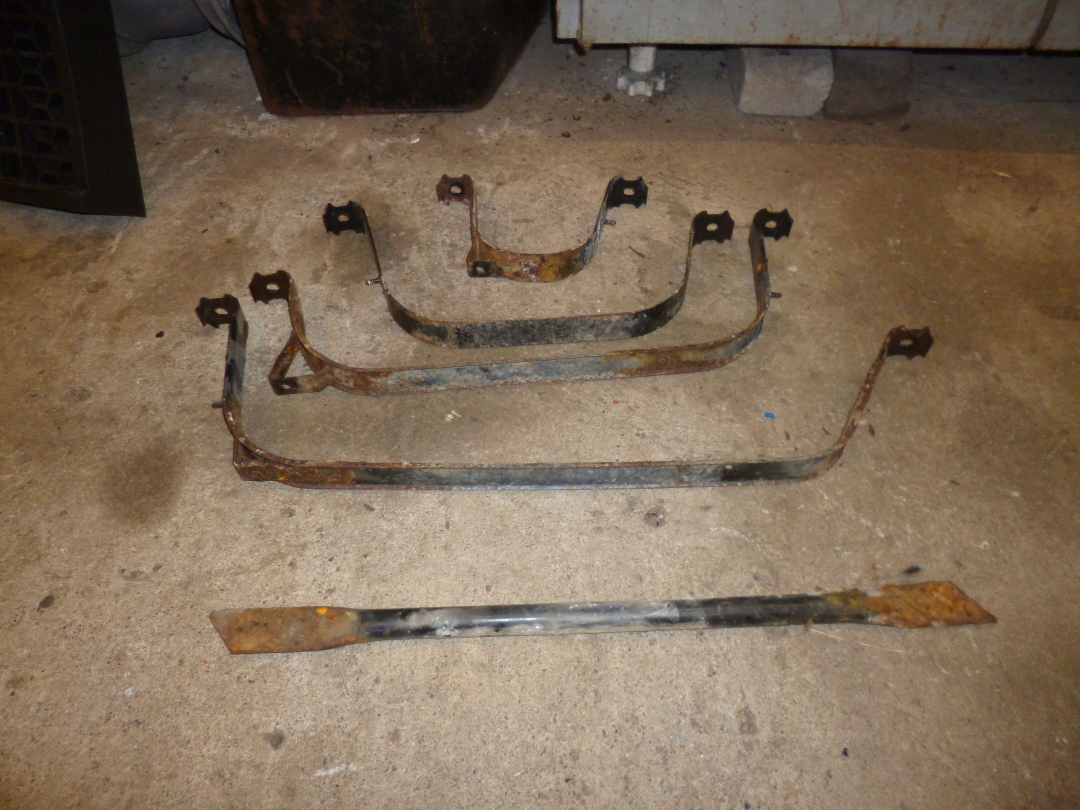

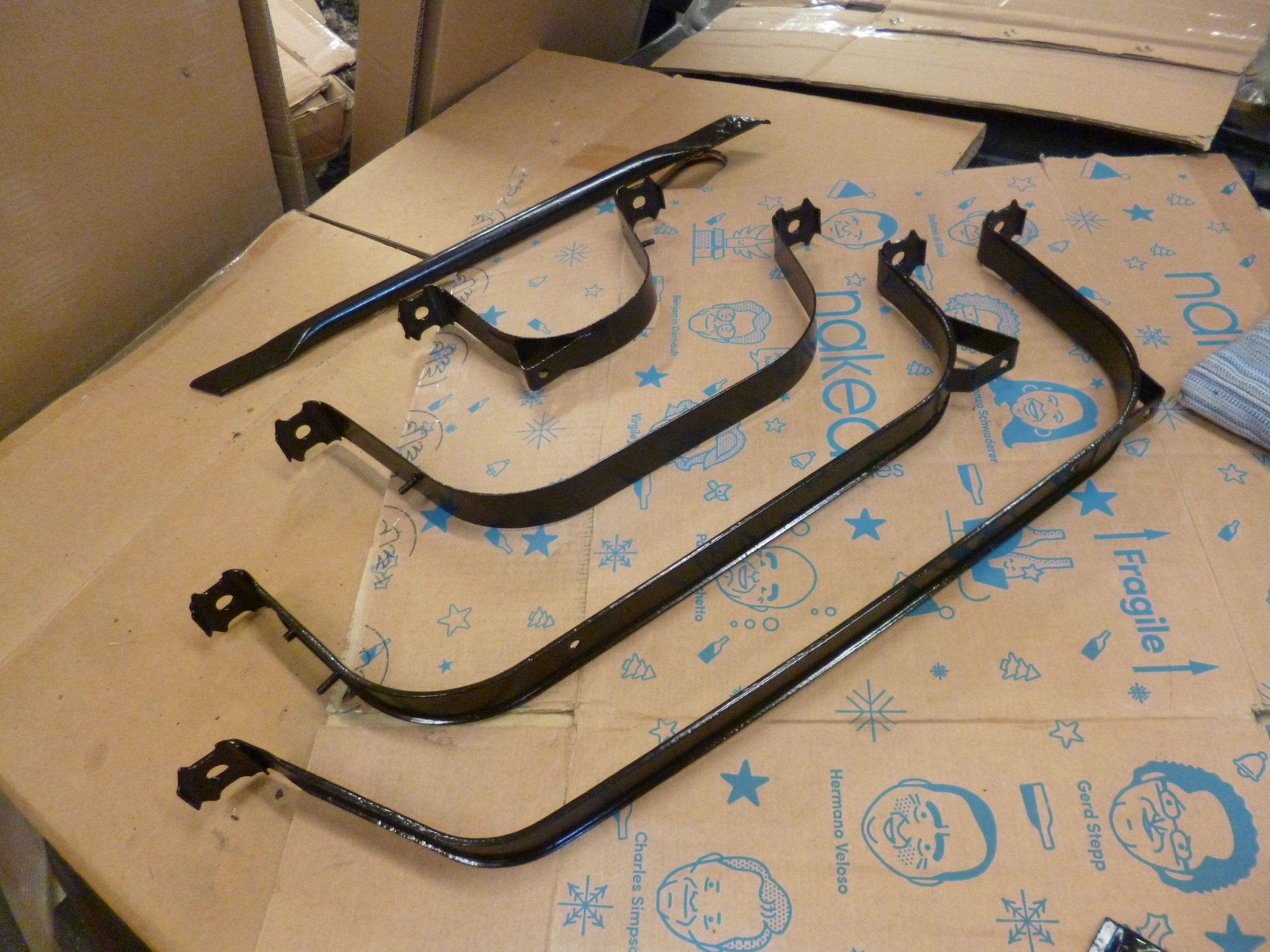

With the subframe out it's also a good idea to do the fuel tank straps

Ronin – I was looking a those, and the hose clamps to… they all look very crusty. Working on old cars is always like opening a can of worms… It would be mad not to do them at this point though. I have not looked at what the process for this will be yet – is it a tricky job…?
steamship 14th March 2022 04:18 PM
The following PDF gives details on the removal of the fuel tank. Not sure if it's possible to just replace the straps one by one with everything still in situ:
http://forum.a8parts.co.uk/attachmen...8&d=1420350463
MikkiJayne 14th March 2022 04:30 PM
I'm doing it right now :D Tips coming later +++

Thoughts and tips on the tank straps halfway down this post about the barnfind
TL;DR - clean up the threads on the tank strap studs with a spare nut, before loosening the main nuts. You do not want these studs to break out of the body and start spinning.

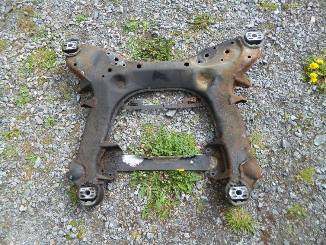

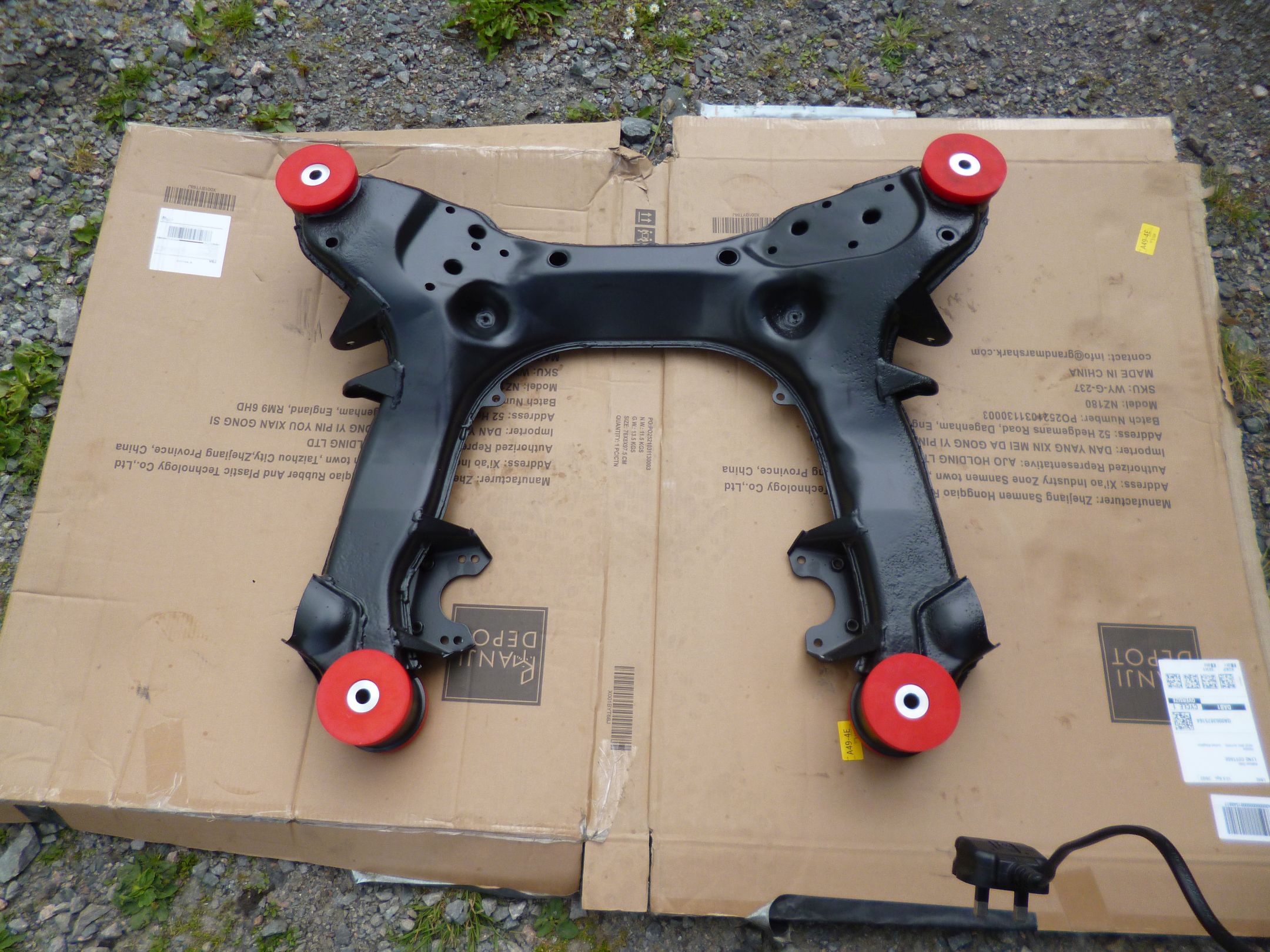

scottmgibb 21st March 2022 01:03 PM
1 Attachment(s)
Didn’t get much time on the car this weekend, but did get the subframe bushes out, and the new poly bush ones have already arrived – quick delivery (from Poland I thick), as I only ordered them last Wednesday!
Attachment 28070
Now that the subframe bushes are out, I have the option of powder coating. Is this generally considered better than just paining? I have a quote for £150 cash for blasting and powder coating, and might get them to do a few other wee bits too if I go-ahead with it.
Ronin – did you cover up any of the threads or holes when you had yours done? Looking at the pictures in your ‘Rear Subframe Refurb’ thread it looks like they have powder coated inside the subframe bush holes too. Did this all work out okay?
MikkiJayne 21st March 2022 01:18 PM
Powdercoating is faster, but better is entirely dependent on who is doing it. Powder tends to wick away from edges as it melts (the same as some paints do), so it takes some dialling in of the settings to get a decent coating on sharper edges. My local powdercoater does pay attention to this because I'm happy to pay extra for better results, whereas other places I've been to who are simply interested in throughput don't bother with this and very quickly the coating splits along all the sharp edges and simply peels off.
Another thing to bear in mind with powder is that it doesn't always get in to all the little spaces, because it is electrostatically attracted to the metal. It tends to coat around the little gaps and not go in to them, but with something as big and complicated as a subframe, the guy holding the gun is not going to be flipping it around and upside down to check all the nooks and crannies. I tend to go round stuff like this afterwards with a paintbrush and make sure there's no bare metal left in the corners etc.
Painting gives you full quality control over the job, but its messy and time consuming, especially at this time of year if you don't have a heated work space. Rustoleum for example needs more than 24hr to dry at current temperatures, and really needs a good week to cure.
I went round the inside of the bush holes with a drum sander and made sure it was nice and smooth, but the thickness of the powder wasn't a problem for the D3 bushes. I'm sure it won't be for poly since thats flexible anyway.

scottmgibb 25th March 2022 05:33 PM
Thanks for the comment on powder coating!
I have been thinking about this quite a lot, and I think I am going to go with the painting option. Mikki’s comments about quality being dependent on who is doing it backed up my own concerns, as I really do not know what any of the local companies are like.
They are also all quite far away, requiring a min 1.5h round trip to drop of and then collect.

Not as much as I would like unfortunately! It was always going to be slow progress…
The subframe is now away to get blasted and painted. Meanwhile I have started removing the old bushes and cleaning up and painting the various rusty parts.
I bought a small pressurized sand blasting pot to use outside and that has been very useful for smaller parts. Don’t fancy doing the whole subframe myself though – and I don’t think my (smallish) compressor would thank me for it either!
Next is fitting the new bushes and getting everything ready to re-fit. I will be addressing the fuel tank straps and the brake pipes before refitting the subframe though. I also need to get the calipers off for refurbishing at my local-ish brake specialist too.

I also replaced all the bushes in the arms and hub carrier over the weekend. They all went in perfectly except one of the upper control arm bushes, which collapsed ☹. A different bush went in the hole no bother, so not sure what went wrong. I have ordered another and fortunately they are not too expensive…
Reassembly beckons, but while I wait for some final bits and dwell on what to do with the shocks (I am leaning towards getting the Bilstein B6 with the standard springs) I am going to take of the front subframe and get it blasted and painted too…

The front subframe is now off and away to get blasted and painted (along with the front springs). It cleaned up well with the needle gun and looks solid enough, but we will see if the blasting picks up any issues.

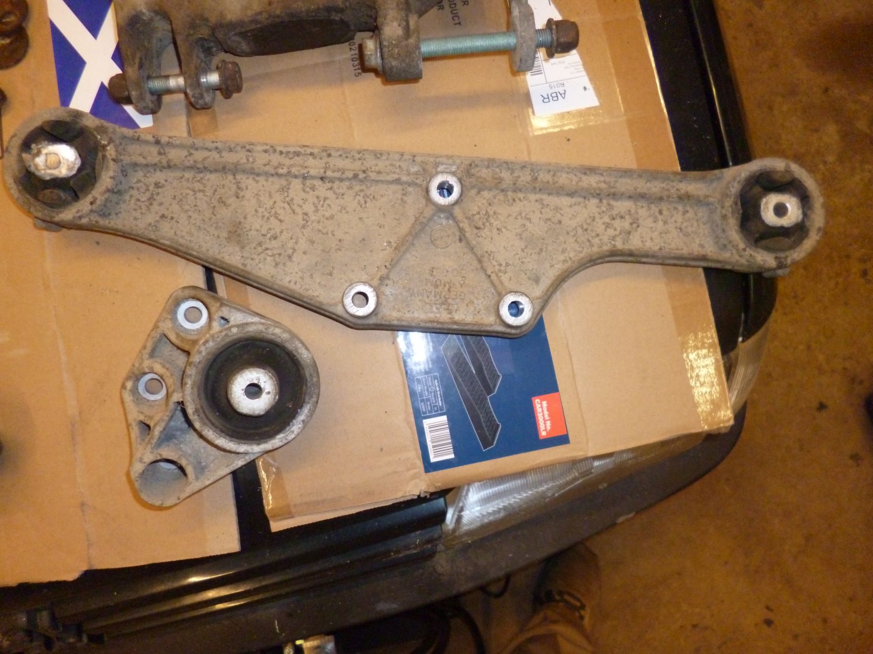

So I am now looking at the final(ish) items I still need to get for the rebuild. There are a few mounts/bushes and bolts which I am unsure whether or not are worth replacing, and thought I would see if anyone had any thoughts on this 😊 (for reference, the car has about 123K on it, and I assume these are all still original bits).
• Top mounts and ‘rubber buffers’ for both the front and rear shocks. These all seem in pretty good condition, but I obviously don’t have new ones to compare with. Are these typically worth replacing? Front mounts seem pretty cheap and available, but rears might be hard to get/expensive? The buffers look fairly cheap.
• Engine and gearbox mounts. How do you know if these need replaced? They look intact, but are reasonably ‘flexible’. Do they typically ‘go’? Availability seems to be questionable.
• Subframe bolts – do people typically use new ones when refitting? Are these stretch bolts? An online search suggests they are not particularly available, but I have not spoken with Audi/TPS yet.
I have also been wondering if there is anything else that I should be looking at while the subframe and front suspension is all out? I am changing both the output seals as they are both leaking (the left side badly). Is there any known issues that are worth addressing?
Thnaks, and sorry for all the questions!
MikkiJayne 27th May 2022 08:37 AM
Front top mounts are cheap and available from Febi. Rears are NLA as far as I know.
Engine and gearbox mounts are NLA. They settle slightly but rarely fail.
Subframe bolts get reused. They are technically stretch bolts (150Nm + 90) and the manual says to replace them but I never have. They're used on the D3 so should still be available if you do want to replace them. N 90711602

The blasting of the front subframe revealed no further issues and it looked great all newly painted with the new bushes. I got the front springs blasted and painted at the same time and rebuilt the struts with the new Bilstein dampers (but forgot to take pics).
Attachment 28995
The front subframe went back on first while I waited for the final bits for the rear (thanks for these MJ!), and then it was its turn. I left most of the bits to be fitted once it was installed on the car, as I had to lift it up with a jack while balancing it and getting the bolts in, and I though the less weigh the better... MJ made some 3D printed alignment spacers to fit the polybush holes (which are smaller than the original ones) which worked a treat for aligning it.
Attachment 28996 Attachment 28997 Attachment 28998

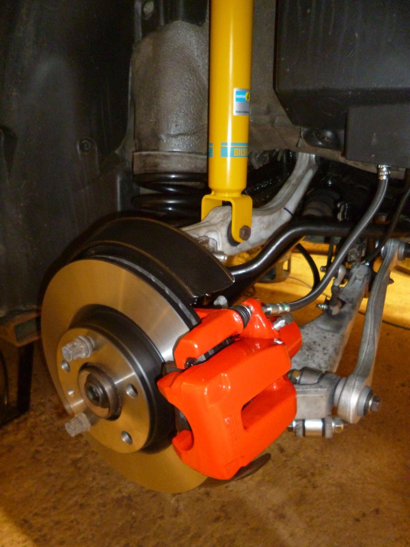

After all the suspension bits were re-fitted I was able to lower the car off the lifts and properly remove the plastic covers in front of the rear wheels. The bolts all had to be cut away as the u-clips holding them had all disintegrated and were just spinning. There was an interesting amount of dirt on these…

Next it was onto removing all the fuel tank straps and blasting and painting them, along with the exhaust and handbrake brackets. Following MJ’s notes in one of her last WITWs, the nuts for the straps came off with no problem, so thanks for that!

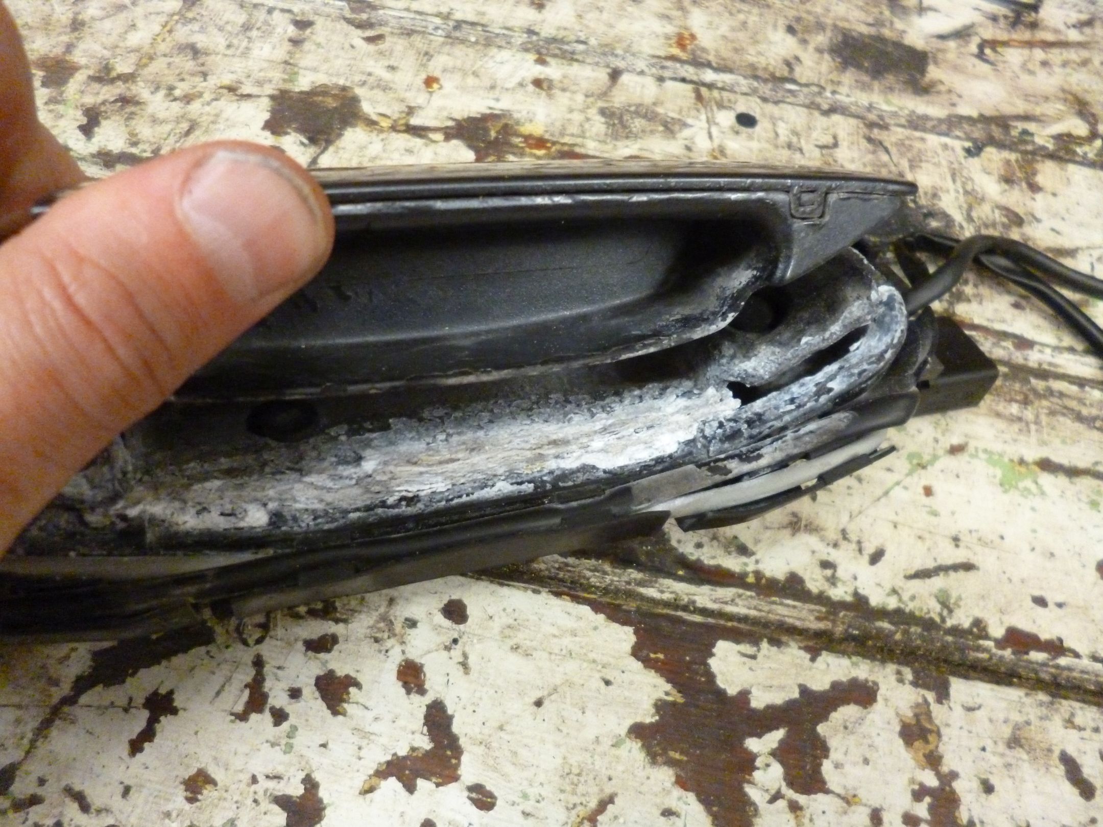

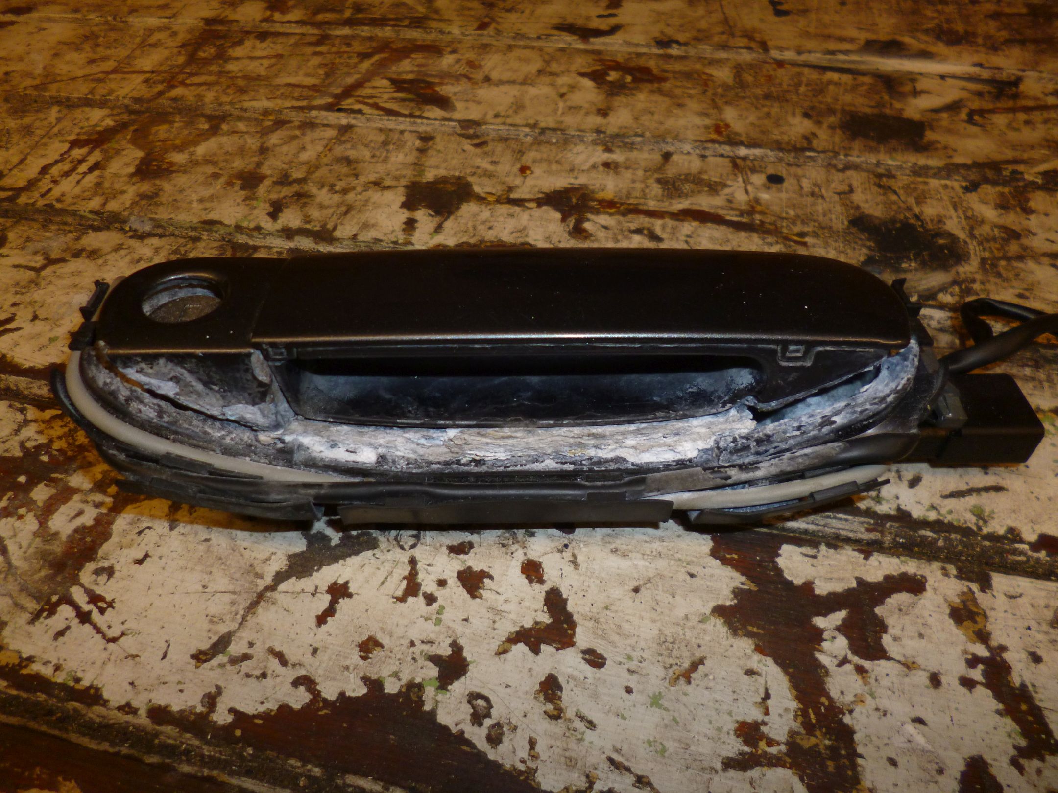

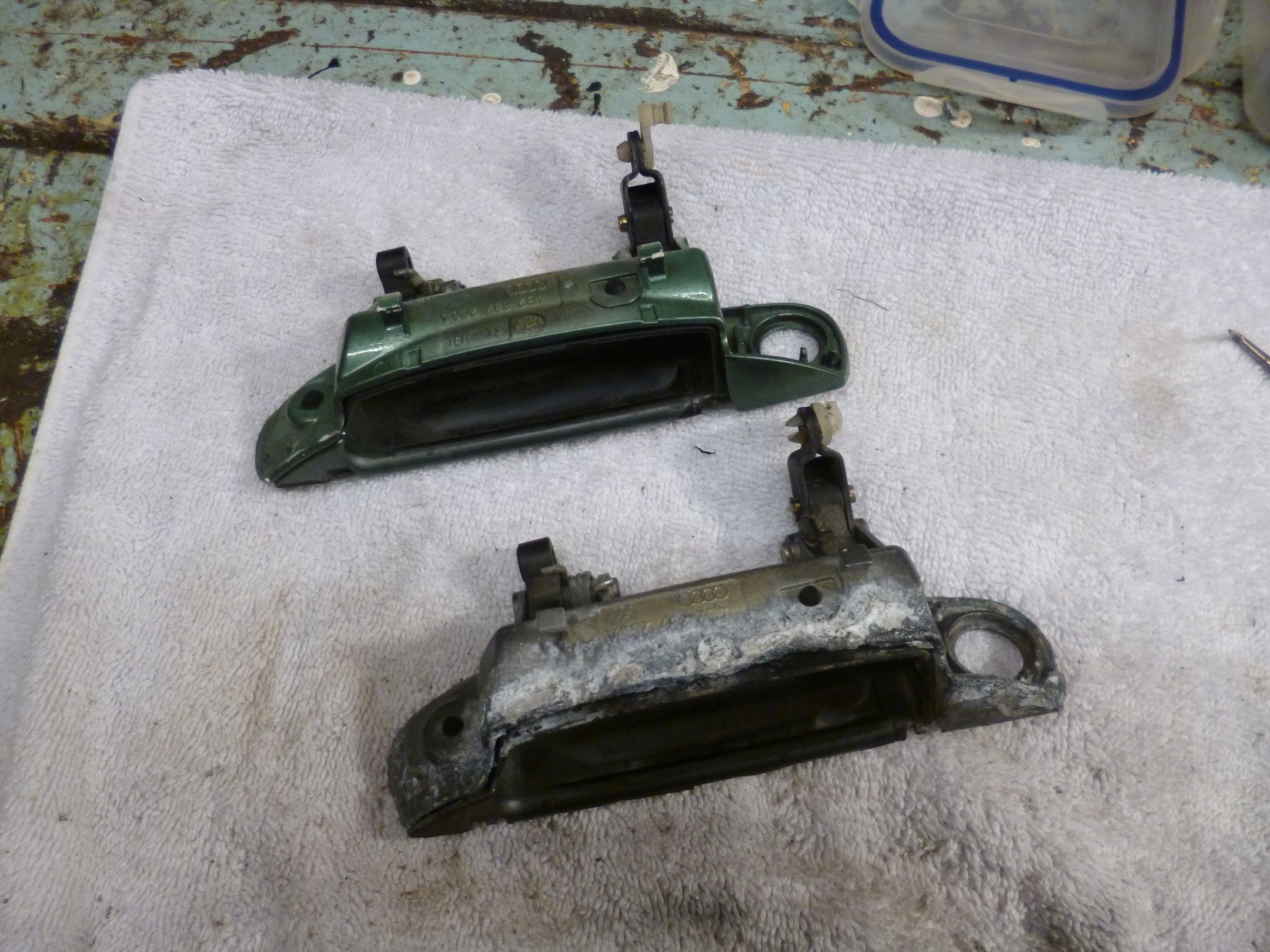

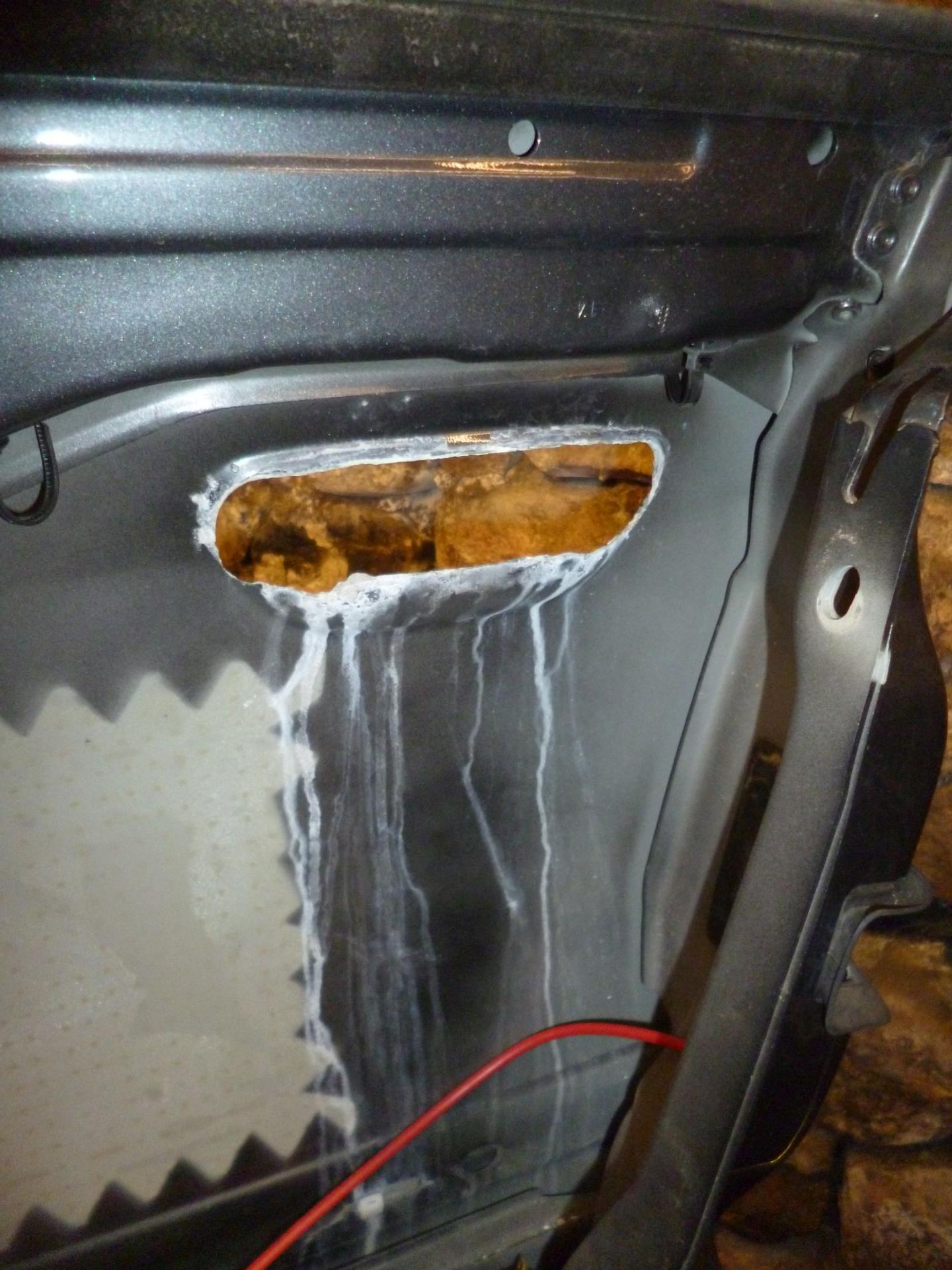

The next big job was a weird one. The driver’s door handle has always been corroded around the handle, but it was starting to get really bad, with the handle feeling a bit loose and stains running down the door…
I got a replacement frame from Prestige in the correct colour (which thankfully matches very well) and went about stripping down the door, which as has been reported elsewhere, is a fairly major task. When it came to removing the handle, once everything was disconnected it just pushed through the frame in one piece – no need to separate the parts!
Attachment 29002 Attachment 29003 Attachment 29004
I had assumed it was just the frame that was corroded, but it turned out that the middle part of the handle was also in very bad shape, so it was back to Prestige for a handle, which fortunately they had. It was green, so I got my dad to spray the visible bits (mainly just the lock cover) to Dolphin Grey.
Attachment 29005 Attachment 29006
Then it was just a mater of (not so) quickly putting everything back together…
Then it was brake bleed time. I did a pressure brake bleed (2bar) but still had spongy brakes. It turned out that one of the (newly refurbished) rear calipers was retracting too much. I suspect the new seal was still a bit tight. I extended out the piston, left it a while and then retracted it to just the right point, re-bled just to make sure, and tested it again. Still a bit spongy. So I then bled the abs pump. This released quite a few bubbles and resulted in a much better peddle feel. Finally I fitted Mikki’s lovely looking brake block. The brakes now feel progressive and reassuring, which is something I have never been able to say before!
