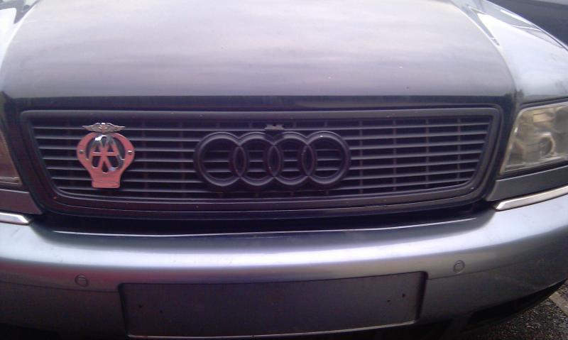

Conan_the_Librarian 19th July 2011 07:28 PM
1 Attachment(s)
Originally Posted by Architex_mA8tey (Post 25043)
Anyone got a pic of the gap showing the FL bumper on a PF car?
Here you go...............
http://forum.a8parts.co.uk/attachmen...1&d=1311103680

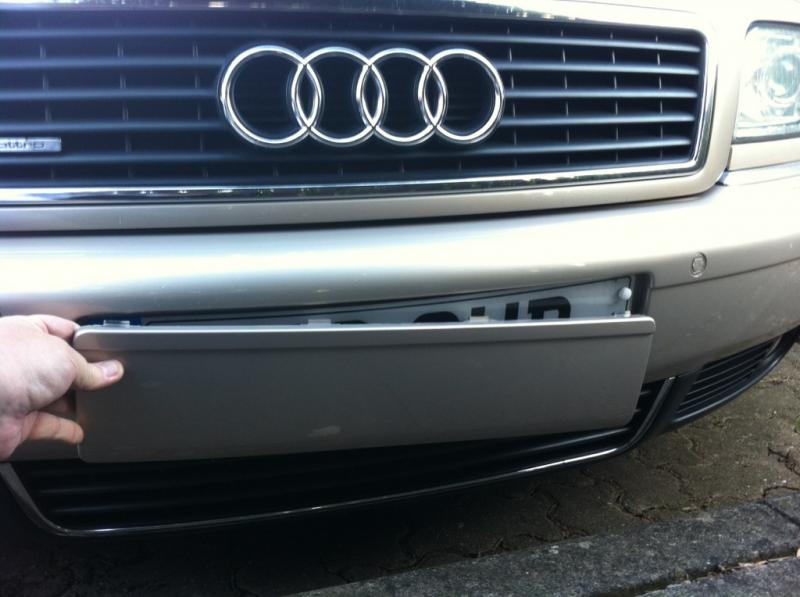

Architex_mA8tey 19th July 2011 08:42 PM
1 Attachment(s)
lol thanks Mike - the Projekt car lives!! it doesnt show as much when its all black :rolleyes:
someone should look to making an aftermarket "infill piece" im sure they would sell a few, perhaps coloured the same as the bumper, or chrome
also you need one of these mike for that car -
http://forum.a8parts.co.uk/attachmen...1&d=1311108937
