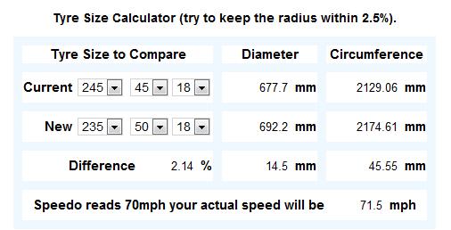

Architex_mA8tey 8th October 2011 04:12 PM
1 Attachment(s)
Originally Posted by HPsauce (Post 27788)
Thanks. I'd already looked at Camskill and everything was out of stock.
Missed those Toyos somehow, I think 235/50 is very close to 245/45 in overall diameter so wouldn't be a problem.
should be ok -
http://forum.a8parts.co.uk/attachmen...1&d=1318090352
