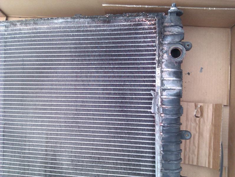

B@fink 8th July 2011 09:45 PM
1 Attachment(s)
And as a bit of tragic evidence to it's untimely demise....
http://forum.a8parts.co.uk/attachmen...1&d=1310161193
Strangely the expanding pool of coolant that started this adventure was coming out from the other side of the car to the leak! :rolleyes:
