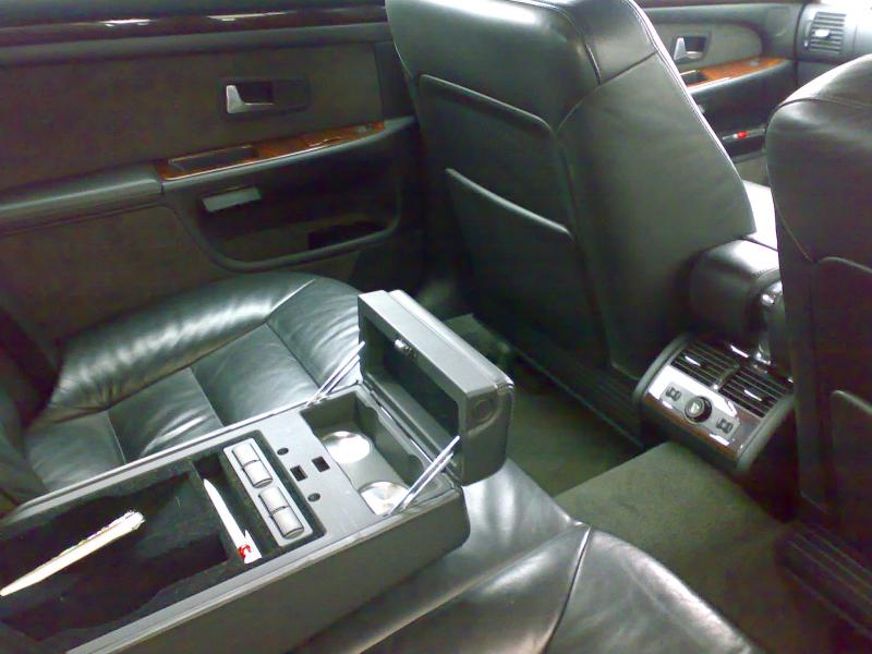

IT 23rd February 2012 07:50 PM
1 Attachment(s)
Originally Posted by notorious (Post 34534)
Nice stuff, but I didn't see picture of the arm rest with the 4 buttons mentioned.
Someone who has seen those arm rests in flesh: is it sposdible to transplant just the buttons and supporting electronics from arm rest with buttons to armrest without buttons?
Having raided the a8parts archives, I have found this which might help. You can see its a whole different insert, and in these models the first aid kit is relocated to the boot. I had the same ideas as you about a transplant, but its firmly in there. Maybe Elsawin will reveal how it comes apart. I considered also transplanting the whole armrest unit, however the LWB rear backrest is wider and sits at a more reclined angle than the normal seats, so the armrest would maybe not fit.....
http://forum.a8parts.co.uk/attachmen...1&d=1330030152
notorious 23rd February 2012 08:13 PM
Thank you for this Ian. Excellent picture. Will do more digging.

71camaro 24th February 2012 01:39 AM
Based on that photograph I'm inclined to believe that a retrofit is possible, albeit a bit more difficult than simply undoing a couple screws. I'm down to give it a go though, I'm not sure I'm in need of a first aid kit, that's what emergency services is for. Any idea if this was also a US spec option?
