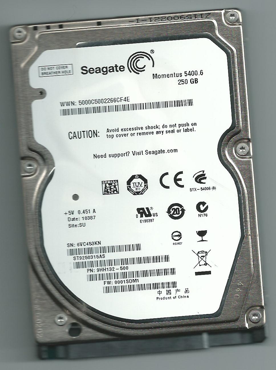

Conan_the_Librarian 29th January 2013 11:06 AM
1 Attachment(s)
Originally Posted by roboblob (Post 52660)
Can you tell me what is the drive make and model number is ,I may have a working cct board , I have a very large collection of 2.5" drives that have mostly just started to fail and bringing up SMART errors so the electronics are good.
Thanks,
Here is the 2 barcodes on it
PK1H01005795059AU3370H3U0DEHAA00UC006000000
PK1H0
here is a scan of the disk info
http://forum.a8parts.co.uk/attachmen...1&d=1359461174
IT 29th January 2013 11:18 AM
Cool.
Model no is ST9250315AS - Loads on Ebay circa £40. Including faulty ones :(
I share HPSauces reservations about swapping electrickery over - It used to work in the good old days when discs were really dumb and just held data, but now the discs themselves hold info about their own config, its a bit more of a minefield.
Lets start by seeing what is readable 'as-is', and take it from there.
