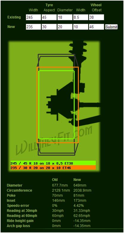

Architex_mA8tey 25th March 2013 10:53 PM
1 Attachment(s)
I'm guessing your existing wheels' ET plus your new ones but heres my best guess at where a straight swap will come out -
http://forum.a8parts.co.uk/attachmen...1&d=1364255513
stig1983 26th March 2013 10:14 AM
What website did you use for this? Thanks
David's8 26th March 2013 10:17 AM
ummm. suggest "www.willtheyfit.com". (Its printed across the picture ;) )
Architex_mA8tey 26th March 2013 10:26 AM
that'll be it! Ignore the suspension shown on the drawing its only to show the side that it is on rather than the position itself although the 2 lots of wheels and tyres will be spot on - the new wheels will project 11mm out more than the old ones and 27mm more inwards, and that could be your problem

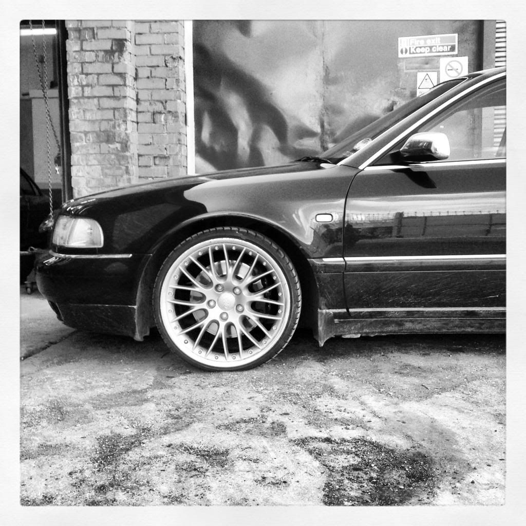

stig1983 29th March 2013 06:25 PM
They fit, no rubbing and no catching the suspension arms. Happy days, now to by some tyres :)
http://i1147.photobucket.com/albums/...ps0fc65fe1.jpg

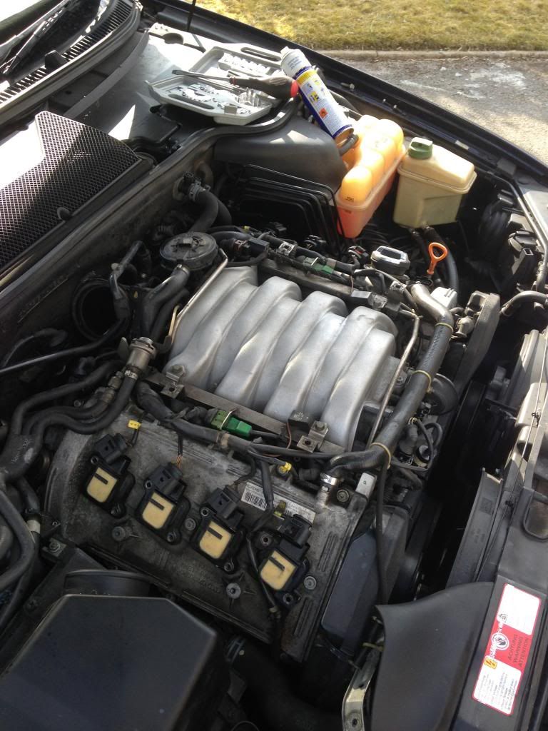

While I was at it i dropped the oil and changed filter, changed spark plugs and air filter.
http://i1147.photobucket.com/albums/...ps081fceeb.jpg
