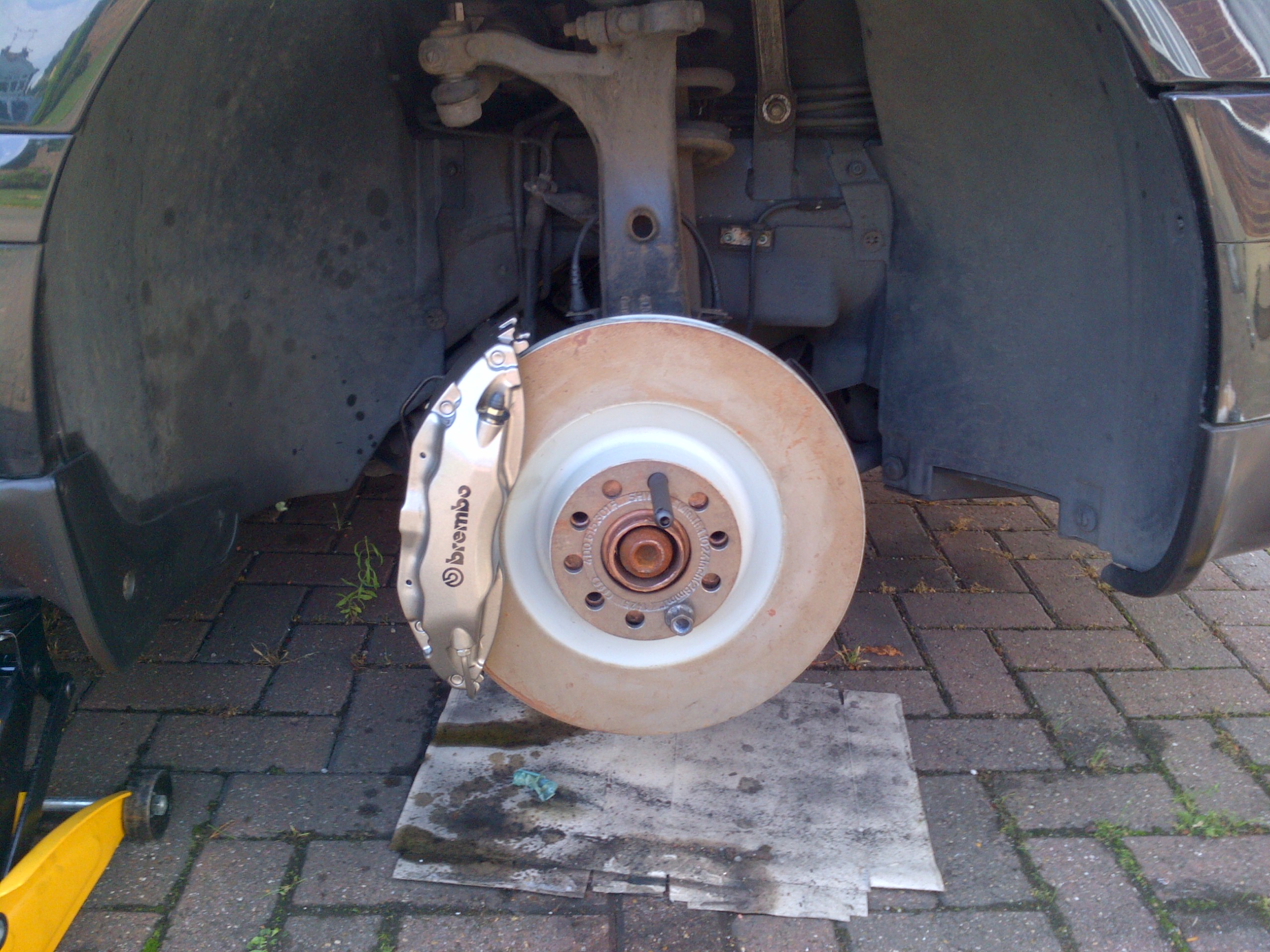

Zip 15th July 2013 04:05 PM
1 Attachment(s)
They're out! All quite straight forward in the end. Ended up with a couple of fingers off a silicone glove secured with a nice tight O-ring over the end of each pipe to stop weeping. I've got a Gunson Eazibleed which I have used a few times for reassembly time.
Unfortunately the end of the section of metal pipe from calliper to bracket moved slightly at the bracket end when I was removing it, and there appears to be a very small weep....hmmmm. Will have another look when I give everything a good clean later in the week.
If you're lucky, you may get a photo of the finished articles when I get them back. Got all new disc and pads all round to fit at the weekend (used Murray's Direct in Hatfield - nice bloke).
Meanwhile, spot the missing part...
Attachment 6384
I tell you what, trying to relocate a wheel and disc with no calliper in place ain't easy in this heat....:(

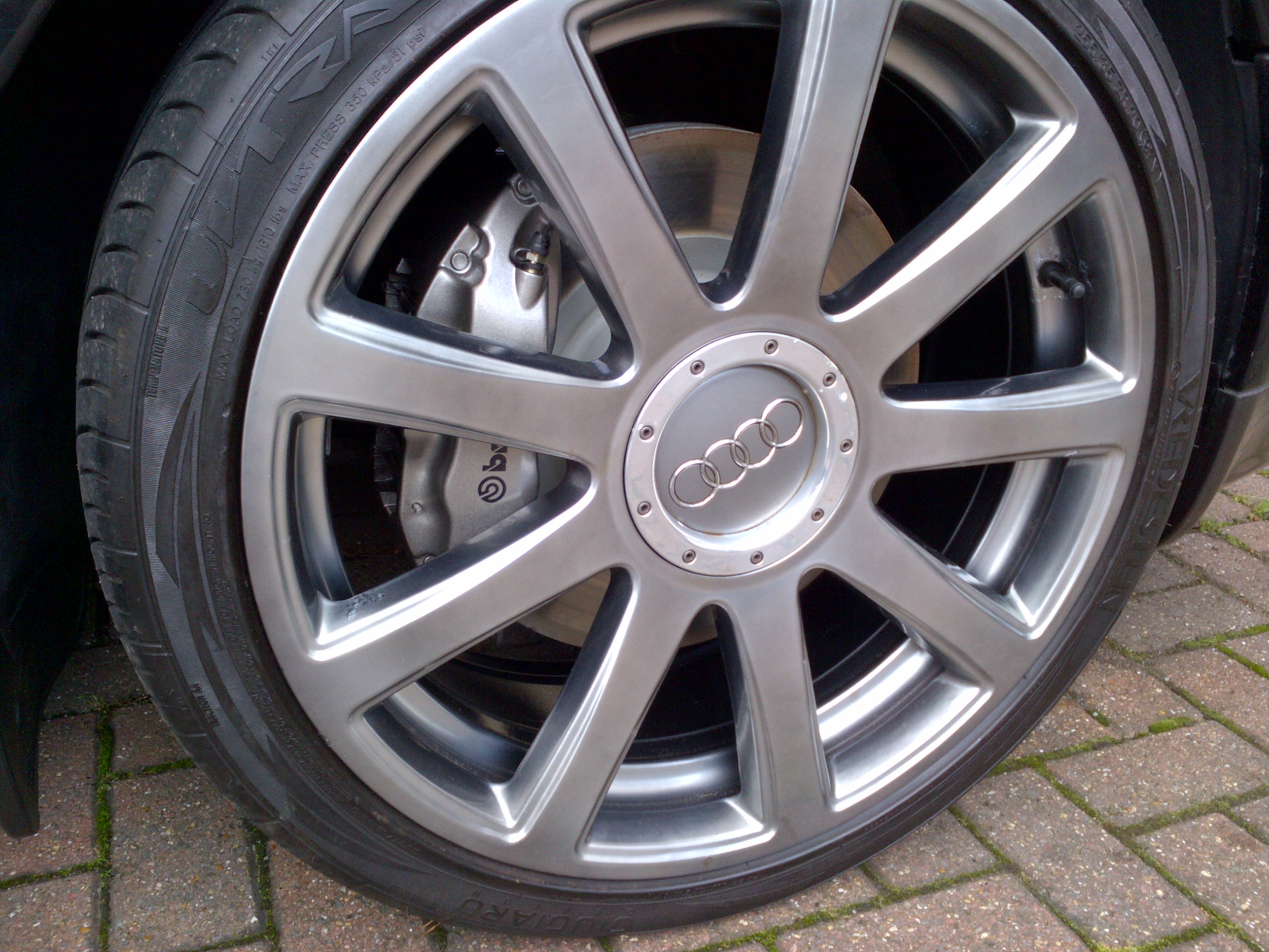

2 Attachment(s)
Pretty pictures...
Attachment 6578
Attachment 6579
Zip
