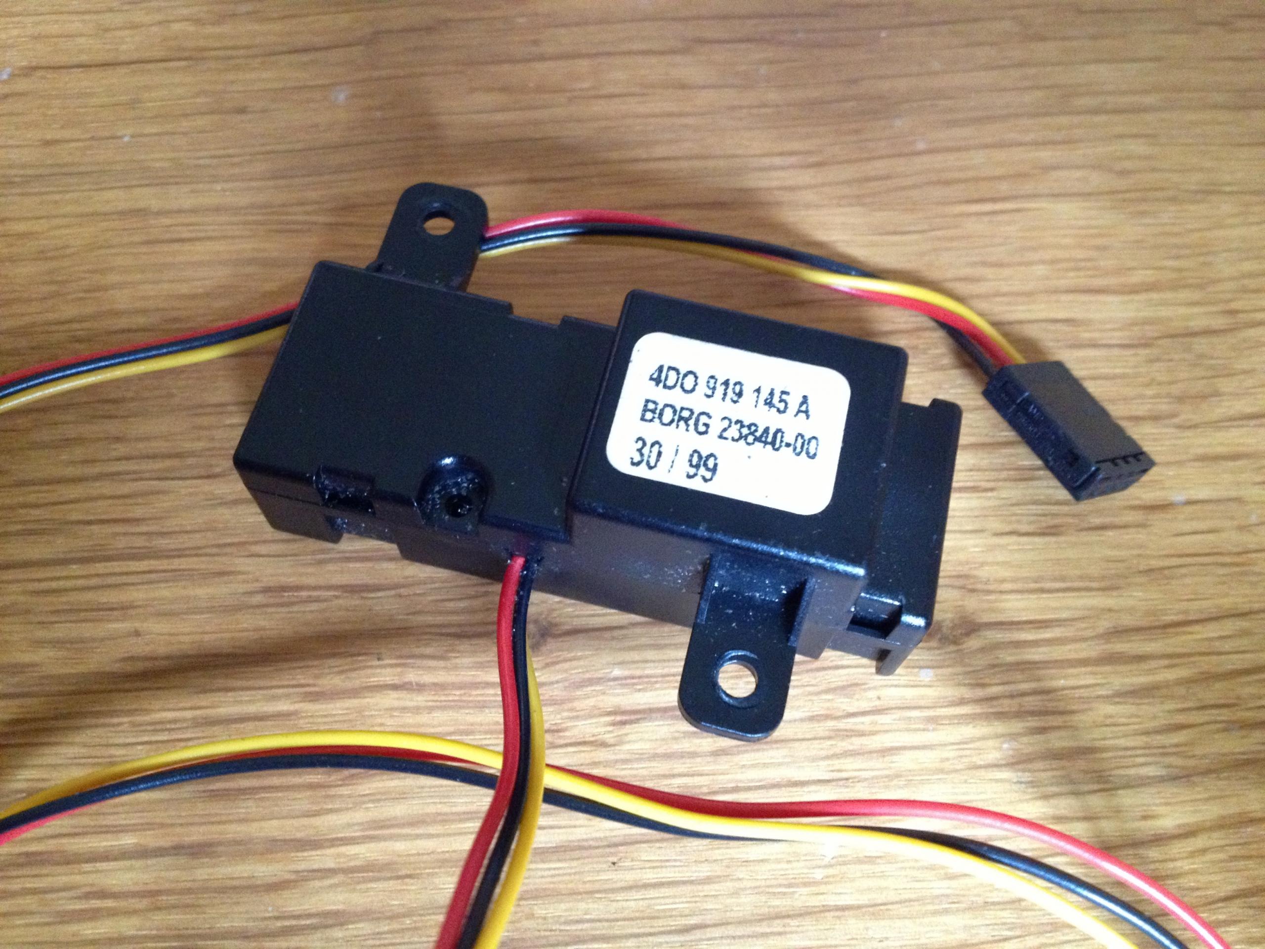

notorious 6th September 2013 11:44 AM
For D2: (have no idea about D3 -- just use ETKA)
4D0 919 145 -- for D2 chassis number up to 4D-X-015 000
4D0 919 145 A -- for D2 chassis number after F 4D-Y-000 001 <-- I've got this one
There are receivers for other Audi models, but I think the only difference is the length of cable supplied and shape of plastic box. I believe they all work the same way. For instance, we have 8N0 919 145 receiver from Audi TT and it looks like this:
http://www.vagcom.org/wp-content/upl...k-module-1.jpg
Bracket and bolts for D2 if you need them:
1 x 4D1 919 159 bracket
1 x N 013 96 49 screw to fix bracket to chassis
2 x N 013 95 32 screws to fix receiver to bracket or to recess behind the instrument cluster
>> Are these common enough bits to find on German ebay, if it was more or less standard fit across the '8 range on the Continent?
I think all A8s supplied to countries in CET time zone (see the map in my first post) had this receiver installed as standard.
P.S. If you want to search German ebay just type "Audi Funkuhrmodul" or "Audi Funkuhr".
You need the version with wire coming out of it which ends with 4 pin electric connector.

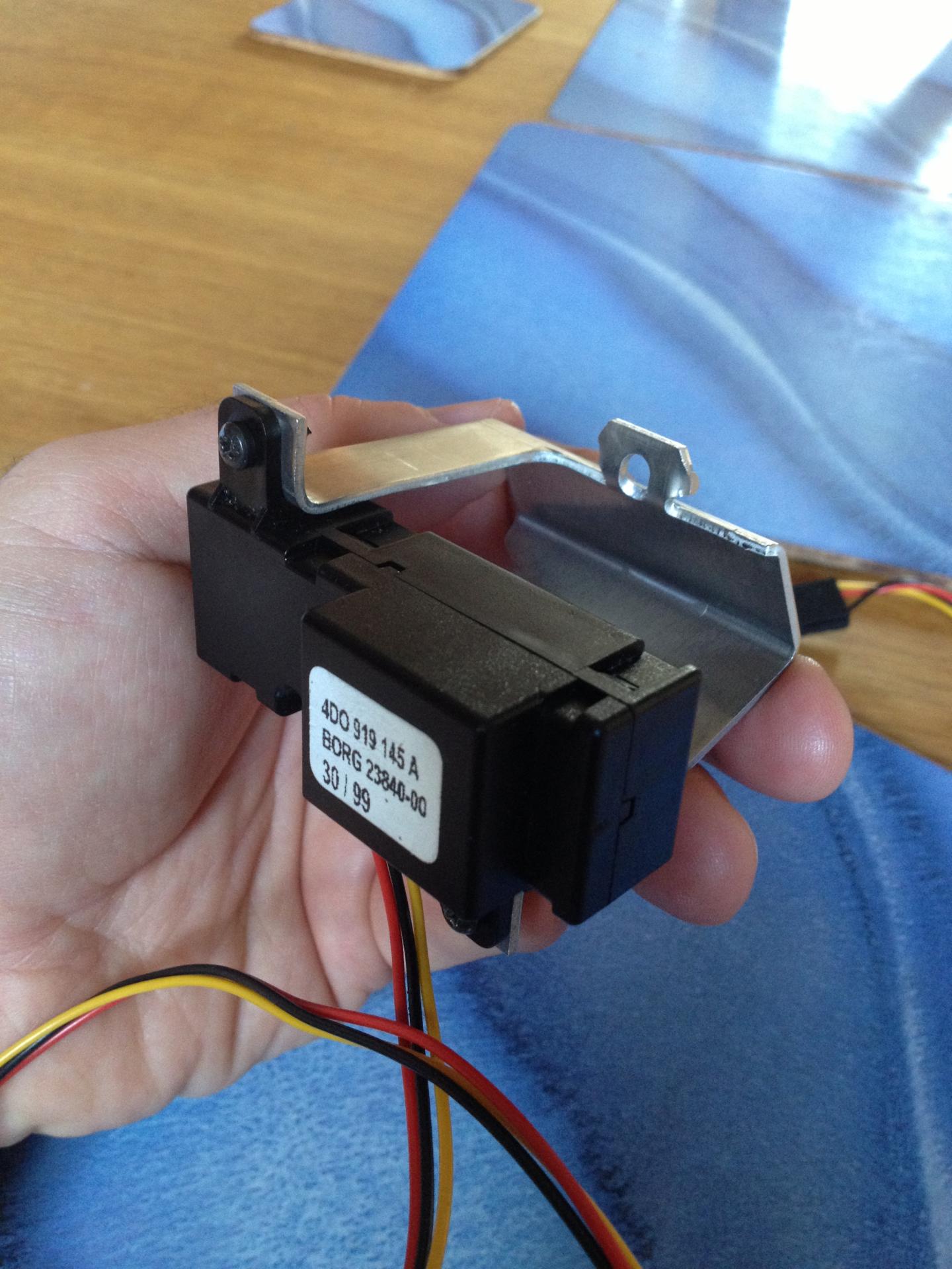

Adrian E 11th September 2013 01:18 PM
1 Attachment(s)
Well my module arrived courtesy of our sponsors today :)
http://forum.a8parts.co.uk/attachmen...1&d=1378905389
Foam stuff has fallen to pieces - anything equivalent available does anyone know?
Bracket on order so will have to wait for a while :)
notorious 11th September 2013 01:30 PM
Any foam stuff used for packaging wrapped with Certoplast will be OK.
Remove knee panel and stick it to instruments panel.
Put module into driver's door pocket and wait for signal.
Then you'll decide where to attach it permanently.
You can drive for a couple of weeks without knee panel...

3 Attachment(s)
I'd already ordered the bracket before we discussed that option - got the bracket now, which I was expecting to be plastic, but turns out to be metal.
Pics below:
http://forum.a8parts.co.uk/attachmen...1&d=1379325673
Grand total of £3.73 for bracket and screws
Installing on that bracket in middle of dash can be a bit of nightmare.

What's the difference between these 2 units? There are a few without the 'A' suffix on ebay.de, but not with the 'A' suffix
Adrian E 19th September 2013 01:35 PM
Possibly a change in the cluster design? Will have a look at the non-A versions and see if I can see a physical difference.
Have you tried A8parts as that's where mine came from and they may have others from left hookers they've broken?
The_Laird 19th September 2013 01:44 PM
Yes, I tried A8 Parts but yours was the last one
HPsauce 19th September 2013 02:02 PM
I got mine off eBay from Germany, arrived earlier this week. €40 including P&P.
Same as Adrian's (an A version) with a slightly later manufacturing date of 35/00.
Won't be fitting it for a while, but will probably take the instruments out to do it and decide on location at the time.
Adrian E 19th September 2013 02:23 PM
I can't see any physical difference in the module or connector, so it's probably just a revised part number, a bit like the TV module boxes where anything will pretty much work.
Some appear to have chopped the connectors off, which is genius.....
