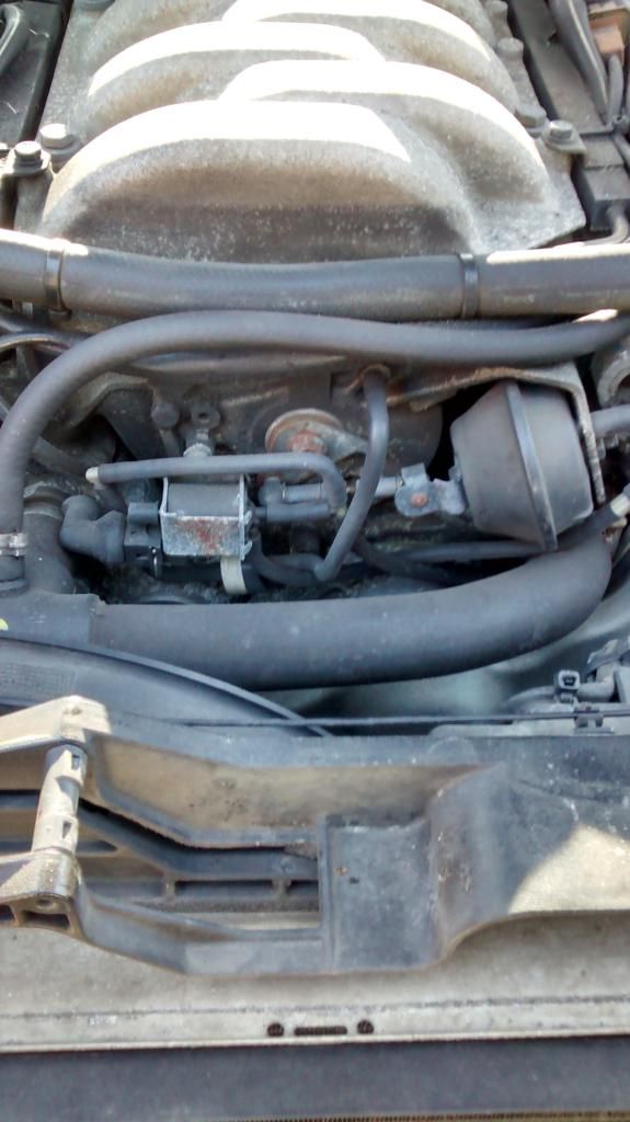

Hi all. Just had a chance to have a look and my engine seems different to the ones posted earlier.
Only one actuator. Here is a quick video if it. I presume it's working ok?

HPsauce 20th June 2014 05:14 PM
Originally Posted by fletberbill (Post 76891)
Only one actuator.
Are you 100% sure; can you show a bit more of the front of the engine in a photo or video?

fletberbill 20th June 2014 05:20 PM
Only picture I took.
http://i910.photobucket.com/albums/a...525679_HDR.jpg
ainarssems 20th June 2014 07:27 PM
That's PF 32V car, 1999 registration was what through us off. Must be late 1998 car that was registered in 1999 so 1 actuator is correct. Flaps usually don't stick on 32v and does not brake links. So the fault must be somewhere else.
