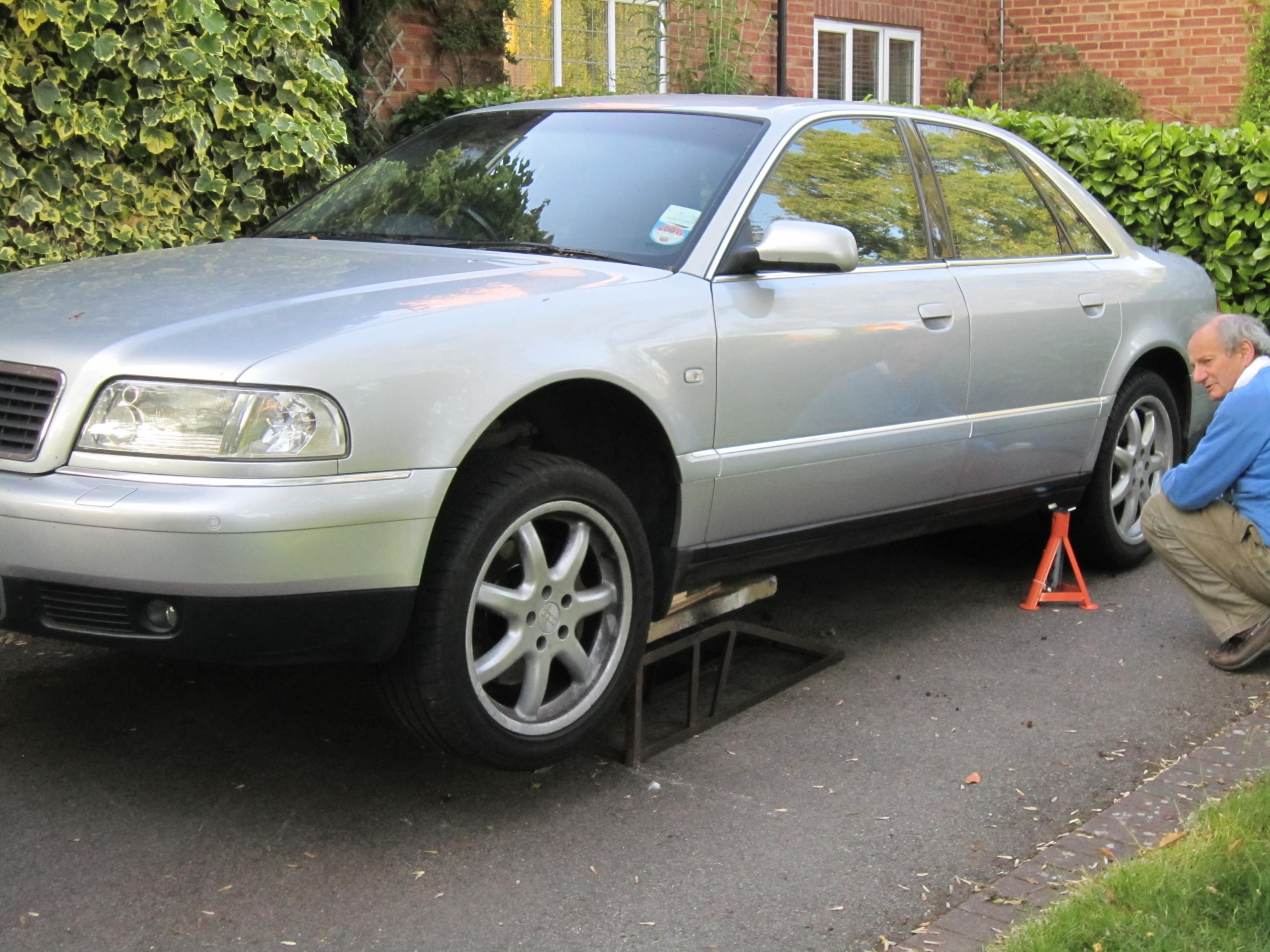

sarg 15th August 2014 05:03 PM
1 Attachment(s)
I don't recall how I got to this point, but it can definitely be done :)
Attachment 8762
