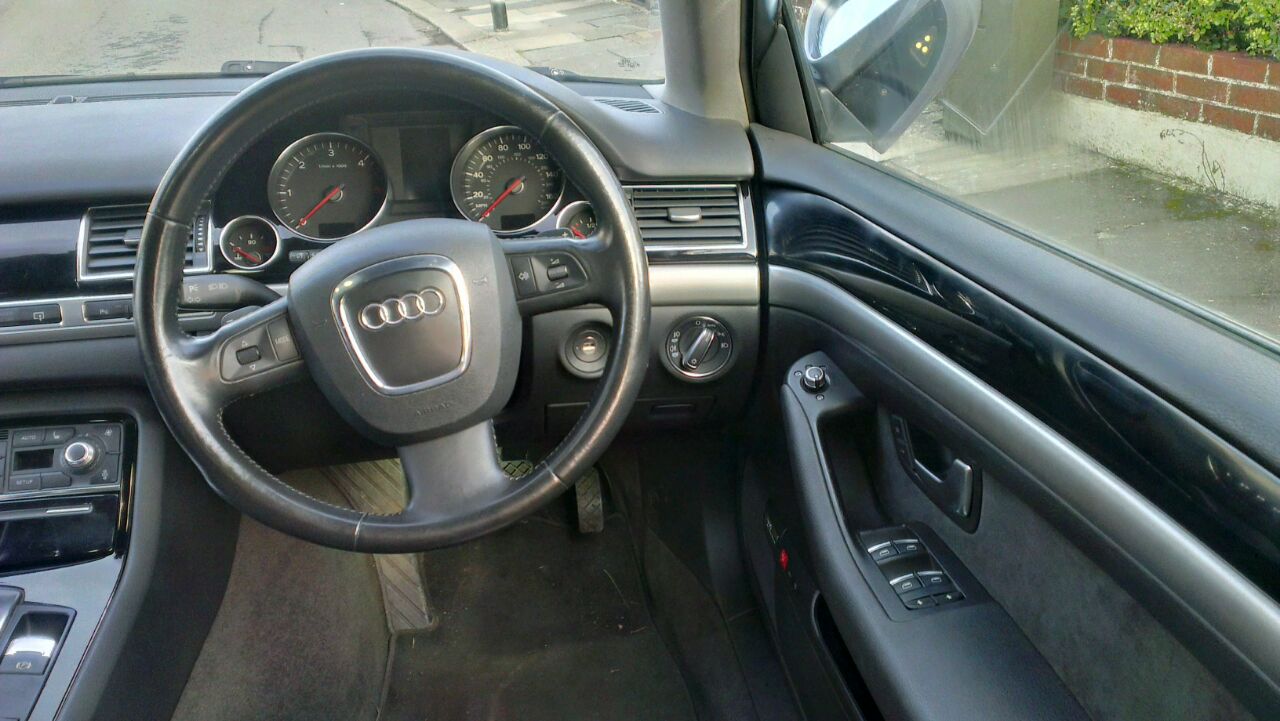

As you may have noticed me and Scott want MORE chrome inside the cabin, BUT not too much, not more than what's OEM, but with few touches of our own ideas.
So far we both added a chrome light switch, plus I swapped my steering wheel buttons to ones with chrome surrounding...and this is just the beginning :D
On Tuesday morning I got a text from Scott (who clearly was bored at work and more focused on chrome upgrades than the actual work :p) to check a chrome window switch online.

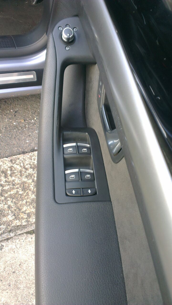

And here it is, maybe not so impressive as the master switch, but when they all are changed it will add nice feel to the cabin.
Illumination works exactly as the original switch and it has exactly same colour.

So, today I managed to fit rest of the switches and oh boy, they look sooooo good. One of the best mods for the interior, no doubts.
One thing different in operation is the mirror switch, it is way much smoother.

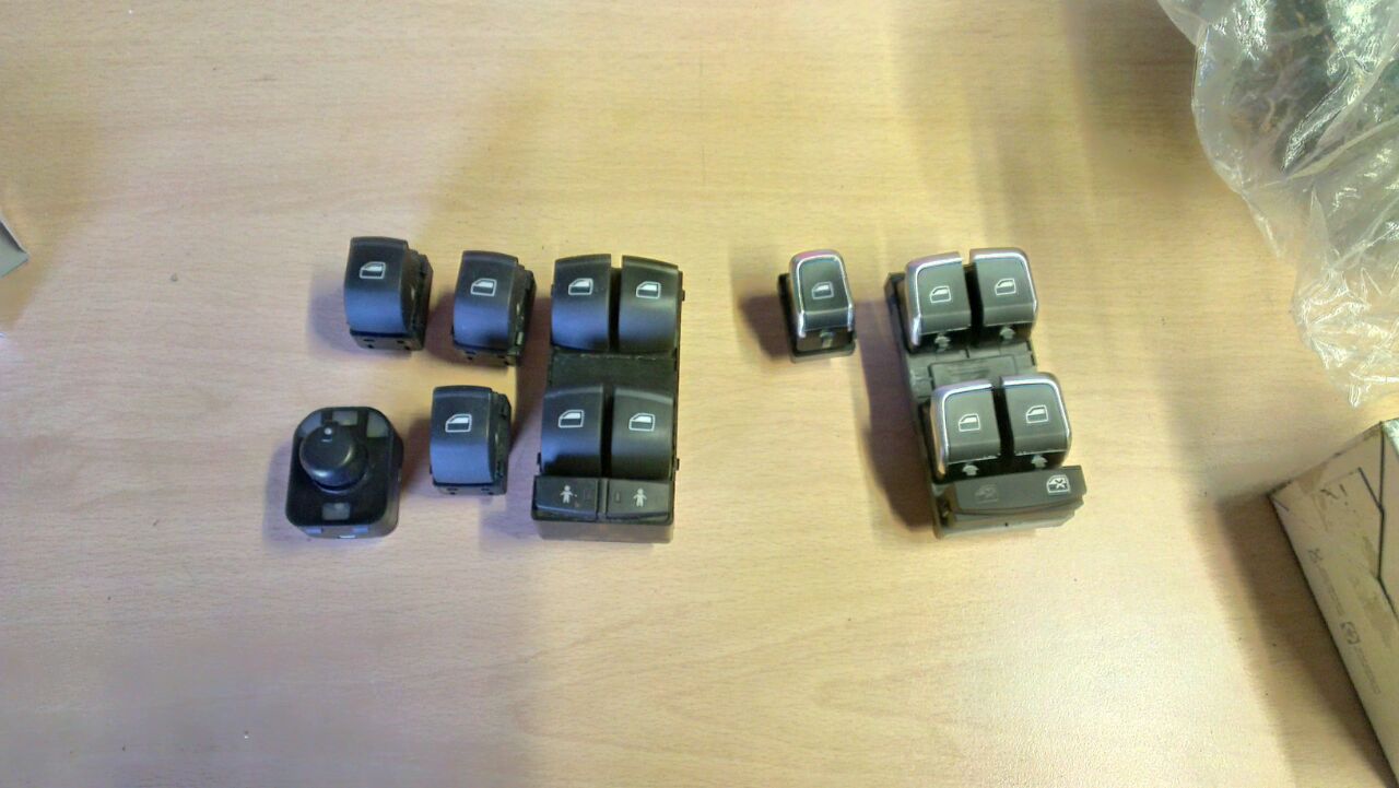

The A6 switch turned up today.
It looks identical to the 8P unit but with the different chrome and dead lock buttons.
Under the caps is identical as well.
Stripped the door card down again, removed the master switch and swapped the caps over.
http://forum.a8parts.co.uk/attachmen...8&d=1413317870
The A6 dead lock buttons are slightly different shape but they look fine and works.
http://forum.a8parts.co.uk/attachmen...9&d=1413317870
I think thats the switches completed.
I now got all these switches left over.
http://forum.a8parts.co.uk/attachmen...0&d=1413317870
M-A8 15th October 2014 06:37 AM
So, to close this thread here is the solution for anyone having individual child locks on the master switch.
You will need a Master Switch PN: 4G0 959 851 instead of PN: 4F0 959 851 H
http://i.ebayimg.com/00/s/NzY4WDEwMj...0Fg~~48_72.JPG
...and do what Scott did (as above), swap the window switches caps
That's it !!!
Mod COMPLETED
:mexicanwave:

Let me bring back this fantastic thread to update the information.
Following the very clear explanations of @ScottD3 and @M-A8, i've found a more direct solution for the master switch.
In fact, the reference 4F0959851J is exactly the same than the one that Scott has in his A8, with the difference that with this reference, the dead lock buttons are exactly the same than the original ones and there's no need to swap the caps with the 8P master switch. This reference corresponds to the Audi Q7s from 2010 to 2015.
Here is a picture of the mentioned part
http://autosot.ru/assets/images/parts2/IMG_1518.JPG
Thanks a lot to the gurus of the forum that help to the less experimented, like me, to improve our cars.
Cheers from Spain
