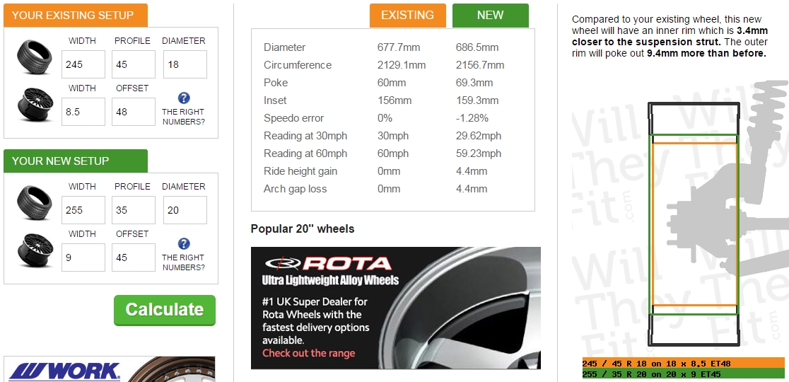

ainarssems 28th March 2015 12:38 PM
1 Attachment(s)
First you need to remember that speedo most likely over-reads with stock tyres, in my expierence when speedo says 80 actual speed is 72-75. So compare speed that speedo shows you to the GPS speed to determine how big the difference is, then you can see use this site to see how much will the reading change and also see how the clearances change. http://www.willtheyfit.com/
http://forum.a8parts.co.uk/attachmen...1&d=1427549394
Ricky22buk 28th March 2015 02:19 PM
Very useful website ainarssems !!!!
Thank you !!!
Looks like the 255's are closer to the right speedo readings than the 275's !!!
