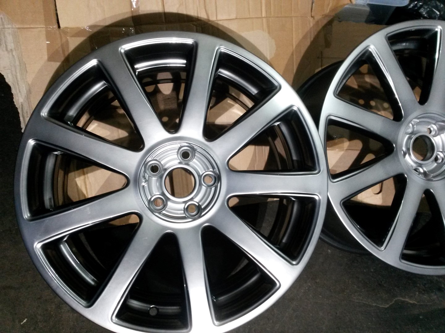

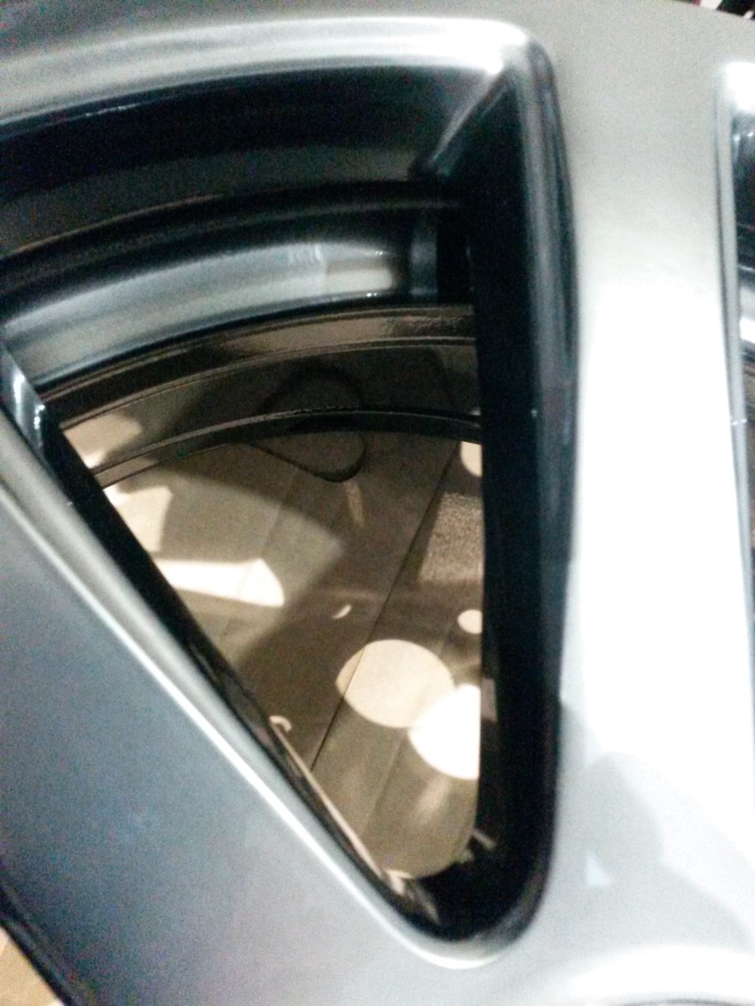

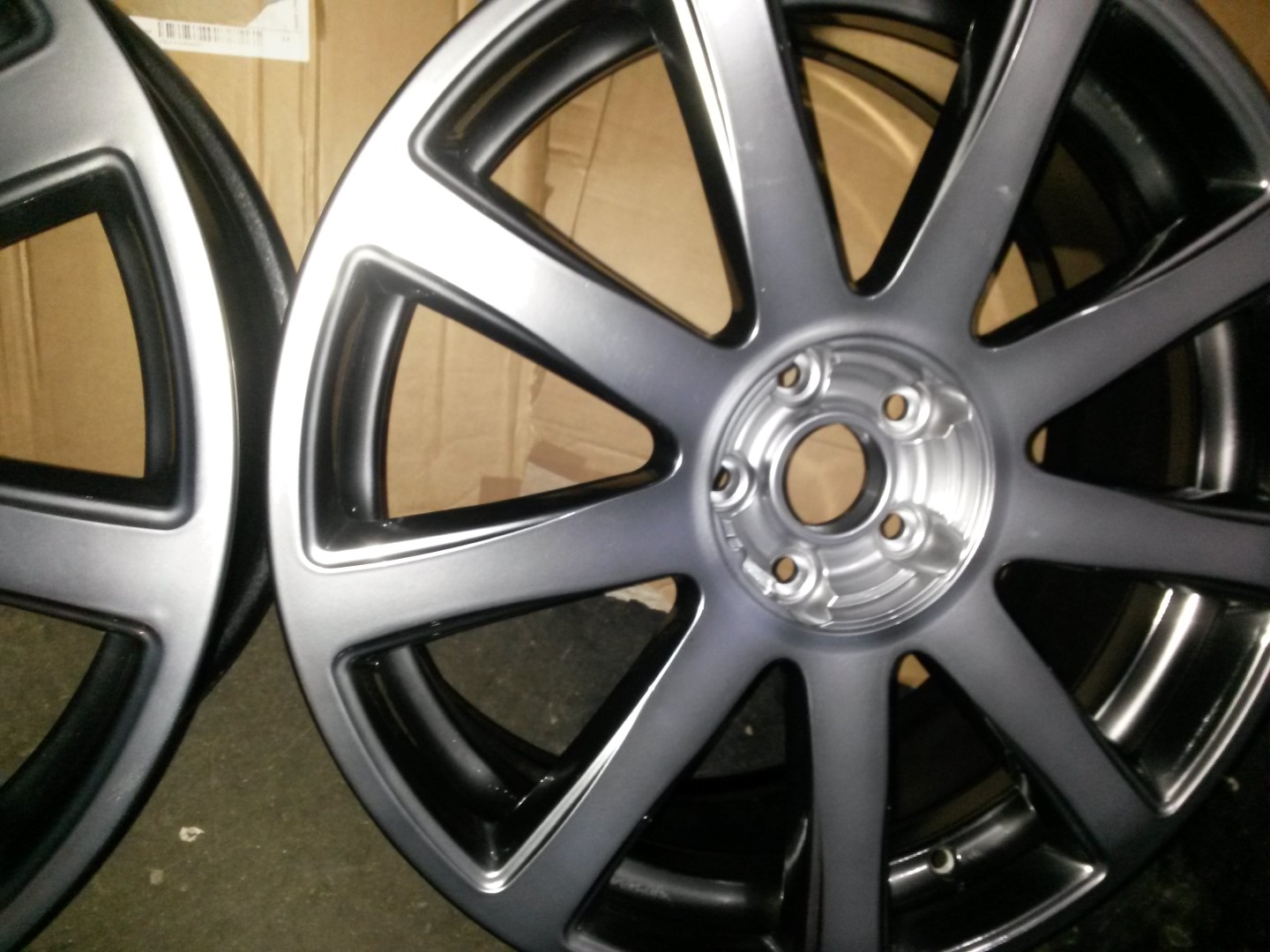

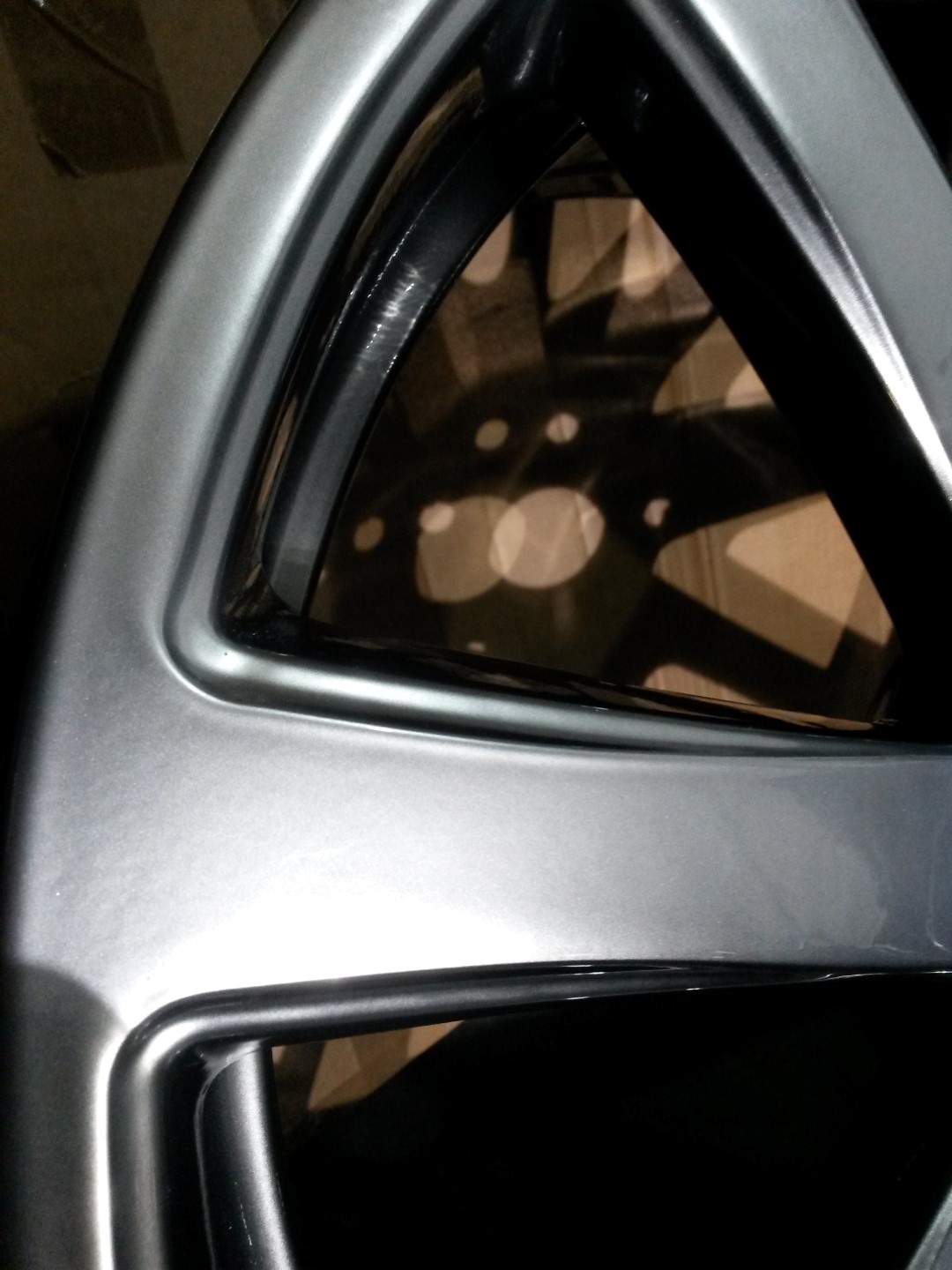

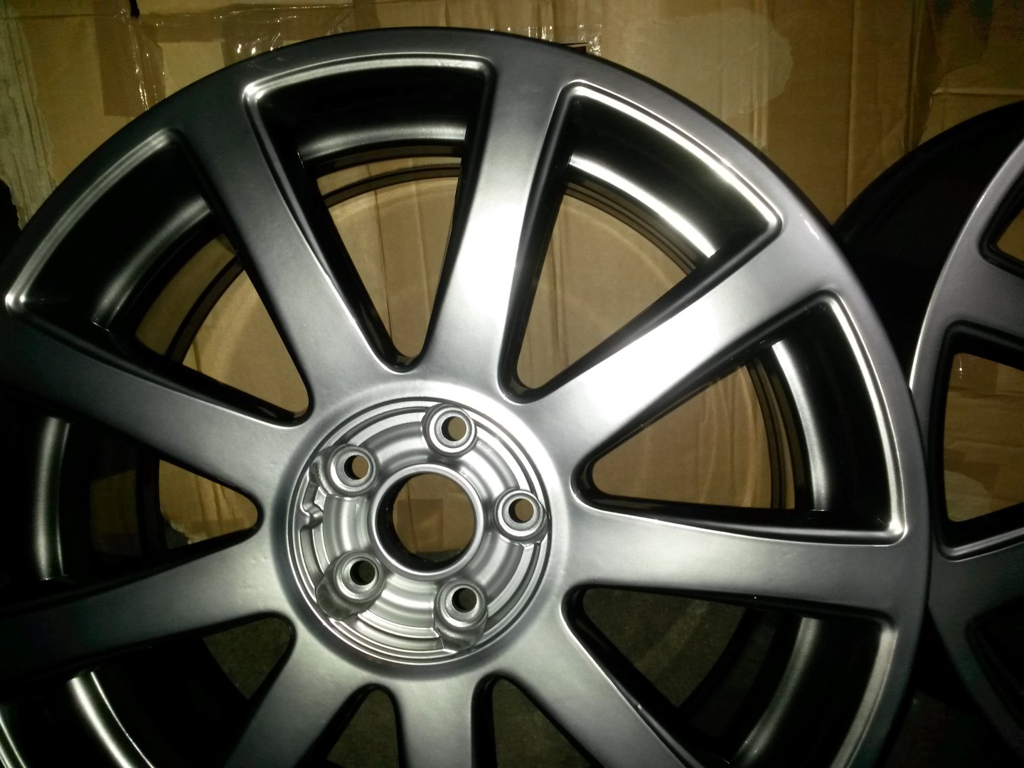

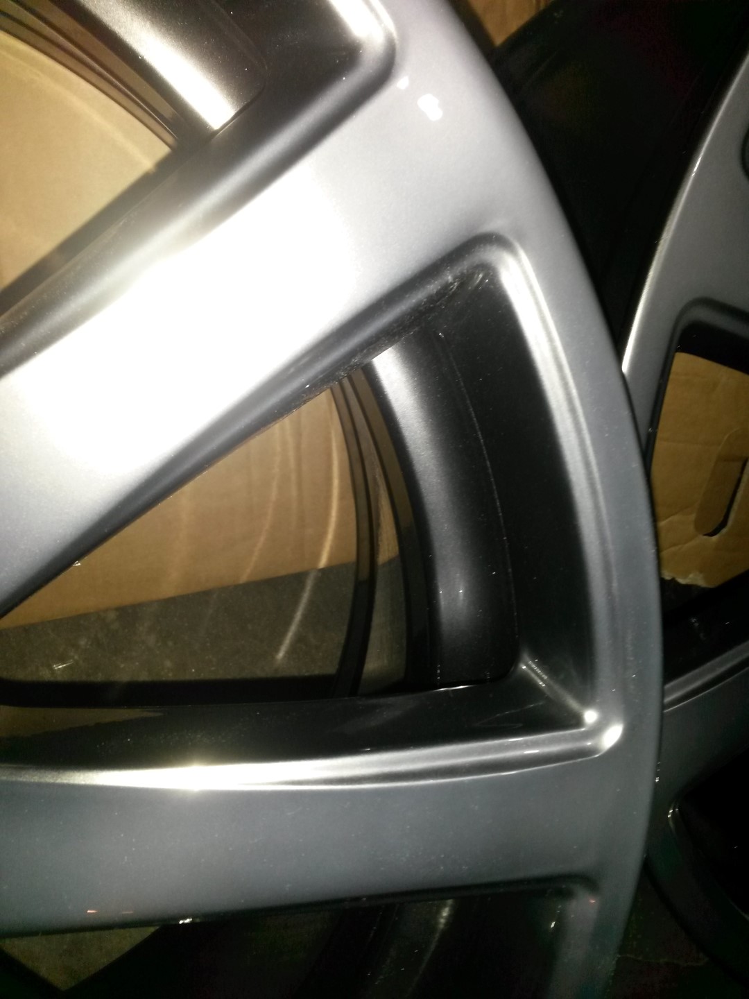

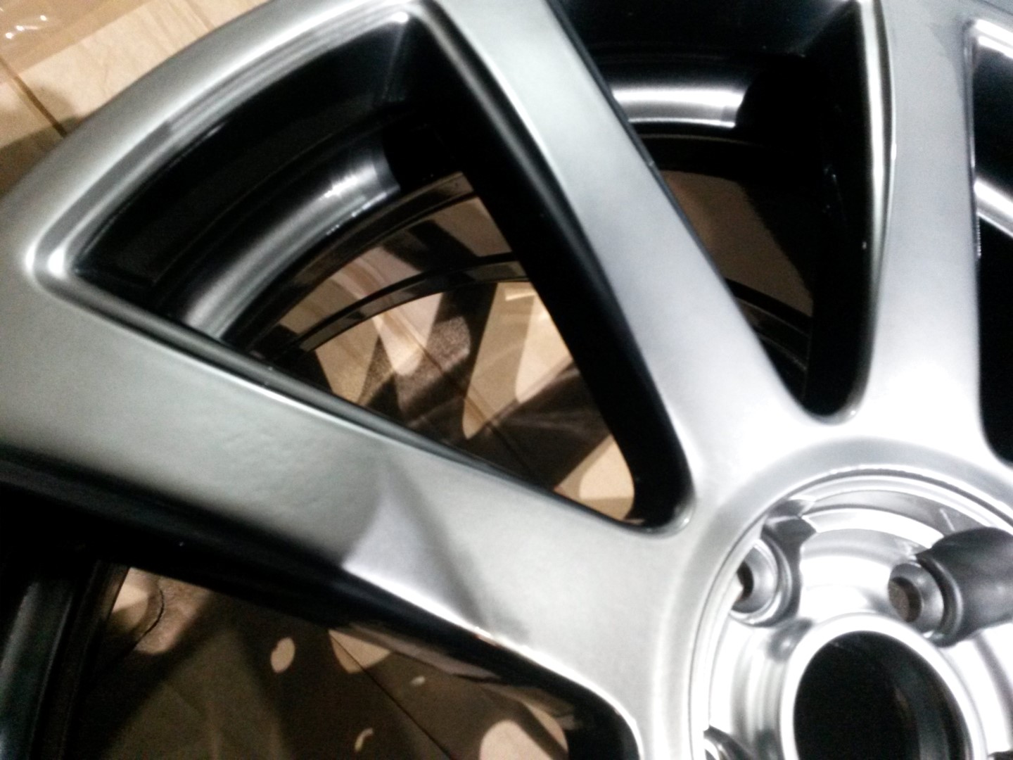

Just got my spare set of FE wheels back from the refurbishers (AWR in Bury).
I thought I'd try something a little different this time. Since these are going to be my winter wheels, I decided to go a little darker -- nothing too dark, just something that would show the road salt and dirt less.
I asked for something like a light pewter/anthracite and, preferably, black on the inside, if possible. They weren't too sure if they could do it, so I think this was somewhat experimental, but I'm really pleased with the result.
The photos don't really do them justice -- in the right light they have a black/silver lead-like appearance that I think works well ...
Attachment 12079 Attachment 12080 Attachment 12081 Attachment 12082 Attachment 12083 Attachment 12084 Attachment 12085
What y'all think?
And, what would be a good winter tyre to put on these (standard 255/35 R20 FE) wheels? :)

I think they look excellent! +++
Always liked a darker wheel :D

Really like them a lot!

Nice shade of grey ;). I'm also an 18" Winters man, as 20" winter tyres are too pricey for me for 4 months use. Are you looking at new or part-worn? If the latter, it's worth giving DM Tyres a call, though it's unlikely they'd have a matching set at this stage.

Nice wheels! Like the colour combination.

think they look stunning, I did think about doing mine similar to that a while back and used the car my plate came from as an example, however I dont think my all black set up would have looked as good:D

Those do look nice! I was considering something similar myself originally but the only way to achieve such a sharp black/silver contrast, it seems, is to have them diamond cut, which of course isn't a very durable finish and probably not the best choice for winter use.
These were instead done by powder coating the entire wheel in black first, then applying a layer of silver powder coat to the front only, without masking off the rest of the wheel. I was worried it would look dreadful, but I'm surprised how well it worked. It's not easy to see in the photos (I'll see if I can take some better ones later) but the result is softer blend of black and silver that gives a slight pewter effect.
