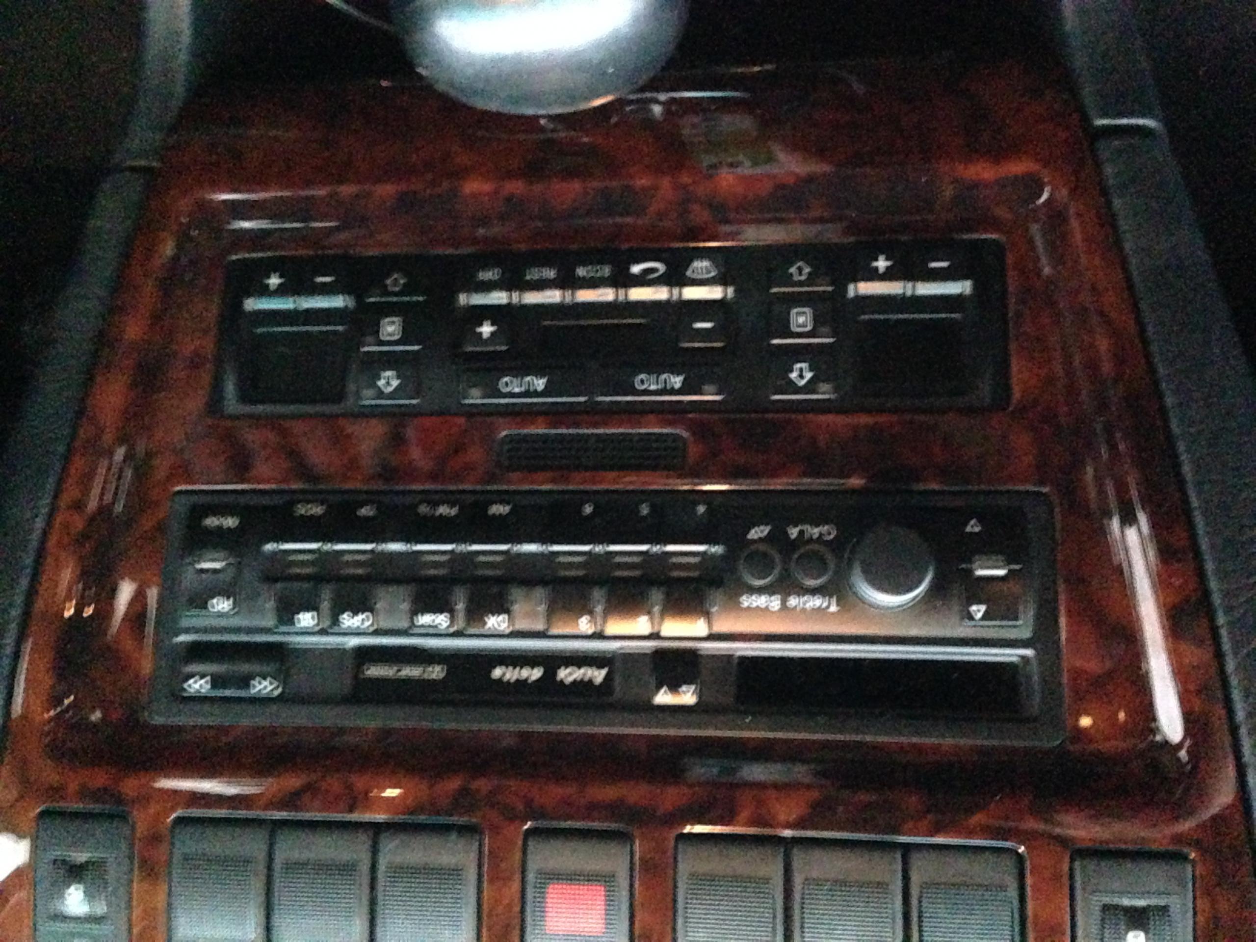

Hi all. I'm trying to work out which cable I need to connect my phone (for music), to my stereo.
It's a lot of stripping to just see a connection, and the car is my daily so just asking, should anyone know so I can just order the part and do it all at once... A pic of my radio is below. Any help appreciated! |
I think you will need 1 of these: http://www.ebay.co.uk/itm/Aux-Line-i...QAAOSwF1dUR1OF
The radio should just pull out if you have the correct removal tools.
There will be a big 3-part (red/yellow/blue) connector on the back (among other connections). The blue is the CD part, you just slide the 3 parts apart and replace the blue block. Then reconnect - test before reinstalling the radio. Sometimes the connector is a single block on the loom and you have to acquire a short adapter lead. This has the big socket on one end and the 3-way splittable block on the other. |
So the radio pulls out? I don't have to pull the trim apart? That's a big help. These removal tools, Audi specific or normal stereo removal things?
Thanks for the help lads, just so paranoid about ruining the trim. |
Same seller I've used for quite a few bits and bobs.
Just check you have the four thin horizontal slots (but you will, or maybe just two). IIRC they feed in flat side out, see: https://www.youtube.com/watch?v=mSe7CnLmD58 |

I got the removal tools today but cannot see any place to insert them. Even around the stereo and trim is very very tight together so can't insert without damaging the trim. Any ideas? Thanks |
