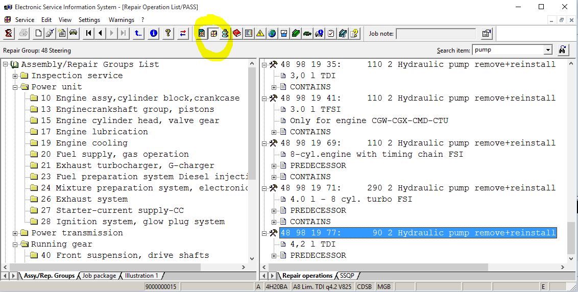

Where do you find the time units Ainars?
ainarssems 20th April 2016 07:11 PM
1 Attachment(s)
Press the button in yellow circle
http://forum.a8parts.co.uk/attachmen...1&d=1461179230
Delboy 20th April 2016 08:42 PM
Quite sure that button doesn't work on my install and needs vin look up
ainarssems 20th April 2016 09:08 PM
If the 'OK' button is greyed out, enter the VIN, press 'Start Enquiry' It will open new window with error, just close it and it will let you press OK then and proceed.
