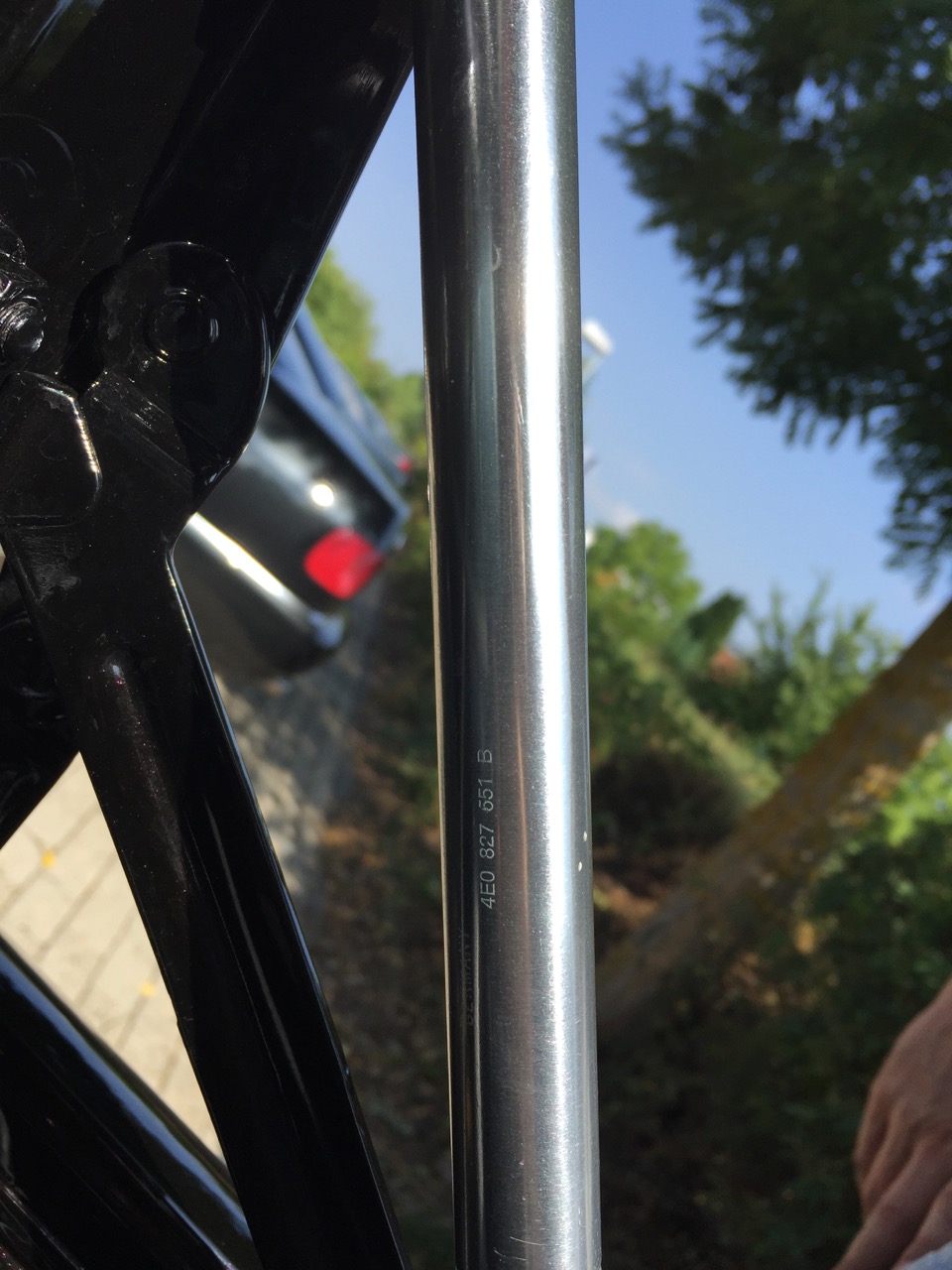

Very interested in this.
I saw D2 on German meet 2015 with chrome D3 boot struts.
Want to install them on my car too.
The boot opens nicely in terms of weight balance and fully, so struts are are correct length.
Unfortunately I took only one picture, but I captured part numbers.
4E0 827 552 C 01S -- left side
4E0 827 551 B -- right side
Also saw another D2 car with boot strut part number 4E0 827 551 C 01S on right side. Left side was unmarked.
D3 cars have different left and right side struts due to motorised boot lid with motor located only on one side, so they need to be of a bit different stiffness.
It looks like the owner of that D2 purchased a full set from donor D3 without realising they are a bit different. But it was not noticeable when boot is opened.
I have mobile phone number of the owner and I can ask him additional questions.
I'll be also interested to know what part numbers did NOT work on D2.
Couple of years ago I ordered new chrome D3 boot struts from Audi, but they were superseded with normal black struts that turned up,
so I returned them for a refund as soon as I saw them. Unfortunately, I don't remember exact part number that I ordered.
http://forum.a8parts.co.uk/attachmen...1&d=1479410822
