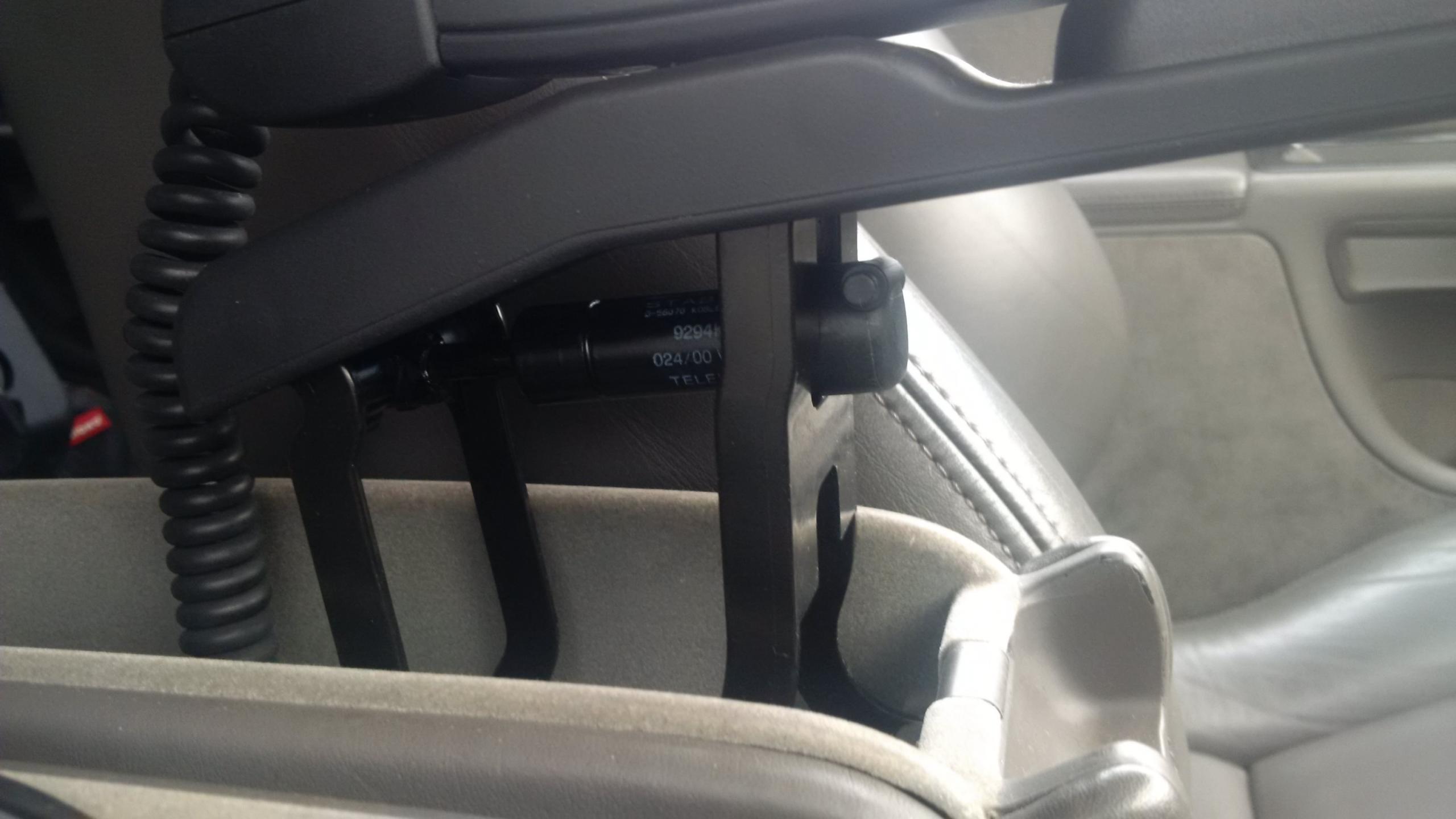

I have the same thing on mine. It looks like if you turn it 90 degrees it fits through a slot in the arm, then turn it back and the little lugs hold it there sliding up and down as the cradle is released (I hope that's fairly clear, I'll try a couple of photos later). The only thing is that the damper is worn out and doesn't work anymore.
pete-p 8th June 2016 07:15 AM
2 Attachment(s)

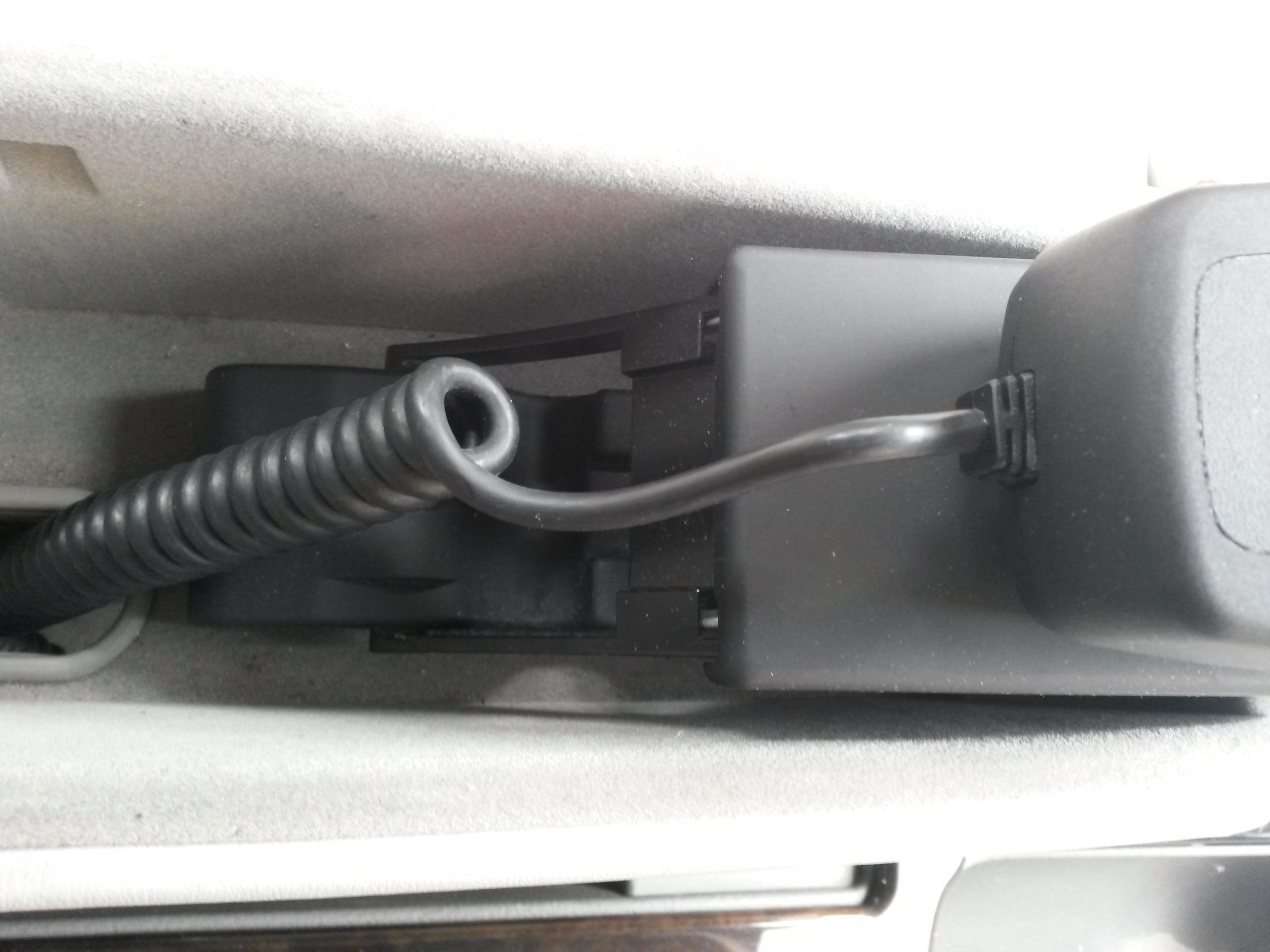

It's only how I see it and may be wrong!
Attachment 13602
Attachment 13603

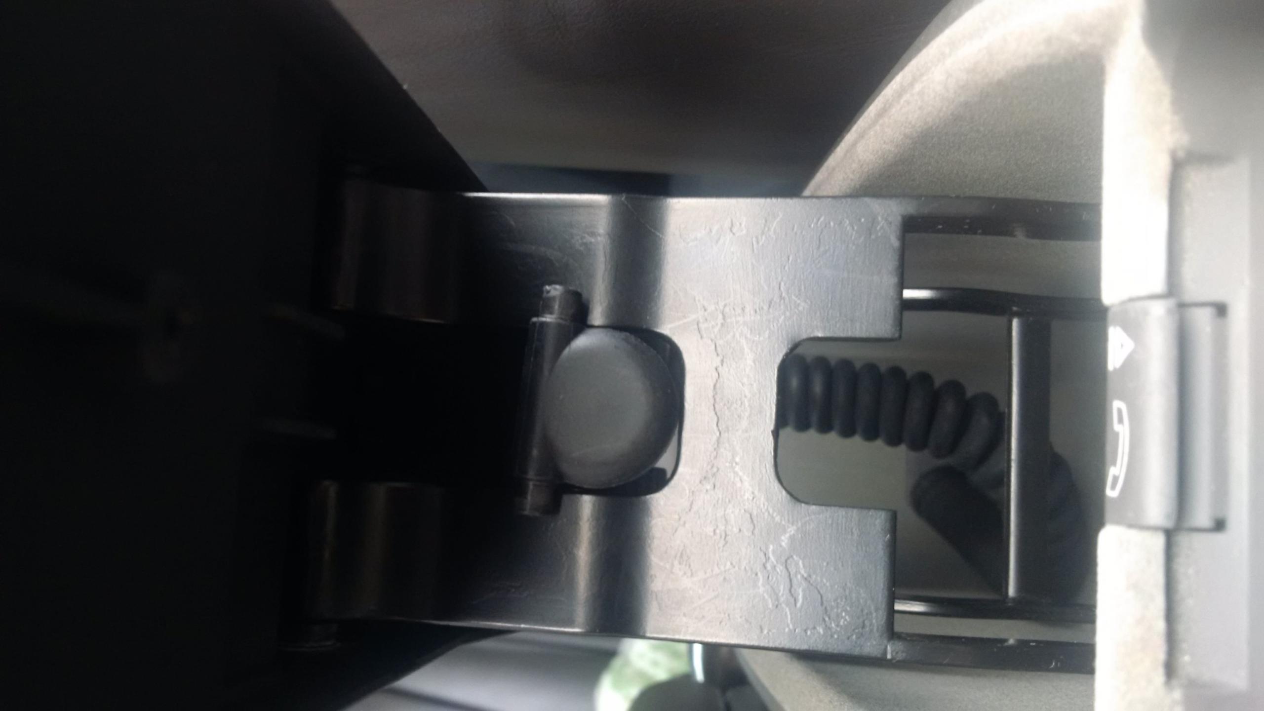

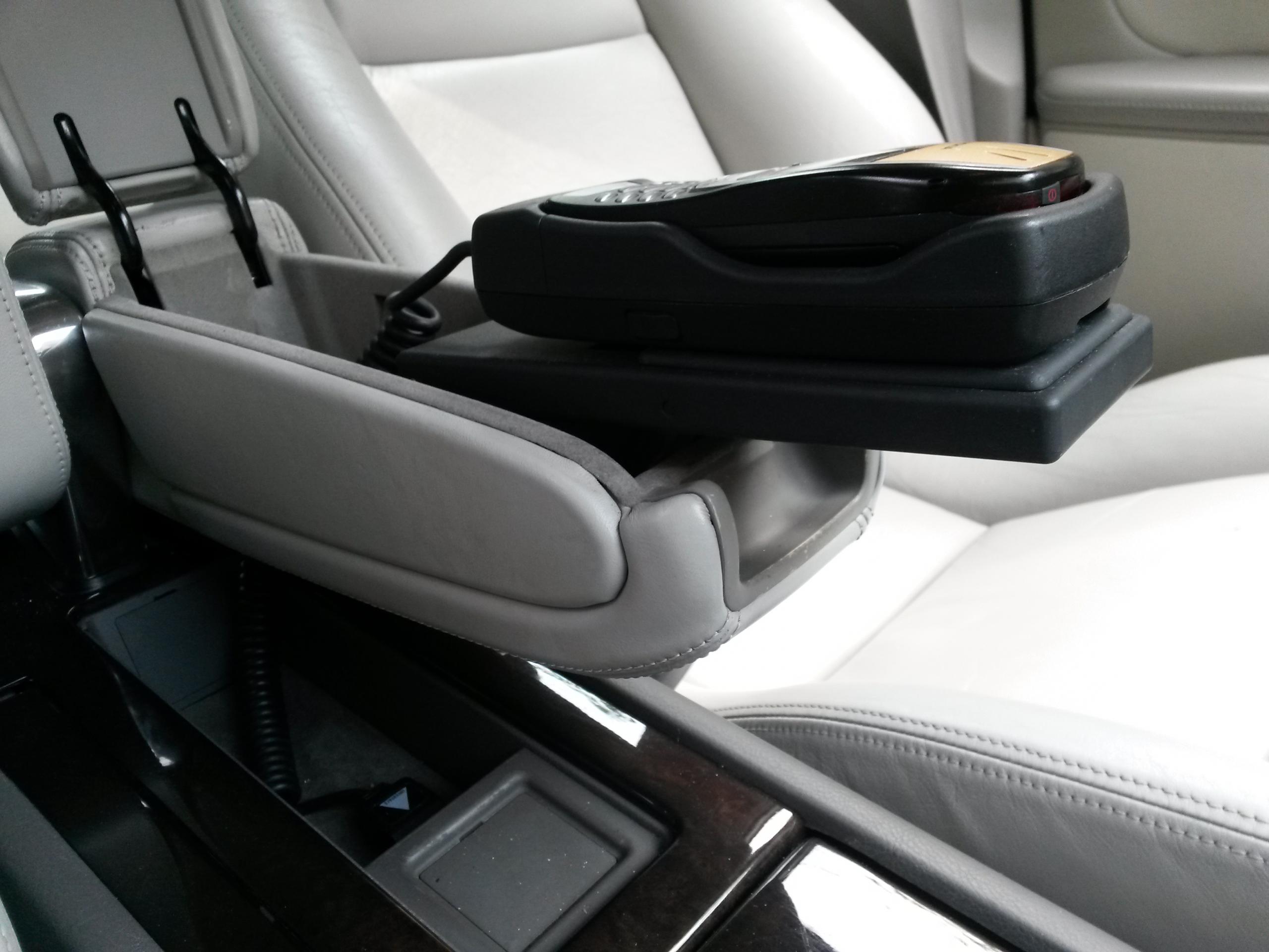

moltuae 8th June 2016 11:18 AM
4 Attachment(s)
Originally Posted by pete-p (Post 113371)
mine is an early 2000 facelift with the nokia 3110 phone. Does the cradle on yours lift out or is it fixed? When i was looking for the phone i noticed there were several options, one being a more generic phone cradle.
Mine has a fixed mechanism but a removable top plate and a clip-on, interchangeable Cullman phone cradle. From memory, I think the car had a 3110 Cullman cradle in it when I bought it (which I should still have somewhere) but I swapped it for my present Cullman 6310/6310i cradle.
This is how it looks ....
Attachment 13604 Attachment 13605 Attachment 13606 Attachment 13607
You can see some more of the mechanism here in the photos I took a while ago when I had to repair it:
http://forum.a8parts.co.uk/showthread.php?t=10333
