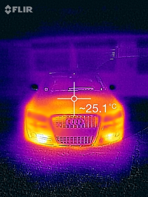

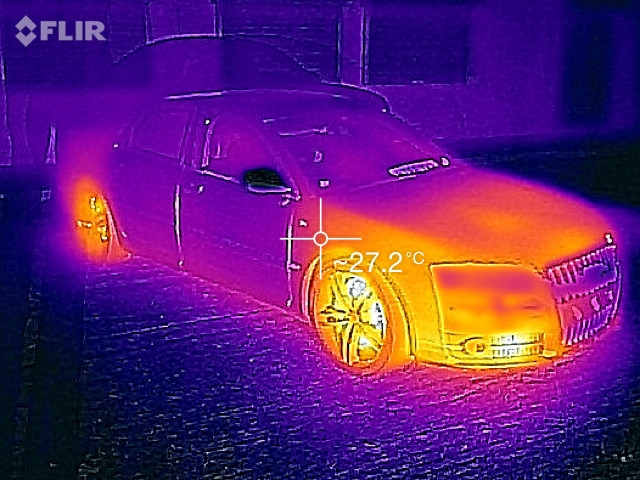

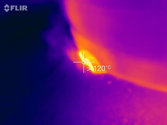

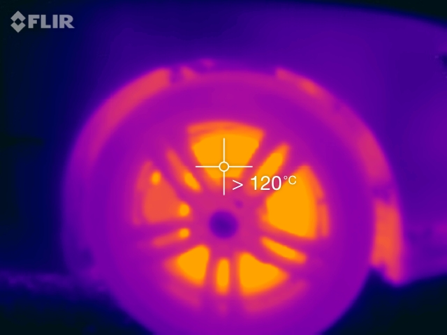

M-A8 17th November 2016 08:30 PM
6 Attachment(s)
Here she is after a visit to her identical sister.
They both had a goooood run +++
