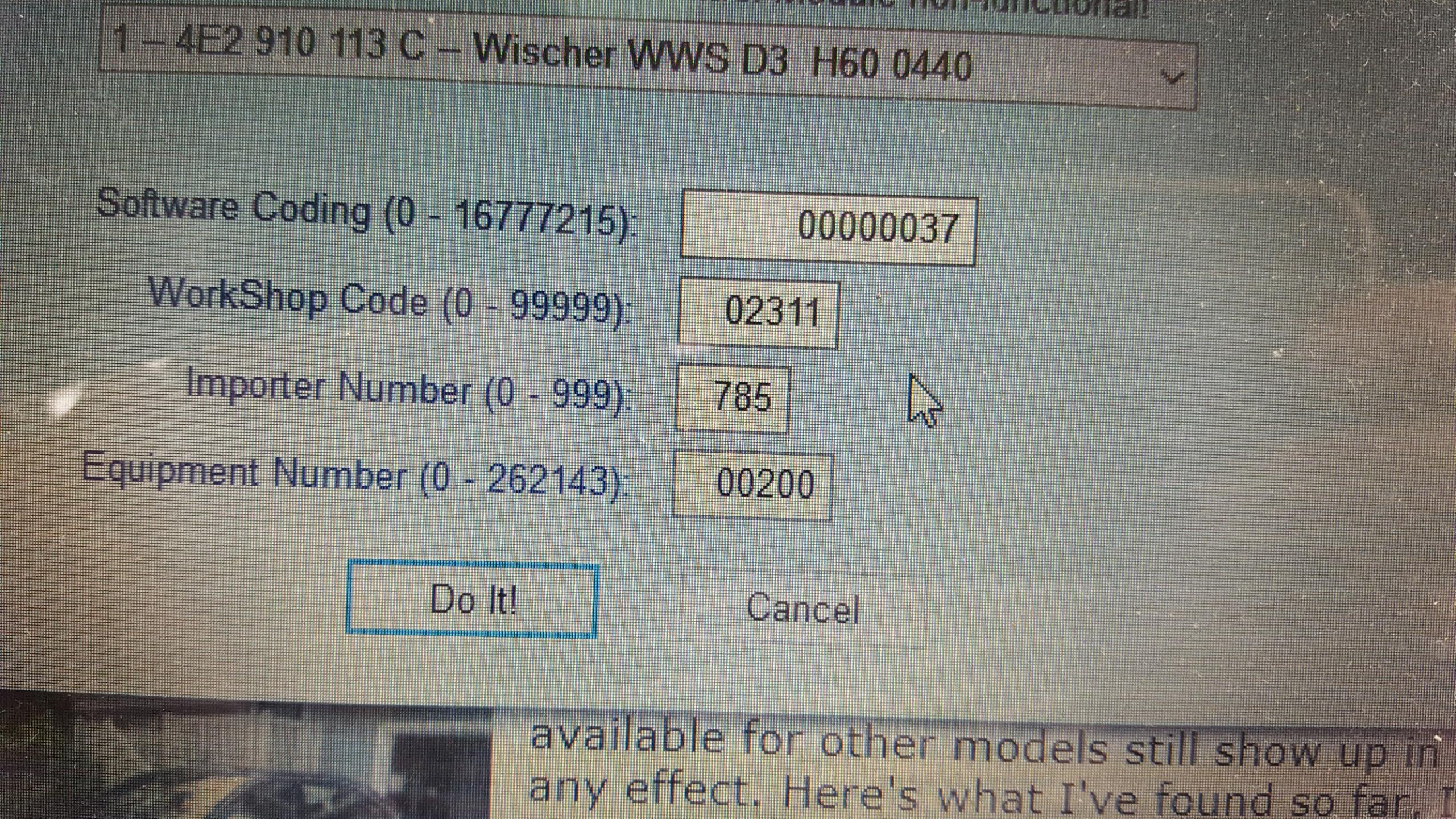

Hi I had a problem on my d3 the wiper motor has packed in the letter at the end of mine was B and then I have changed it to another this one has the letter C at the end and now I have lost the after wipe fuction when you use the washers when the headlights are on it used to do a final sweep to clean the windscreen after the headlights where washed,so is there coding or settings in the mmi to bring that function back.

If you have VCDS should be easy:
Module 09
Long coding -> Function 07
In the drop-down select: x - 8K1 955 119 - WWS xxxx
Byte 1
Enable bit 3

Hi I had a look and the wiper part no. 8K1 955 119 is not there when you pull down function 7.

carmel120 17th April 2017 10:37 AM
2 Attachment(s)
Attachment 15929
Attachment 15930
