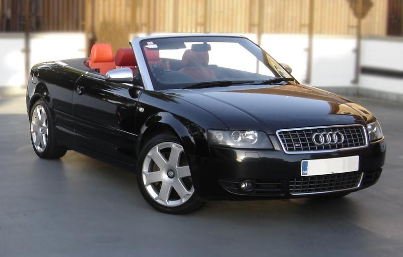

Mine looks like this, when it is clean, which isn't often enough!
